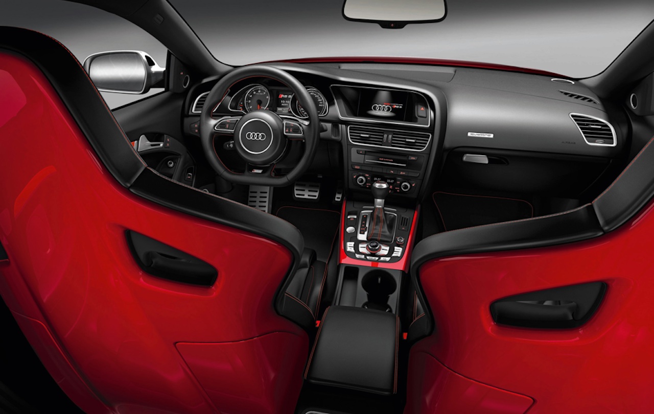

Hi Dhali...yep red in the rear too. I had them rewebbed by Airbag team in Hinkley Leicester. Charged me £120 for all 5 belts. Bit of a bitch to get the rears out though especially the one centre one in the rear seat, my hand has only just returned to normal from the angles I had to inflict upon it to get it in and out!
Next Job is to get the seat backs done red and the door cards in Alcantara with Red stitching and perhaps the dash top!

Thanks. Those setbacks will look great .

You wrapping or painting the seat backs? Ive done both so far.

Hi Mike...lets put it this way I bought some wrap had a go and I now understand why my good lady does the Christmas presents! So I've decided to get them professionally painted, just not sure whether to go matt or gloss finish?
You wrapping looked a lot better than mine, your white seats look quality.
