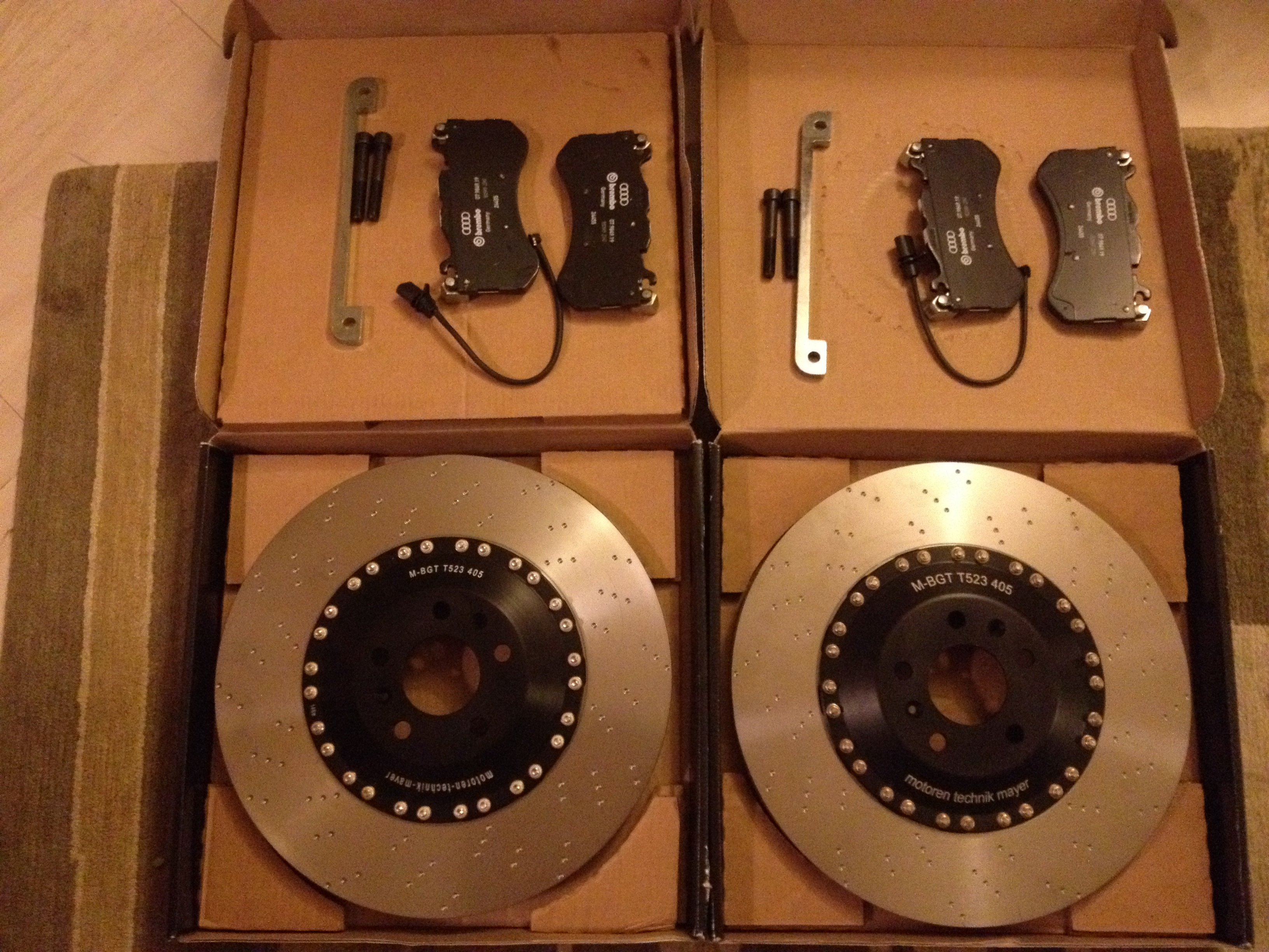

The AP brake set up has good reviews.
I run the mtm - performance friction 405 mm front rotors
http://www.mtm-online.de/en/Audi/RS6-C6 ... s6bre405vk
not cheap , but great stopping power from 315 km/hr (196 mph) and numerous air strip 0-1000 metre runs to 260km/h (161 mph)
Easy install.

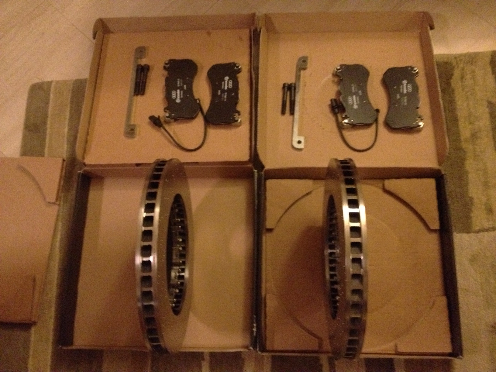

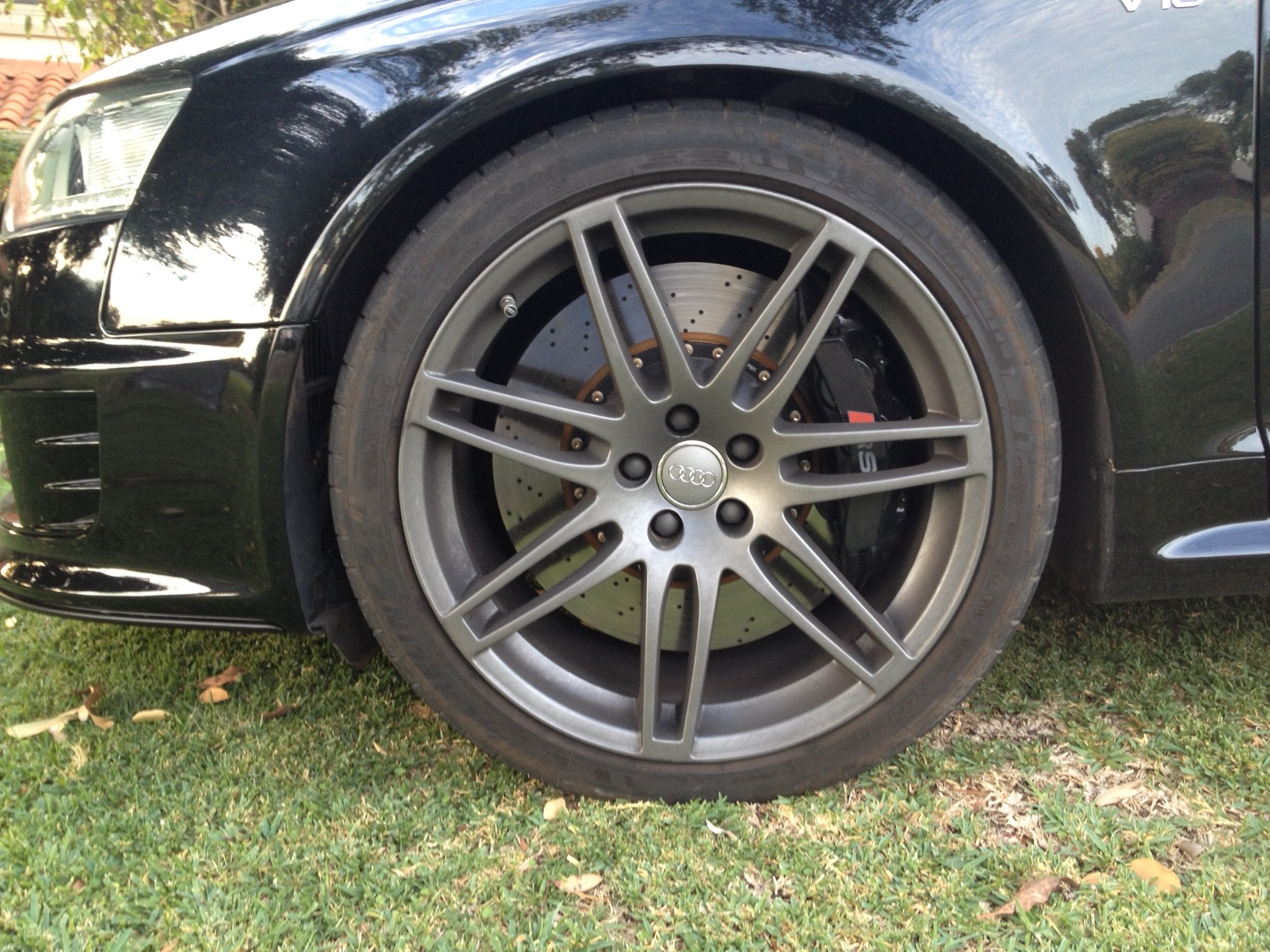

Re: new rs6 owner brake disc and a few general questions
Hi rs6_sid,rs6_sid wrote:are they just a larger rotor or do you need a spacer for the calliper as well ?
Of course you can't beat the ceramics, but much more expensive and can have costly maintenance.
With regards to the MTM kit, yes you do need spacers. Provided in the kit as per attached images.
Easy install by my local indie Audi service centre.
