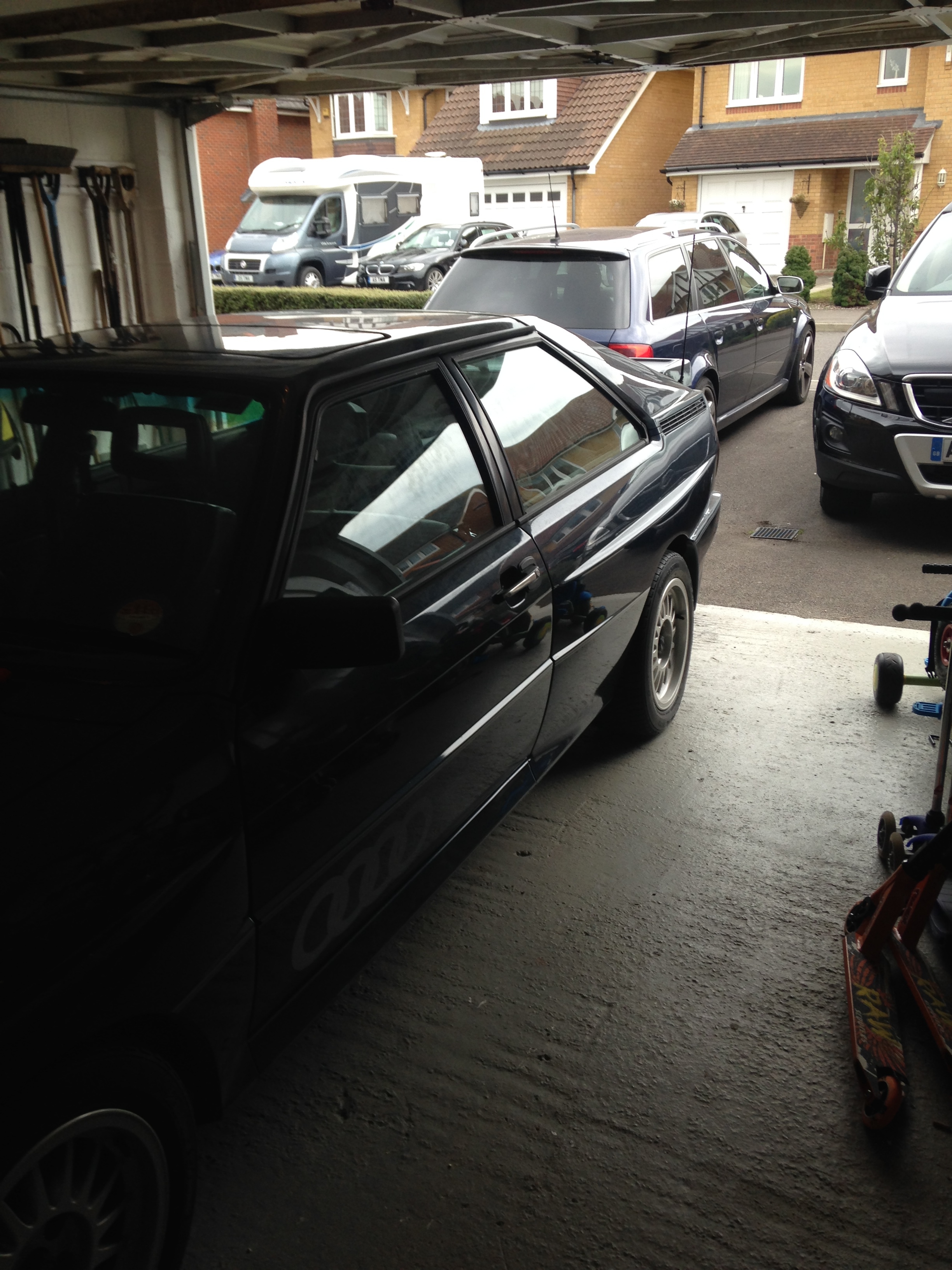

a few pics, i'll take some better ones when i get the chance.
I've had it since 2004, in that time it's done less than 10 thousand miles. It just comes out now for an mot every year then back into hiding.

Pure sex.
Re: Power steering pump issue?
No accident that the images are mostly from behind
