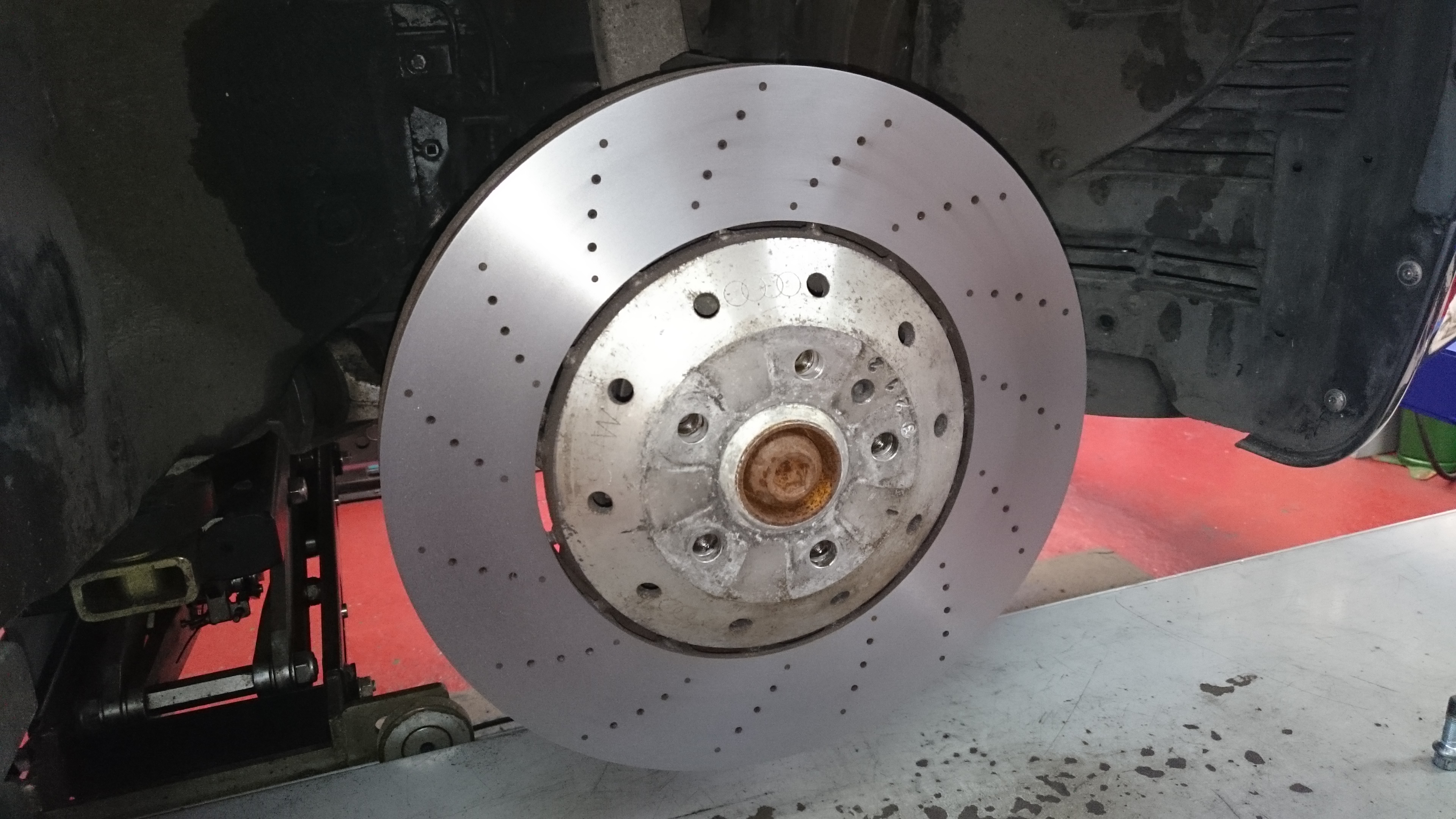

Skimmed with a pro cut lathe.

Looks pretty ... initial results? My rear discs could do with sprucing up so if your results are good I will follow suit...

Spurtle, I did mine recently, it takes a few hundred miles to wear the disc smooth (ie wear off the lathe marks), the brakes felt good during this period, but after that and giving it a really good b road thrashing to bed the pads in they were silky smooth at any speed. I'd definitely recommend it, and its probably the cheapest thing I've had to do to the car!

Yeah, much better now it has been done.
