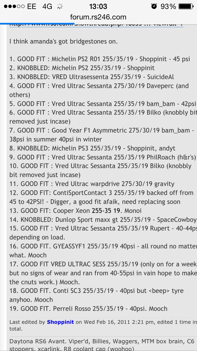

Just a quick heads-up for anyone in need of tyres-Oponeo currently doing GY Assym2s 275/30-19s at £133 inc VAT and delivered!!!! :boots: :boots: :boots:

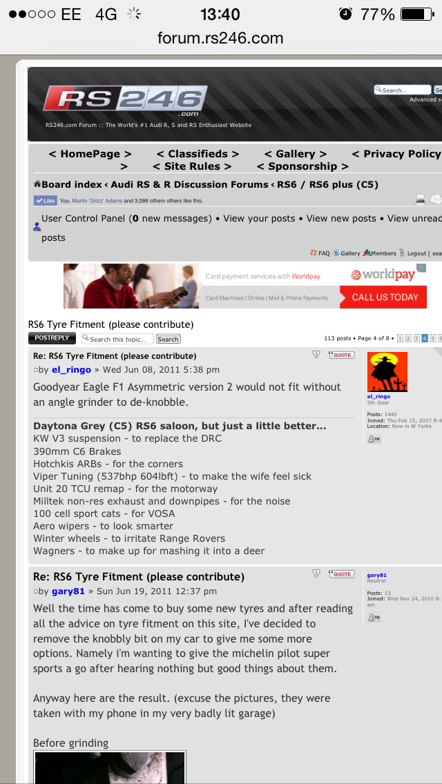

Good price - and remember you'll need to grind off Ol' Knobbly to fit those

Looks like the V1 fit but the V2 don't. Maybe I should update that page.

I think you need to de-knobble for any 275/30 tyre - the extra tread width over the standard (255) inevitably means it sits closer to Ol' Knobbly than I would be happy with

i havent problems with my 275/30/19 and protuberance

I'm running B7 RS4 wheels shod with Mitchy PSS 275/30/19r - de-protuberance'd. I think the offset on the B7s is high 20s - ET29 if I were to guess. Good clearance.

My MTM Bimoto wheels are 9,5 x 19 ET 30

bam_bam wrote:I think the offset on the B7s is high 20s - ET29 if I were to guess. Good clearance.
Yes, ET29 on the standard 19" RS4 b7 rims.
