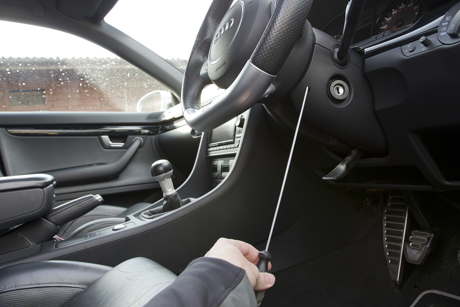

Next, slide your driver seat into the full back position so that it can allow you some room to work in.
We're looking to separate the steering column trims by undoing two Torx screws located underneath on either side. You’ll require a Torx T8 for this but one that is long and thin - the Torx heads are a fair distance up into the holes and a short T8 driver cannot get onto the heads – you will need one that has a minimum 70mm length shaft that fits into the hole circumference - I used a Laser 3420 tool, as some advertised 100mm tools include the handle in the advertised length.
6.)
Steering column cowling separation - Laser 3420 T8 driver tool

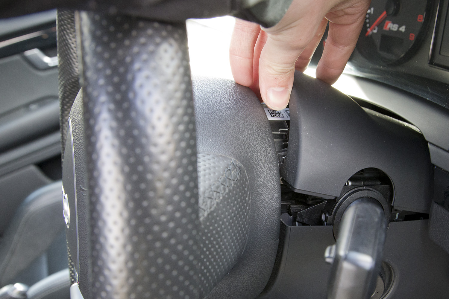

With both T8’s removed you can separate the column cowling trims, lift the top one up and fold it back onto the binnacle out of the way. Now you can remove the two covers located on the back of the steering wheel which hide some larger T30 Torx bolts - these secure the airbag to the steering wheel and are found at 3 o’clock and 9 o’clock. I find pulling the steering wheel around to keep the bolt at the 12 o’clock position makes it easier to work on. You’ll need the key in the ignition to stop the steering lock from engaging though; this won’t be a problem as the battery has been disconnected. Right?
7.)
Fold upper cowling backwards

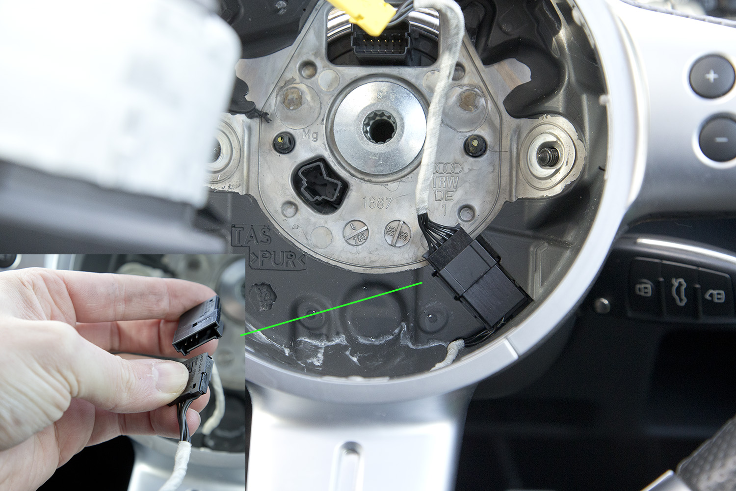

First off is the yellow connector, it has a purple sliding catch which needs to slide all the way towards you whilst pulling the whole connector gently. It should release, leaving the white material covered wires going down towards the bottom and a black connector. At this stage there may be enough slack in the wires to place the Airbag on your lap (if sitting in the seat) whilst you disconnect the Black connector. When that is done the Airbag should be free and can be stowed safely. I popped it into the passenger foot well, while I carried on with the rest.
10.)
Yellow Airbag connector disconnection
11.)
Black Airbag connector disconnection

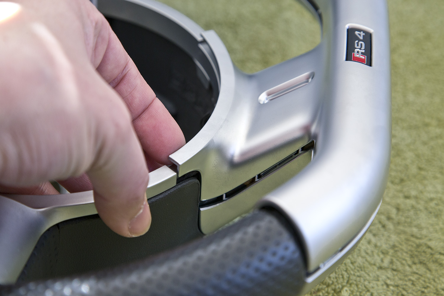

All push clips arrowed
19.)
Use trim tools to carefully separate halves
In this photo you can see the posts which have broken off from the opposing trim half.

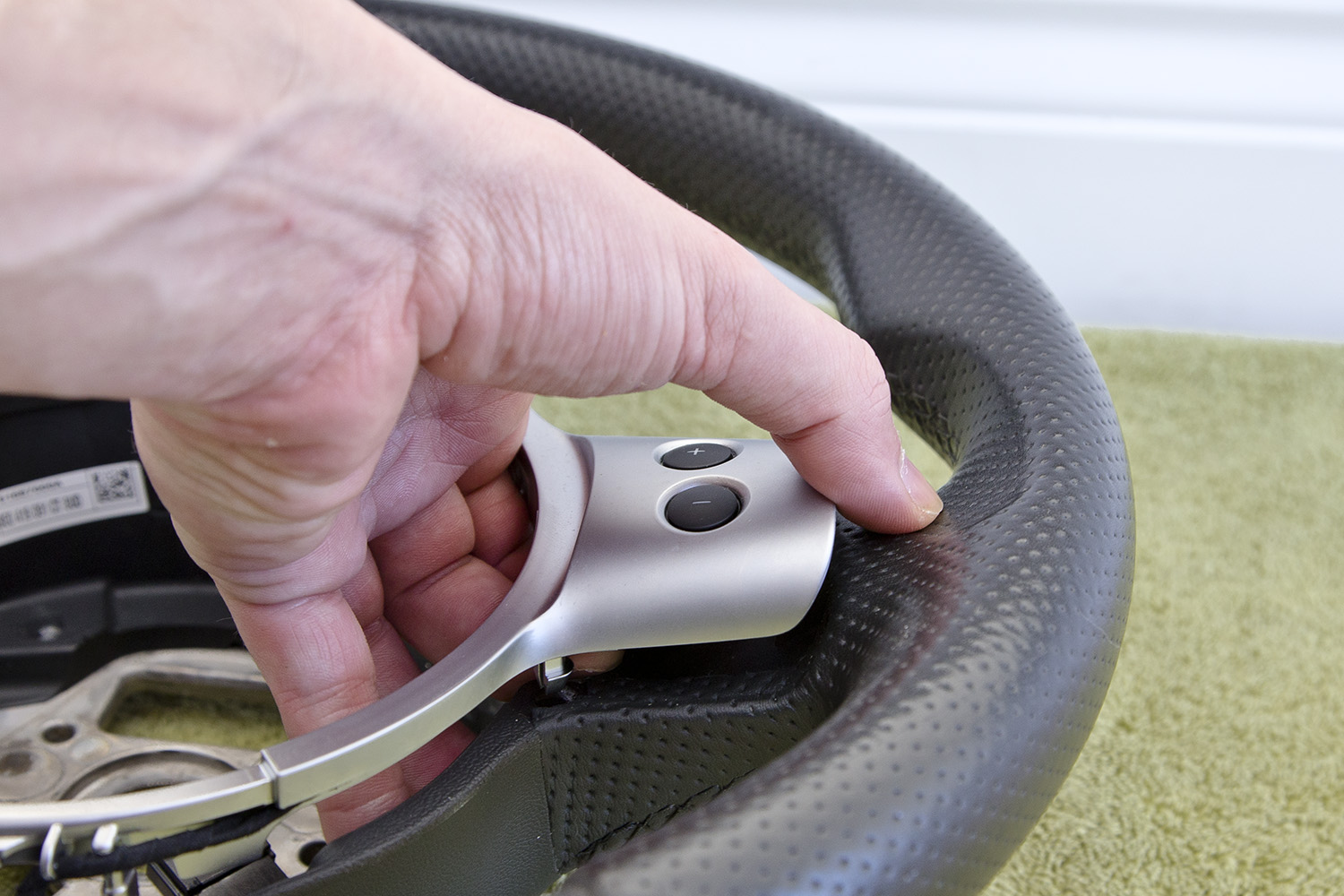

To remove the S button trim put your fingers underneath the button areas and gently ease the trim up. Do this a little bit from each side at a time, as the fixing posts are not that strong if you pull it up fully from one side and then the next.
21.)
S button trim removal
22.)
Do each side, little at a time.

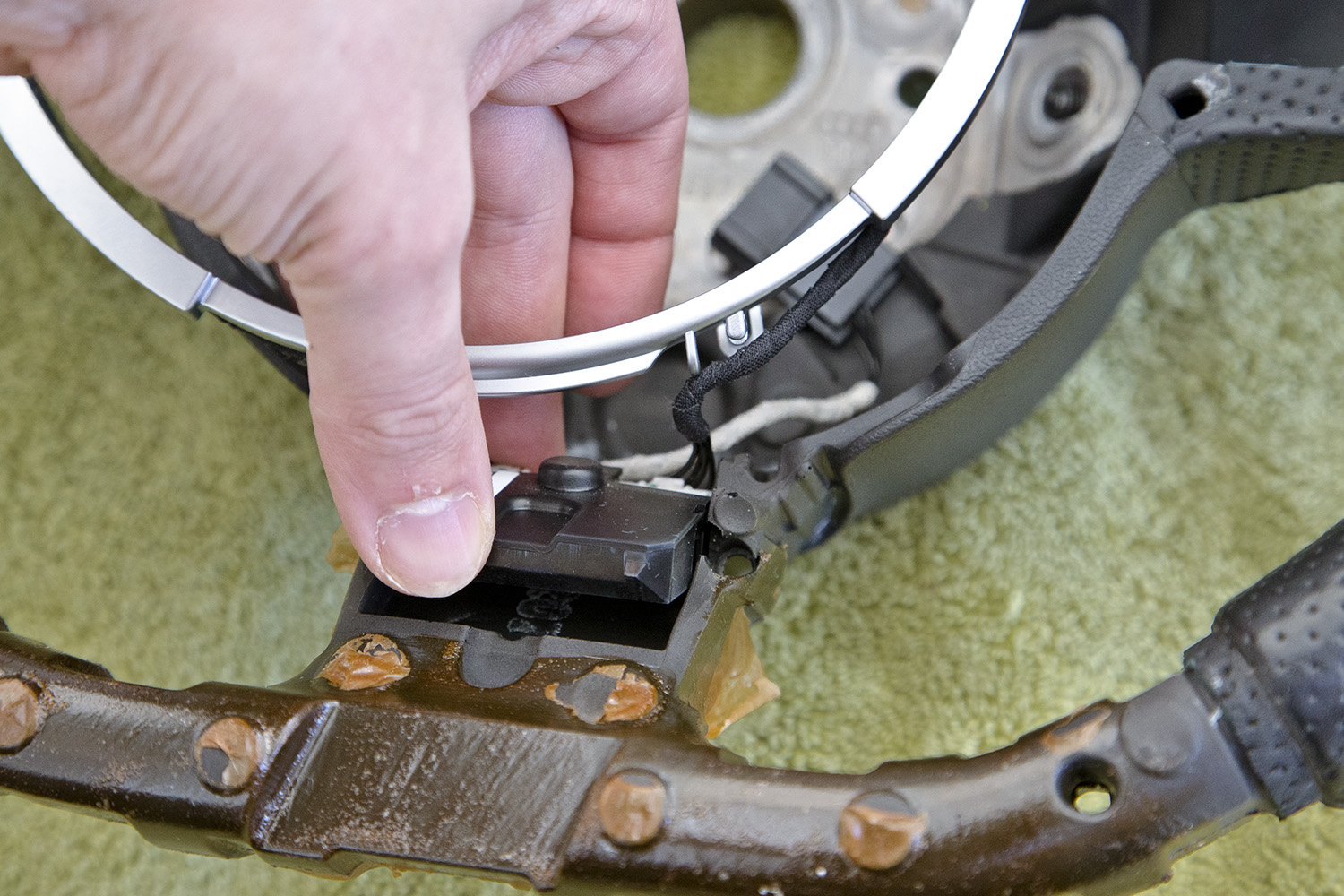

The large multi connector just lifts out of its place easily enough, then the whole multi-function button trim can be removed.
23.)
Lift connector from the cut out
Sport button trim fitting:
Fitting the new multi-function button trim is just a reverse of what you have carried out. Be careful with the wires, make sure that they are tucked in and routed correctly in the trim. As you don’t want to trap them.
