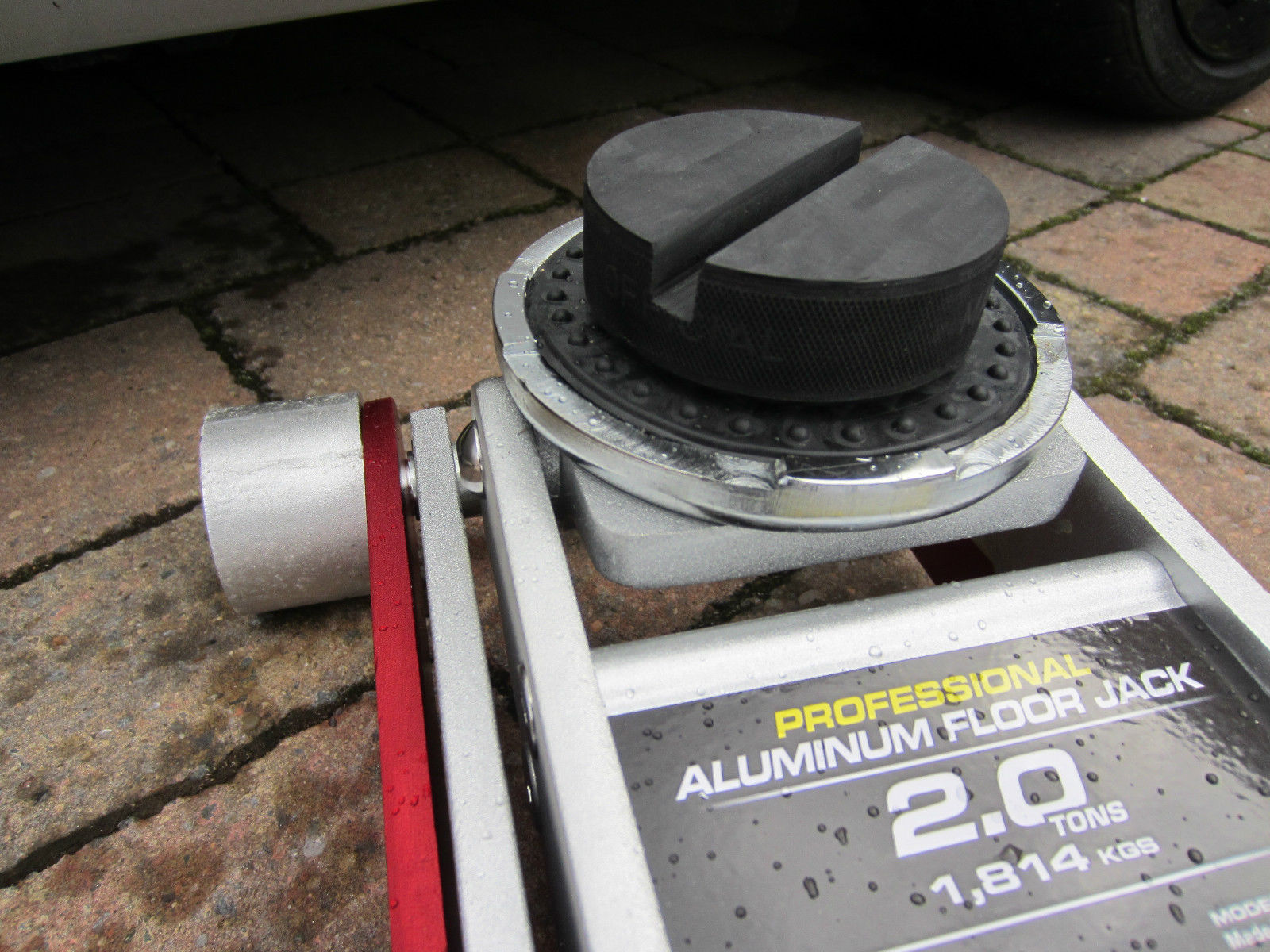

I used the points as mentioned above with no problems. I did make a tool the same as the rubber one out of wood
I did contact the guy on Ebay as it doesn't mention RS4 fitment and got no answer, however i think you would need a slot of approx 12mm wide by 20mm deep and 110 long maximum if i remember correctly. If you trawl through all the different ads it does tell you the slot sizes
I was going to machine one at work but couldn't find a suitable material
Booner - if you do get round to sussing it order one for me as well and i'll sort you out back in the Ury

It doesn't fit.
Better off with attic sheet if neoprene on the jack pad.

Aye I've got a couple. The slot is too narrow. I just use them on axle stands on my MK2 golds.
If you have a low profile jack some neoprene or heavy rubber sheet is best really.
