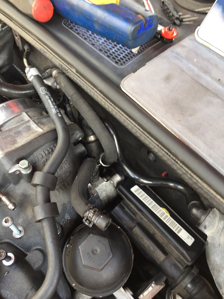

I'm started mine today ! I'm stuck here ! I can't get the back off by the breather hose from the coolant reservoir !!
Am I missing something simple!!!

follow this link and it will show you the full step by step guide on removing the manifold mate.
http://audirevolution.net/forum/index.php?topic=439.0
Remember you WILL need a very small ratchet into which a T30 (from memory) bit will DIRECTLY fit. anything larger and you wont get in the gap. This is at the oil separator/ coolant connection stage.

Yeah, it's very tricky, but follow the link for the removal guide and it will tell you where the bolts are. The lowest one is a pain. I couldn't remove the SAI pipes so access to the bottom one is very very tight. You need a very low profile ratchet like the one I mention early in the thread and then grind down a normal T30 bit so that only the driver bit protrudes. Just keep trying and you'll get there eventually.

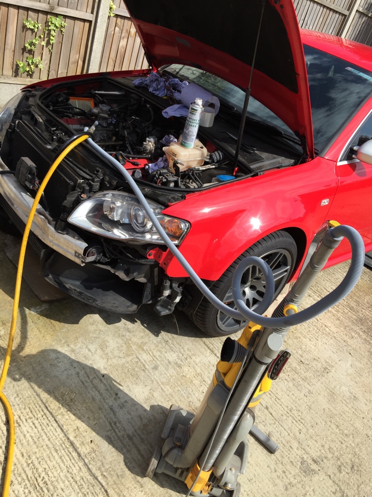

Long time away from doing this , but 1/2 off work to try this :)
But started doing this bloody Hoover has given up !!! Ffs
Now off to buy cheap Hoover
