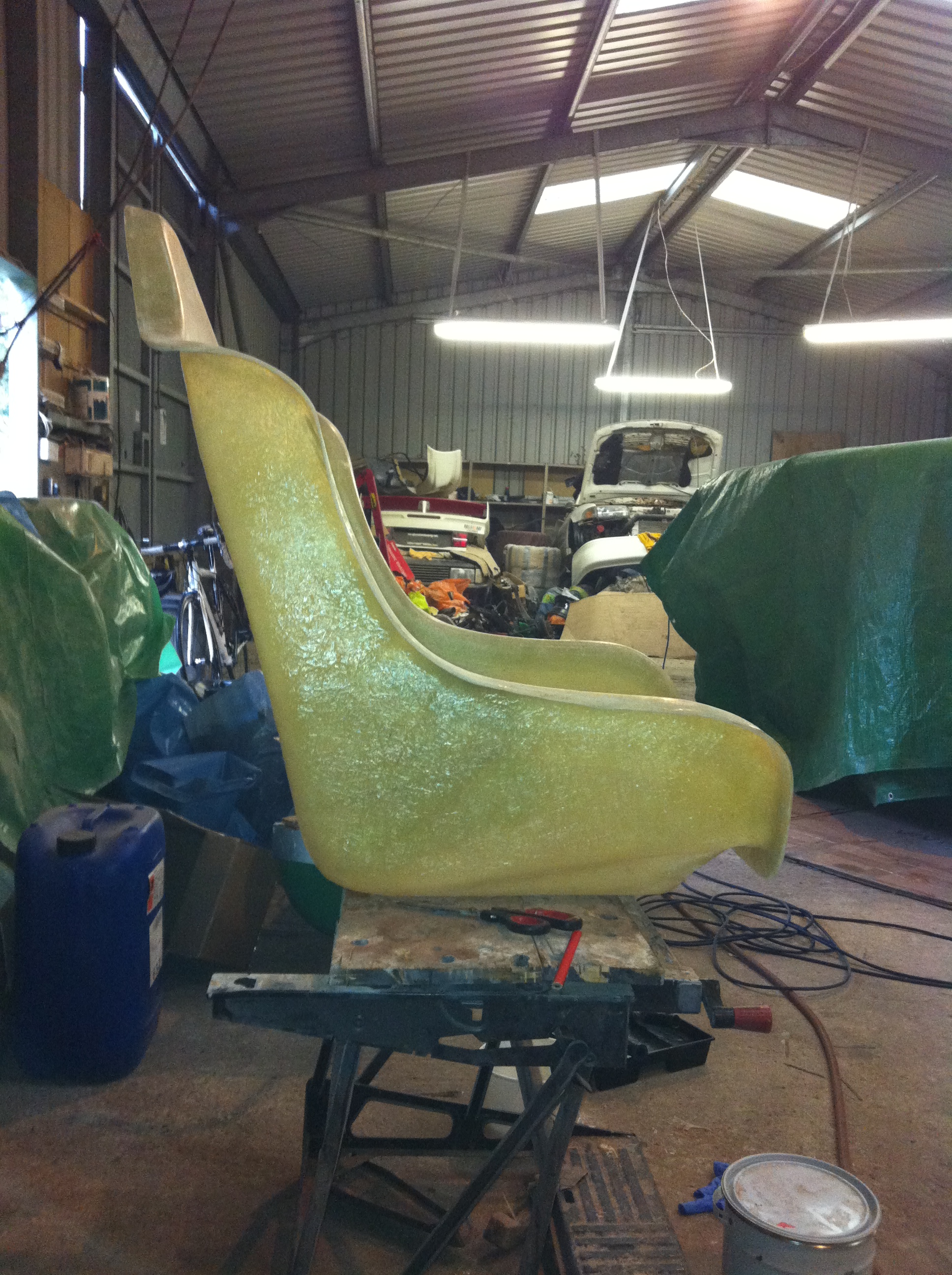

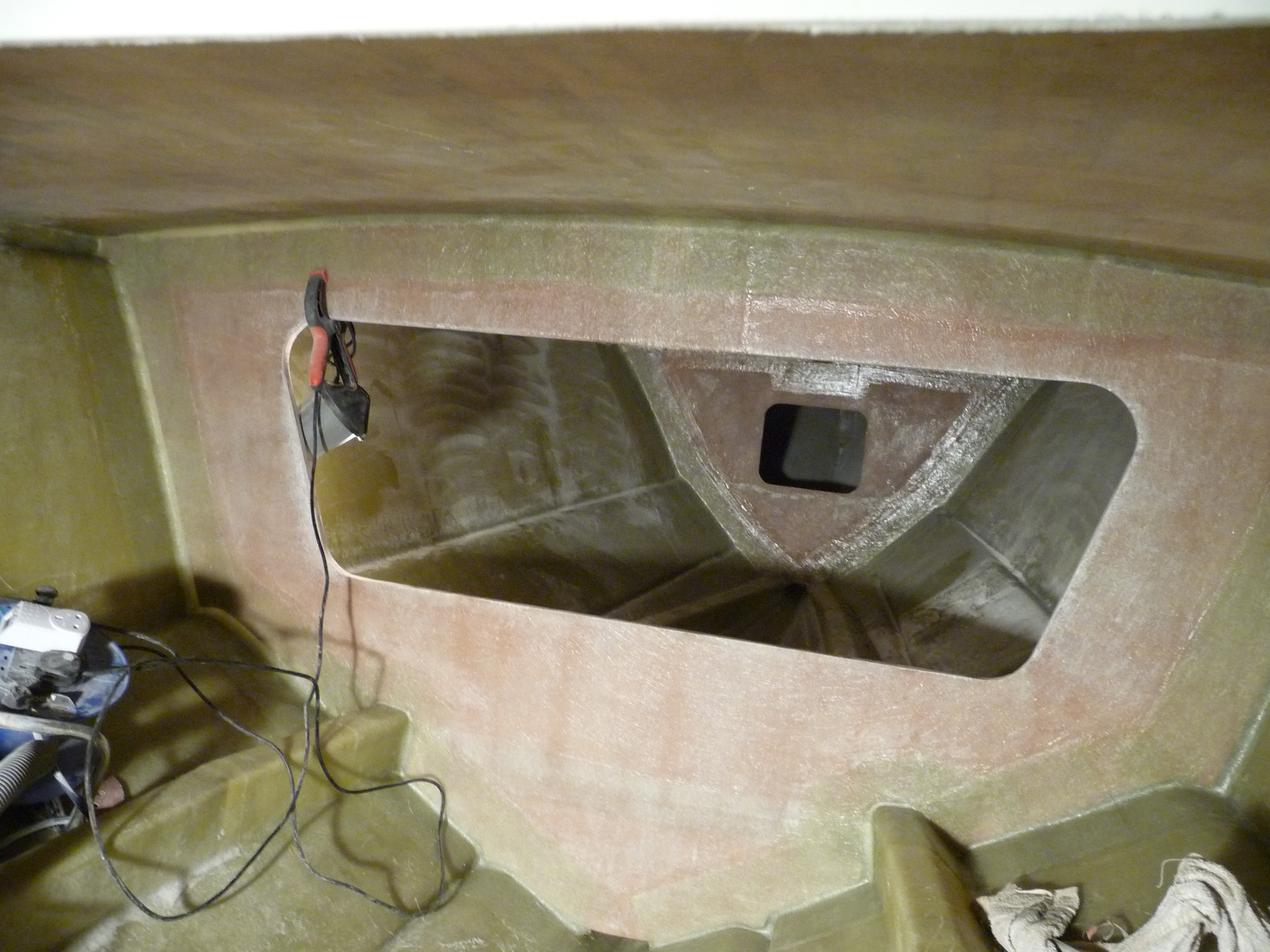

I've done a little glassfibre work. It is possible and you could make a lovely job of it, but I wouldn't recommend it if you are anything approaching a beginner at GRP.
You could make some substantial compromises on the surface finish and focus on strength & integrity as it's a hidden component - but I think you'd be surprised at how much effort it is to do a nice job. I've attached a couple of things I've done in GRP recently - a bucket seat shell, off an existing, good quality mould, and lots of bulkheads and formers in the powerboat I'm building. That bucket seat - I built 4 - the first 2 being rubbish ones that I had to throw out. And it looked like an easy shape!
