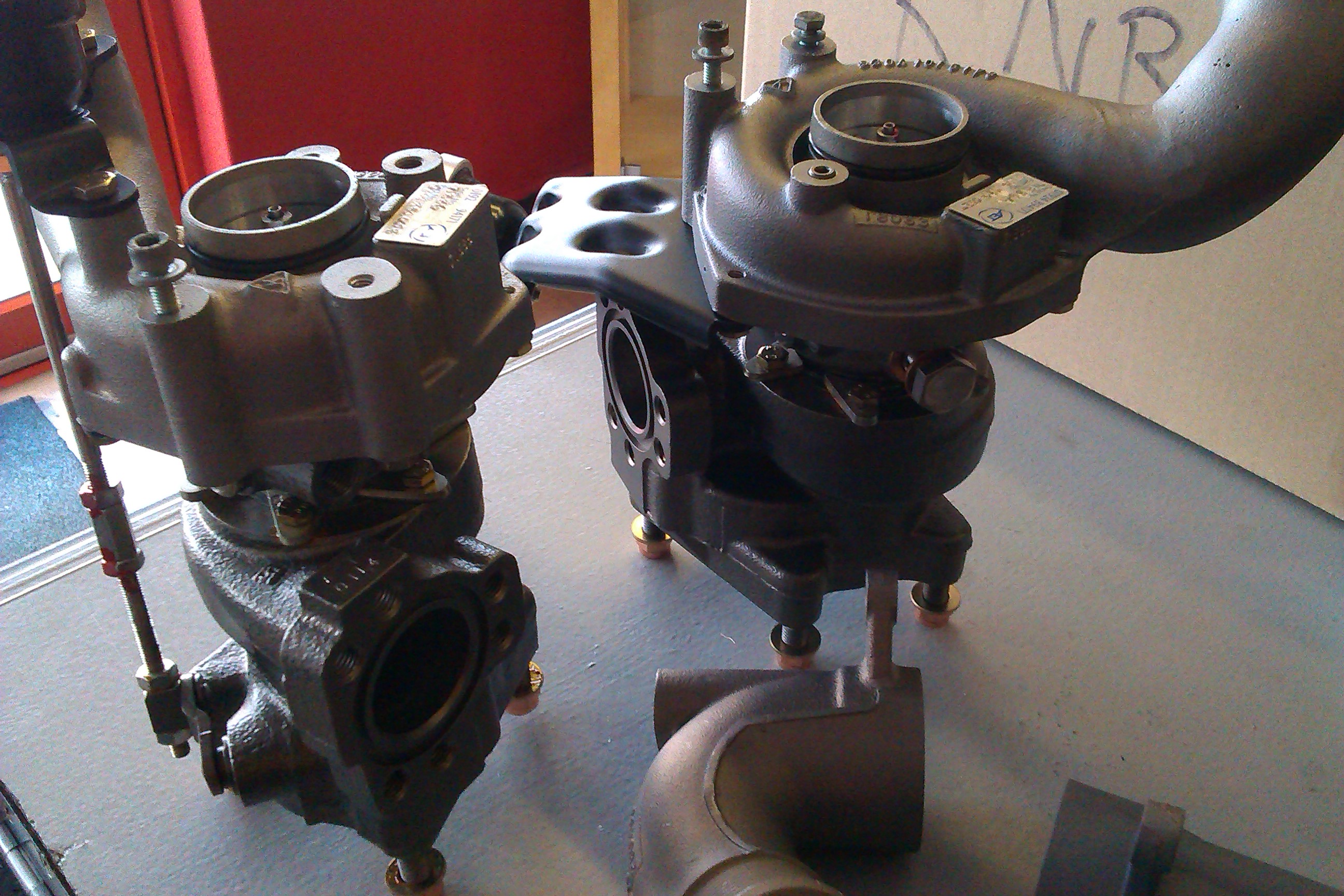

AET of Wakefield did mine, no complaints whatsoever, here's the spec:
Starting with the orig K04 turbos,
Machined 7 deg cutback to turbine exdcuer to increase flow through the turbine housing
Fitment of K06 billet compressor wheels, 35Lb/min
CNC machined compressor covers to accommodate the hi-flow billet compressor wheels
Fitment of AET motorsport spec 360 thrust assemblies to cope with increased boost pressures
Total seal piston rings fitted to turbine for low back pressure exhaust systems
Ported wastegates for increase boost control at hi boost
14psi Turbosmart IWG75 actuators fitted
VSR Balanced to motorsport spec
