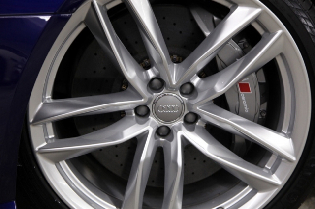

At 7k mls my ceramic pads color is changed, without track or heavy use!!
I heard this happened to some maseratis before but not any of my cars with ceramics even with heavy track use.
Any one heard of such thing?
We have send the pics and info to audi and waiting for answer...
From this: To this:
From this: To this:

I think the OP means the caliper has changed colour, looks like it's turned a bronze colour.
Re: Ceramic pads changed color!!!
I think you are right SuprSi... it does like kind of cool to be honest...

Thx for the info Lewy, actually I'm not worried about the wear on the disks, as you have said they should be fine.
But the color change what worries me, if audi says that its "normal" to change color, which shouldn't be, otherwise harmless to brakes, i may consider getting the rears painted too, at first glance it does not match to estoril, but i kinda think it looks cool too..

Looks like a yellowing of the calliper paint. I certainly wouldn't accept that as normal.

This is normal, a lot of R8's have the same problems. Your discs are fine, you only heat them pretty high at some point. They were glowing

It's did a good job of the colour change consistant and smooth lol. If u like it great but I'd still tell them check em shouldn't change colour whether or not others do. I think

For future reference; after a bit of mailing to and from audi gmbh and taking various pictures, they have changed the brakes under warranty.
I do not know if owning 4 RS cars since the last 6 years, (b7, 2xc6 and c7) and bringing them to service regularly even if total mileage between services was 2k, made a difference, but here is the result..
