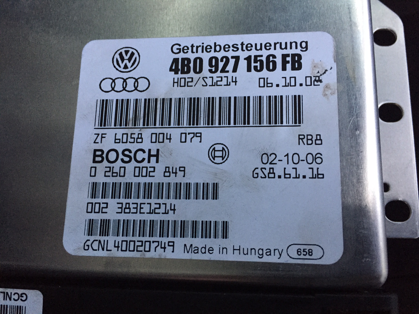

Just had the exact same problem/fault on my car.. (18223) after reading this thread I thought I'd go straight for the TCU!
Replaced it and has worked a treat.. so far.
It was a 15 minute job and no garage visit. Although you will need vag software in case you have to program the new TCU. Second hand one I bought off eBay was already set up same as my old one, very handy!

What's the right part number for the TCU?
