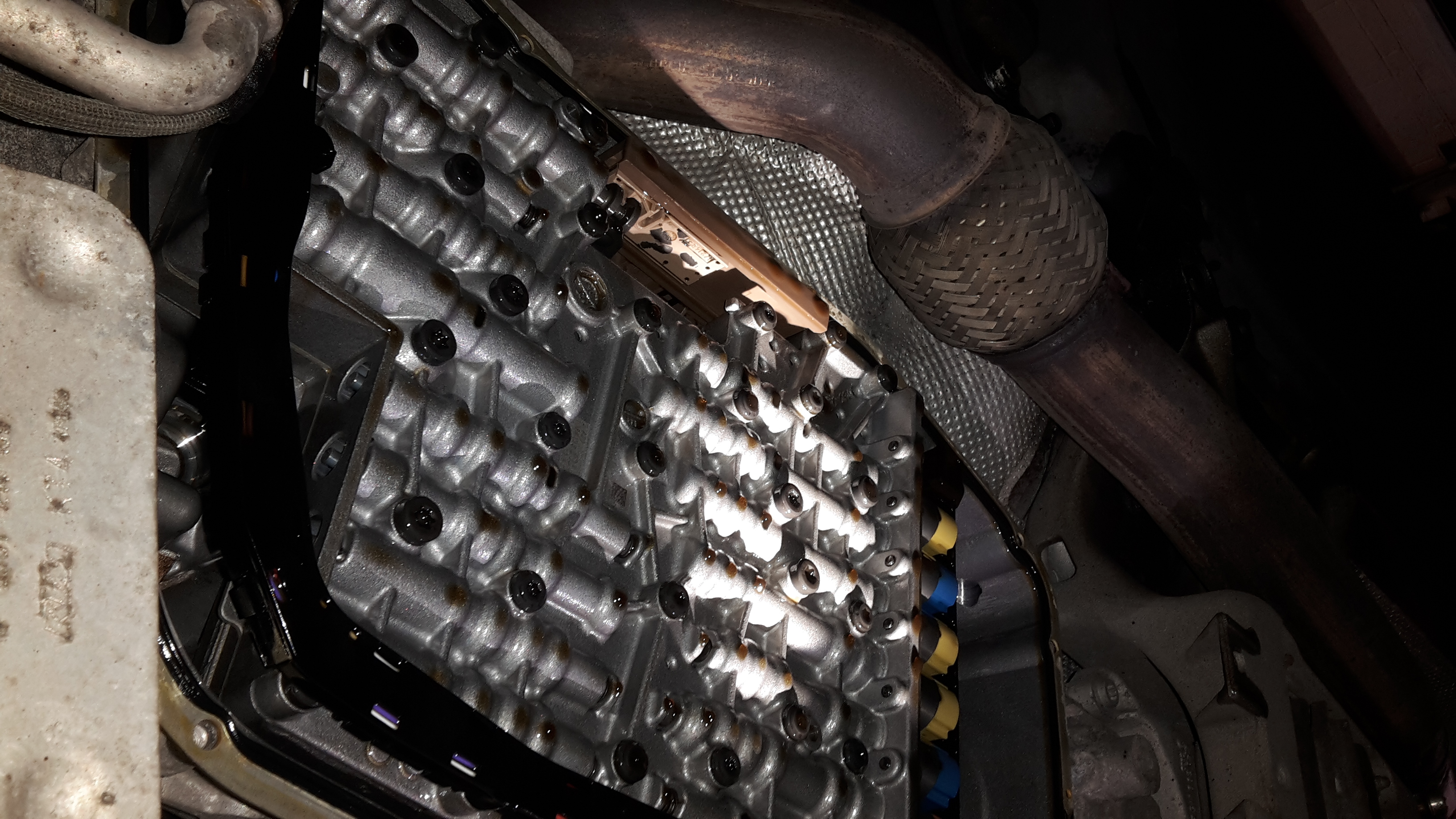

Here is a shot of my solenoids!!

Strange looking thing!!
