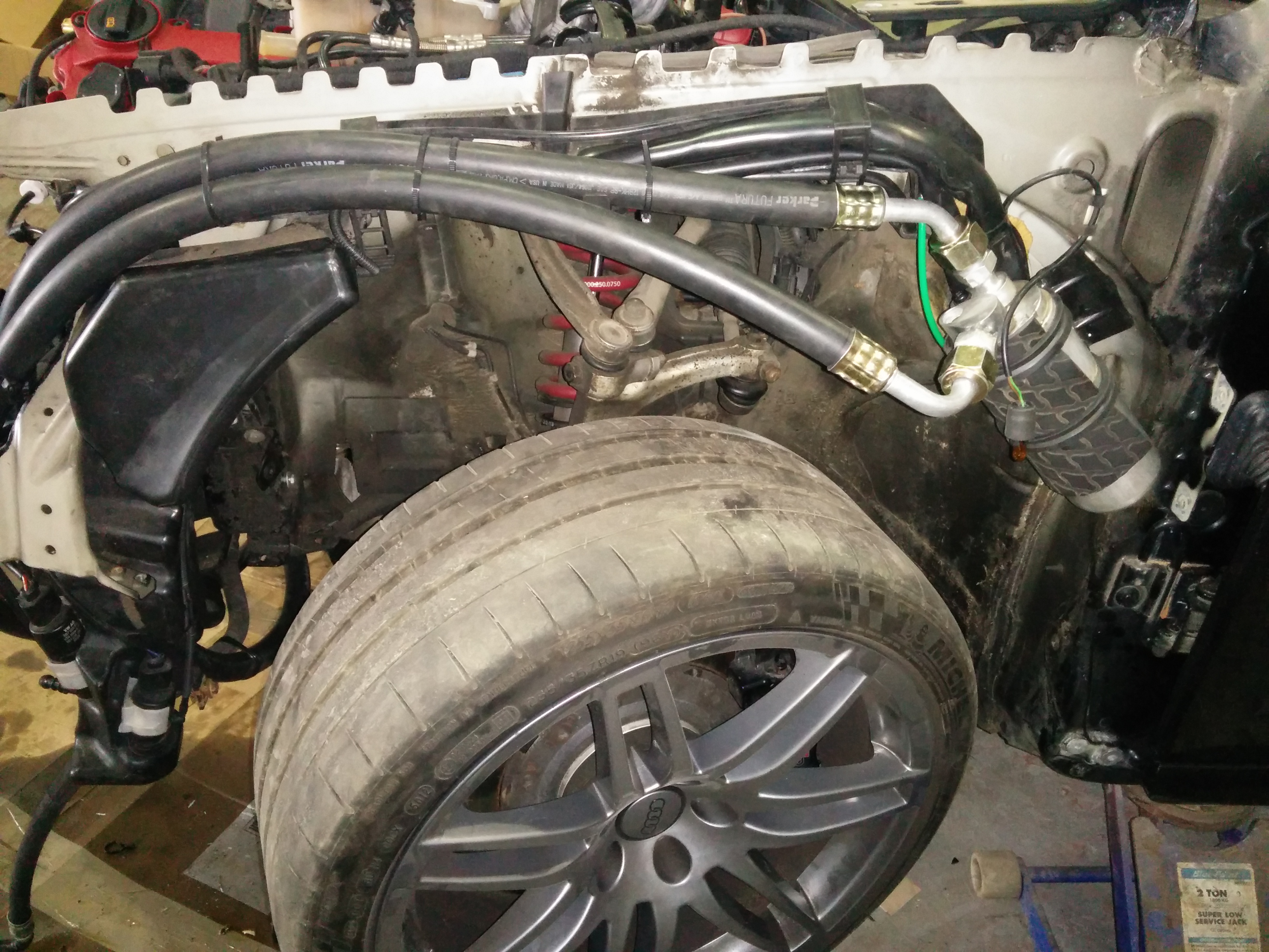

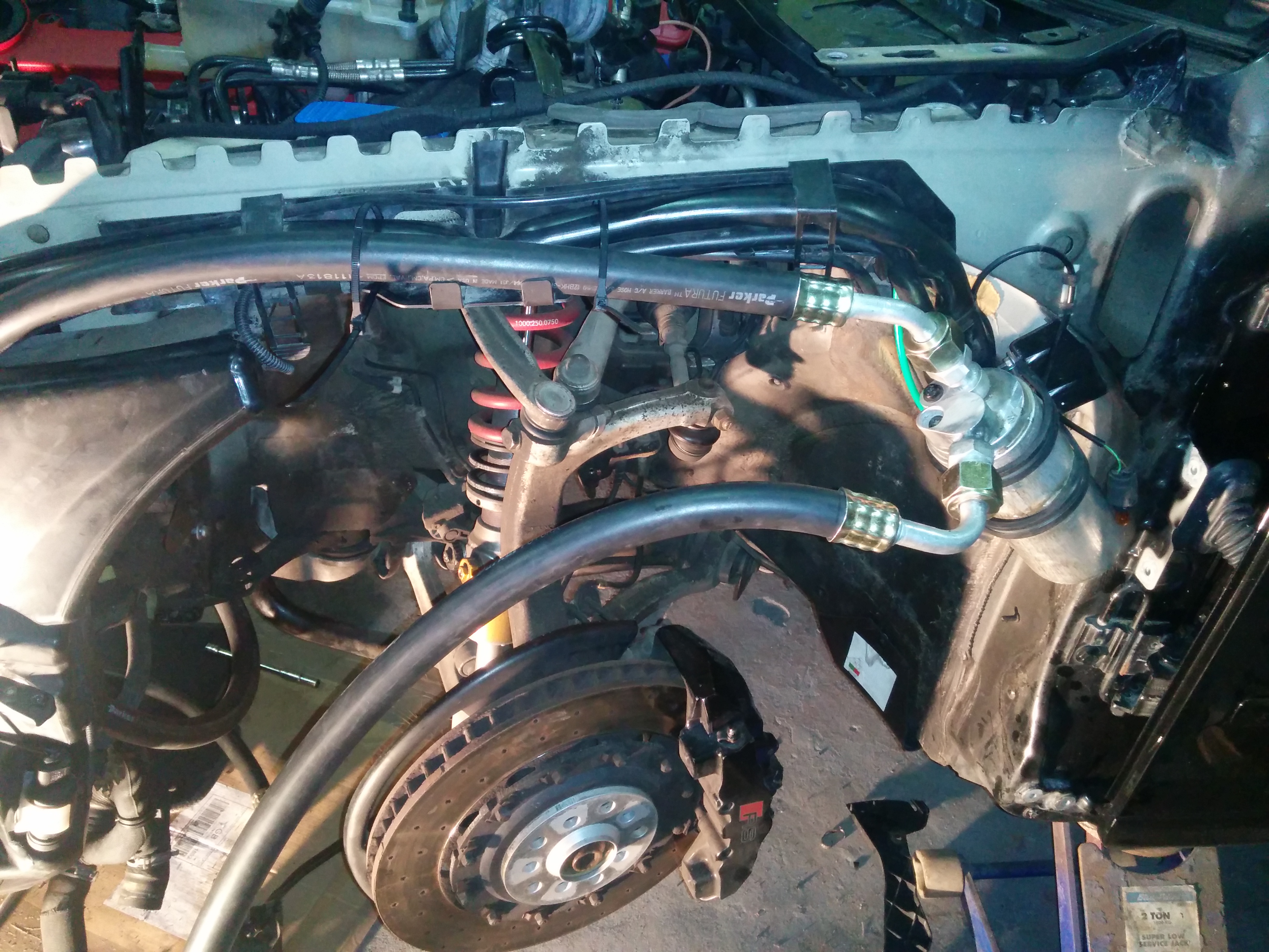

so with the front vacuum res sorted it was time to rehome the filter/dryer, this is hung from the bracket that would normally hold the front res.
filter/dryer trial hung and pipes and pipes attached the clips that hold the dryer/filter were slightly to big so i added a bit of rubber to tighten it up a bit.

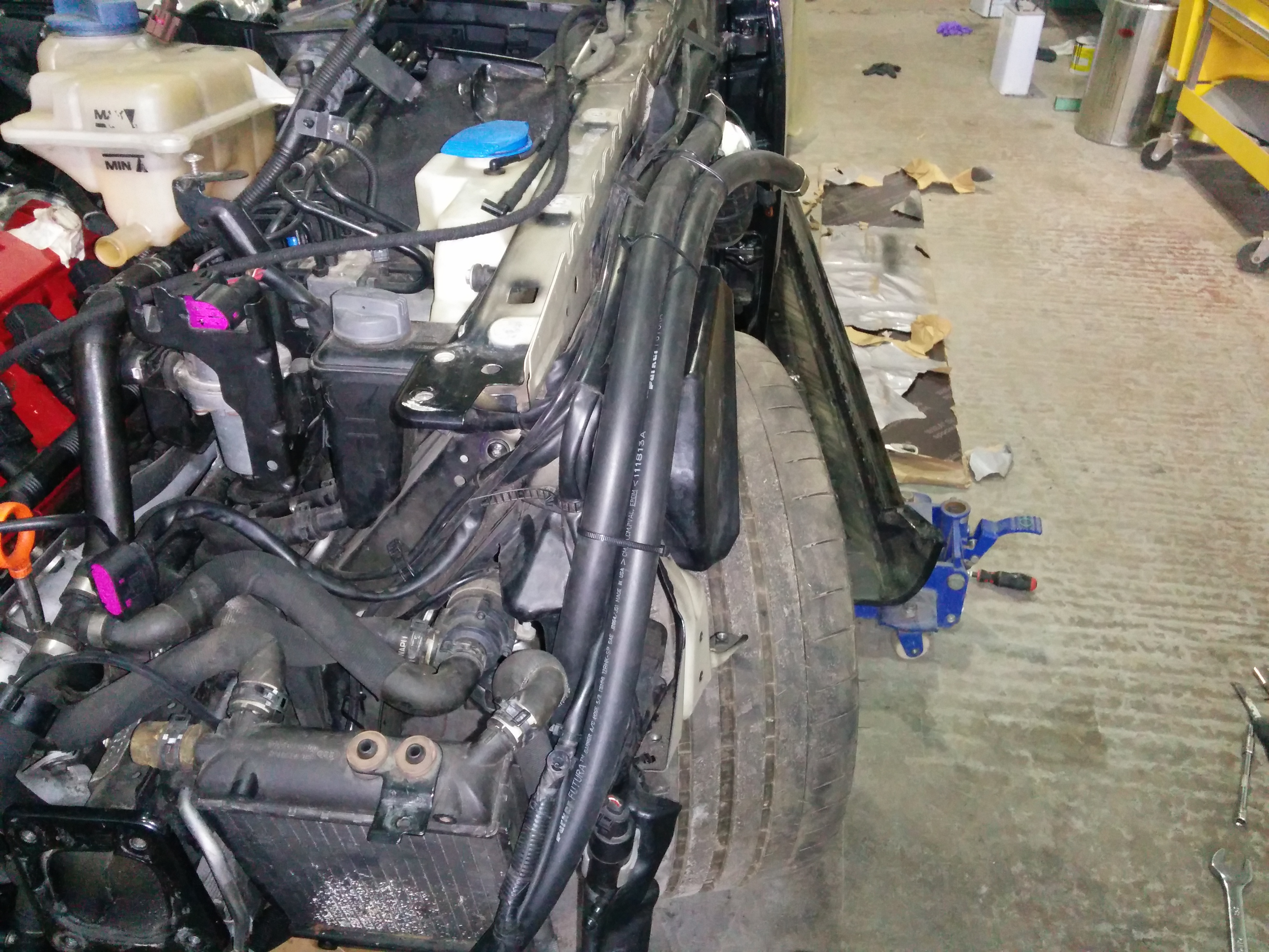

routing the pipes along the void behind the top of the wing and over the front washer bottle. the pipes run behind the passenger side headlight, one goes down behind the aux rad and to the a/c pump the other pipe is the long blue one i modified the thread angle on earlier this has to run back to the other side of the car. i hung the wing back on to check for fitment and all is good, tight but good.
just enough room to get the wheel arch liner back in, looks like i need to raise my suspension up a touch or roll the wing edge as the marks are where the tyre have been rubbing on compression. pipes tucked away nice with the the dryer hung it was time to make the last adjust to the long blue line, we new from the outset that this pipe would probably need shortening depending on the final route. jhm recommended running the long line along behind the bumper reinforcement bar back to the other side of the car, so i hung the bumper without the front panel on so we could check the length.
with both ends of the pipe attached and roughly held in position with cable ties you can see the pipe is to long (the sag in the middle). we undid the pipe at the airbox end pulled the slack through marked it up chopped the end off and it was of to pirtek to get them to crimp on the spare connector jhm sent, big thanks to pirtek at team valley as they crimped it on for free!.

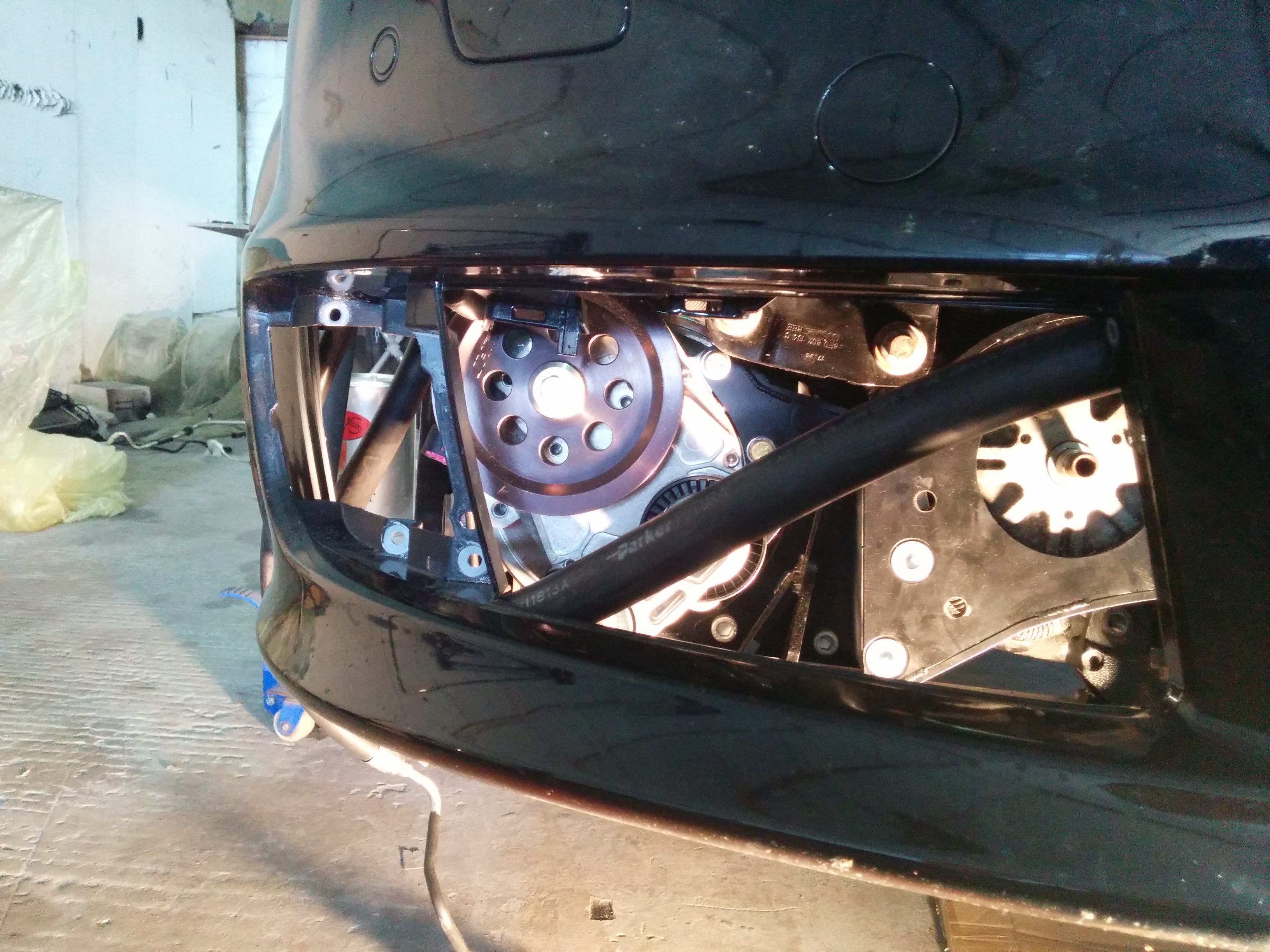

one of the requirements of the stage 1 kit is you have to give up your drivers side fog light, the back side edge of the foglight housing will just come into contact with the pulley on the supercharger. there is talk you might be able to run the foglight with the stage 2 kit as it has the smaller pulley but with the larger stage 1 pulley it has to go.
this doesnt bother me as in 8 years of ownership i have only used them a handful of times, for the time being i will modify the foglight and just have the lense in place and run the resistor in the kit to keep the bulb out warning at bay.
i might look into some sort of led conversion which would allow me to shorten the back side of the housing but thats a job for another day...
with the bumper on you can see how close the supercharger would be to the foglight. with the bumper back off i removed the bracket that holds the foglight in for more clearance, i also shaved off a couple of centimeters of plastic from the back of the bumper just to be sure. back on the car to triple check for clearance, all good.

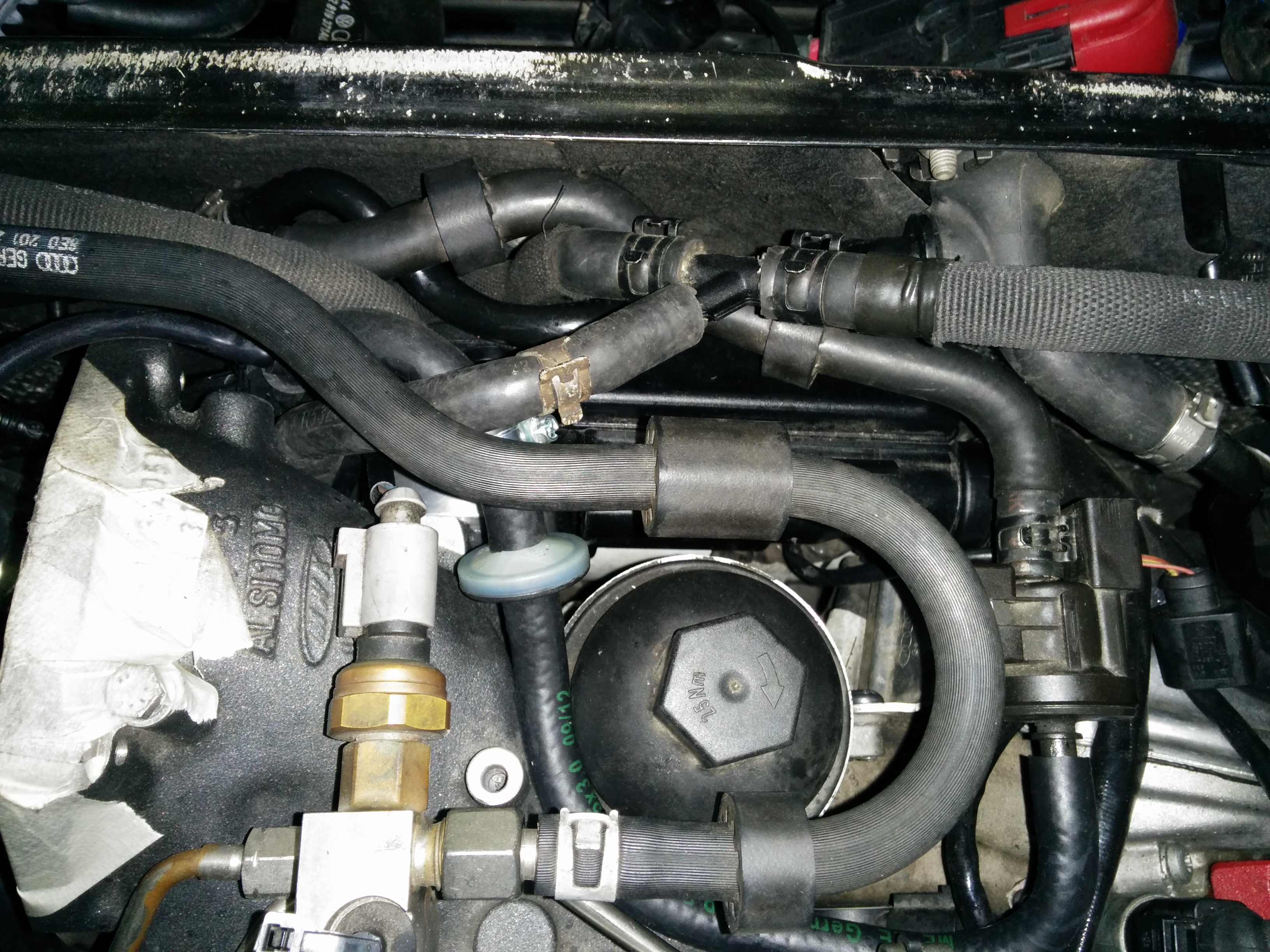

if you have an earlier rs4 (2005-2006) they did not come with a spare capped of nipple so you have to "T" into the vacuum line for the fuel evap system.
my car is a 2007 so should have had the spare nipple but because i have mrc's stage 2 manifold (ported out and flaps and shafts removed) the manifold that went back on my car must have been an earlier one (mrc do the stage 2 manifolds on an exchange basis) so i have to pinch my vacuum from the evap circuit.
the fuel evap circuit consists of a vacuum line from the inlet manifold behind the throttle body to the N80 purge valve from there a pipe runs round the back of the engine and through the inner wing to a charcoal filter which is then connected to your petrol tank, the idea being excess fuel vapor is sucked from the tank when the ecu tells the N80 valve to open via the vacuum provided from the intake manifold.
i needed to tap into the section from the manifold to the N80 valve.
here you can see the one way valve and T piece i had to install so with that done the list of jobs to do were getting smaller, time to get the pulleys and belt on i think.
