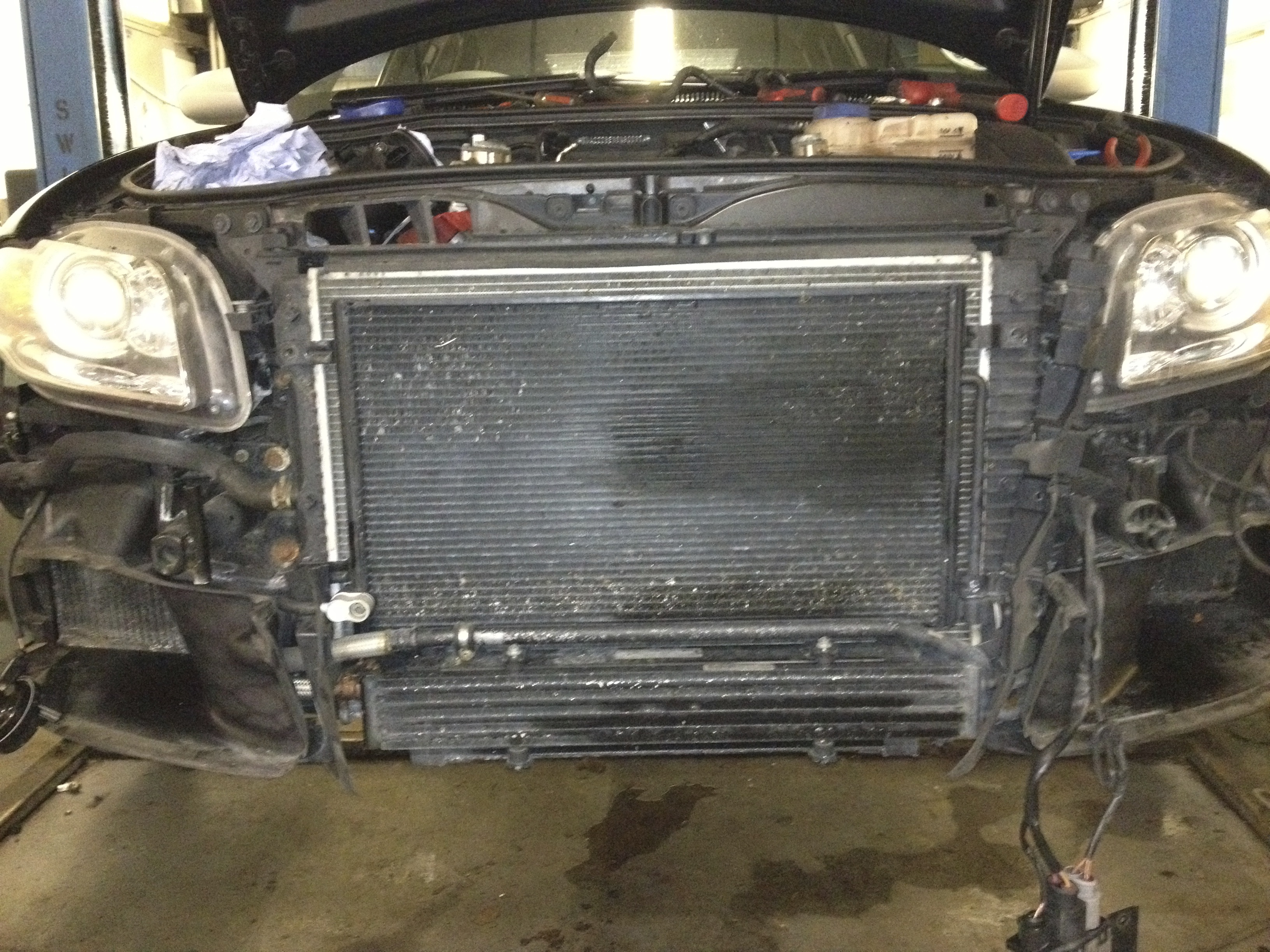

even though you have had it regassed it still may not work properly , there are several things which could cause this...a likely thing is the condenser radiator in front of the cooling rad may have the fins deteriorated or rotted away basically so that the recirculating gas isnt cooled enough to condense back to liquid enough so the system progressively gets poorer till it stops working , i had the same problem with my mondeo run around , the A/C would be absolutely freezing for a few mins and then after 10 mins stopped working , I found that all the fins were gone and only the tubes left , new condenser , and its brand new again cools flat out the whole time ,
worth looking at the fins , you can see it through the upper and lower grill ( see pic ) , though the oil cooler is in front of it at the bottom. the dryer (dessicant to remove moisture ) may also be overloaded with water which affects operation also , but shouldnt really be overloaded unless the system has been empty of gas due to a leak which will allow moisture in ,as obviously its a high pressure sealed system like your fridge
