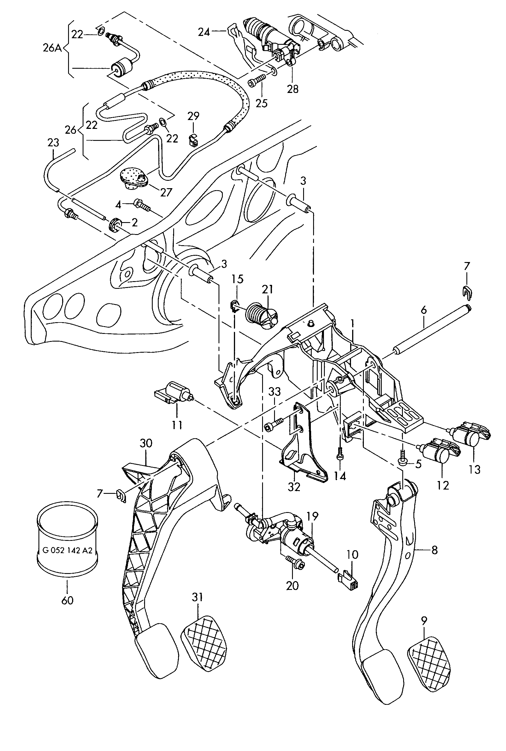

Regardless of what the mechanic has said, surely it needs to be changed out if only to rule it out?
Personally I would replace the clutch pedal assembly like Irishmike did in the above post keeping everything else as it is.
Coffey could you please help me a bit?
When you refer in changing the pedal assembly, which part number do you speak about?

Then i guess it is only the pedal (part 30 above pics)and nothing of the surrounding ancillary parts.

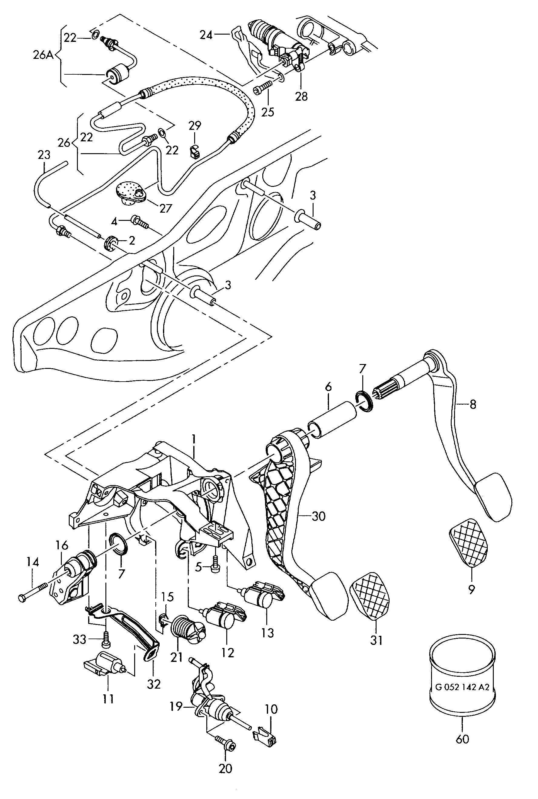

Too the pedal off this morning and still shows no sign of problem.
Ordered part number 14 of the bottom picture (sth like a pin) as this may be an issue, but from the looks of it it is unlikely.
If the pedal is to sit straight with the brake pedal and it should not rest on the plastic dash...i think.

It was the slave cylinder, master cylinder, some parts of the pedal clutch assembly, new fluids everywhere and the guide sleeve.
The latter was a question though. As in the previous pics mine was metallic but with the round bottom. In other posts here i have seen what was called a "new" version that had instead of a round bottom a triangular one with screw holes. When we ordered the guide sleeve Audi sent the same type like the one i had. Actually when we fitted in, we noticed that the "new" version must have been sth else and not the guide sleeve cause the reception in the shaft is round and there are two holes where you bolt the part that goes on top of the guide sleeve.
