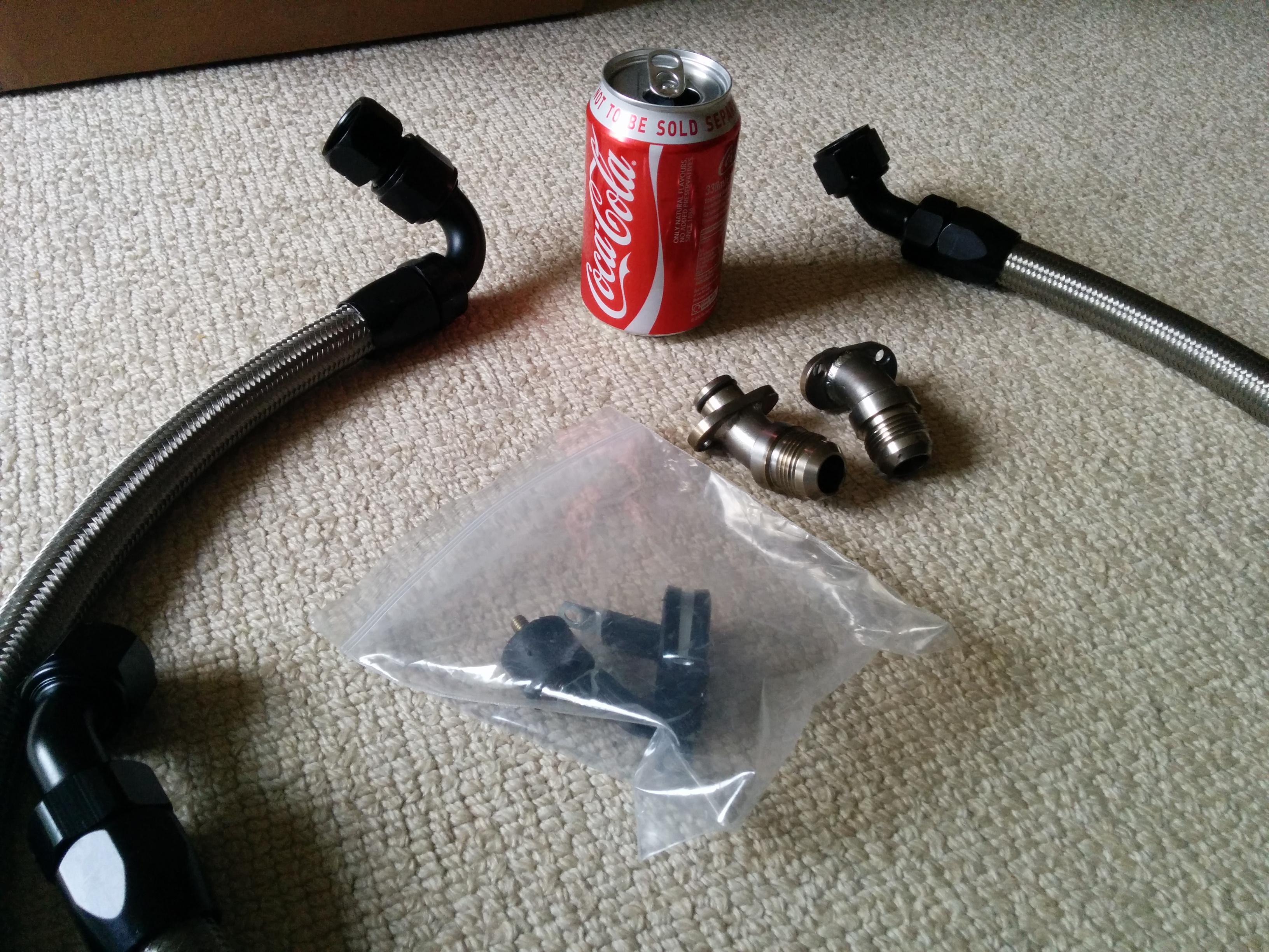

the reason why its not straight forward to get your own lines made up is the fittings that go into the engine block, these are unique to the rs4 and are directly attached to the oem lines. you would need to get lines made up then get a set of the connectors machined for the block, it wouldnt be cheap for a one off.

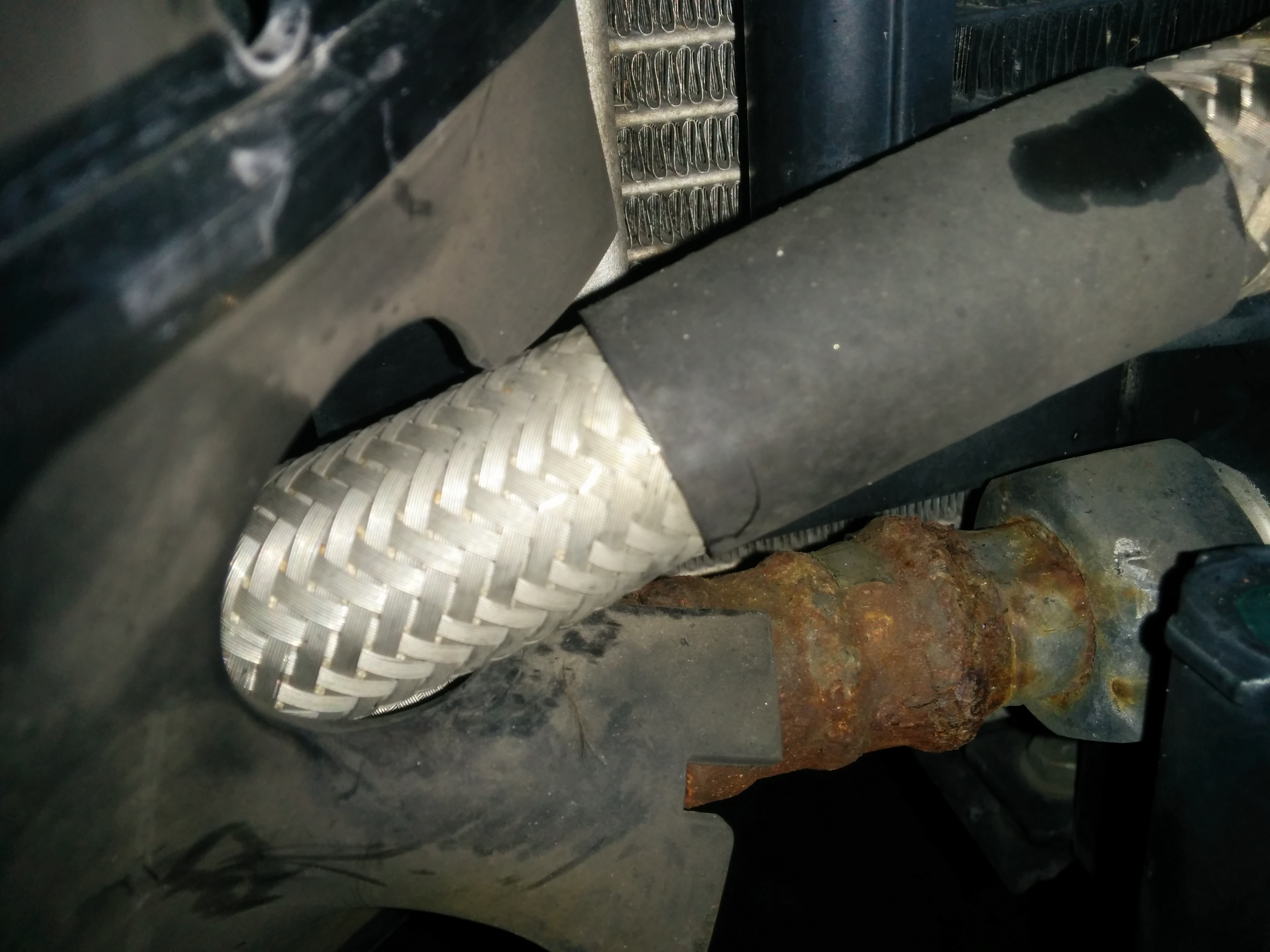

as a side note i have my car stripped down at the moment and i have had a leak from the connectors in the block it looks like the o rings have perished, not a problem as i am swapping to the jhm lines. also the oem lines use one bolt on each connection to the block even though the block has two threads per connector.
here you can see the connections that go into the block
oil leak from connectors/block
crusty oem crimped on connector
jhm lines and block connections

neil the reason i went with jhm and not forge is because hopefully the cooler will be ok, i will cut the nuts off but if the threads are knackered i will weld new ones on.
like you say the oem cooler is made by setrab and is 100% up to the task of cooling the oil you dont need any extra capacity, plus like you id prefer it in the oem location as when i go jhm stage 2 i will need to put another rad in probably right where the forge one would be.
