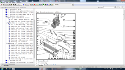

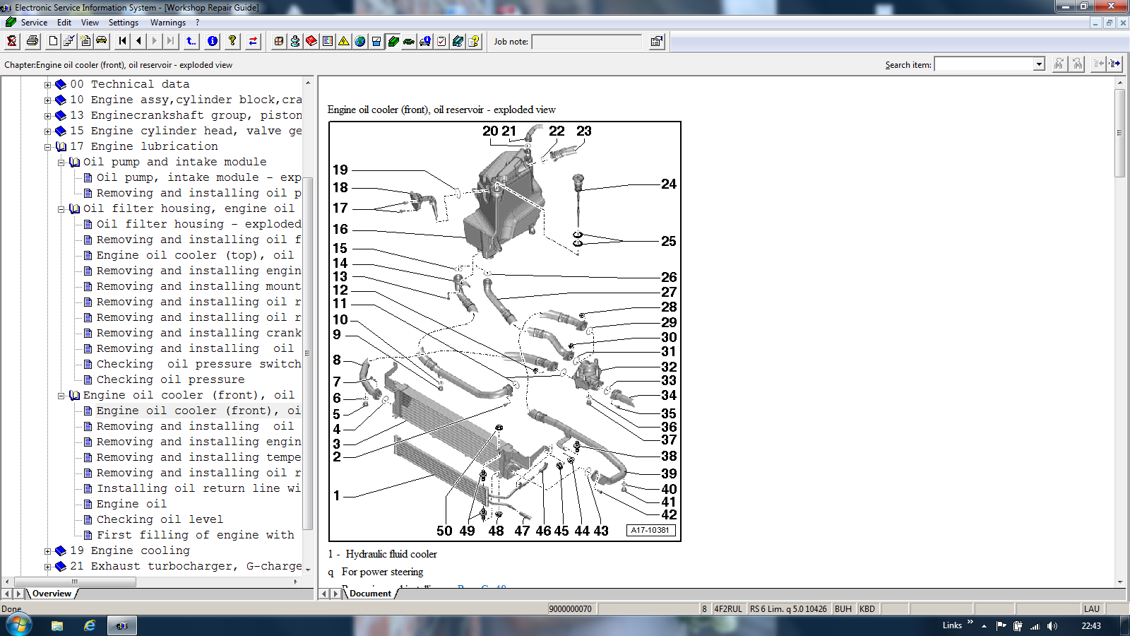

Not sure where the oil level sensor is. You can check Elsawin or google: partsbase.org
classba
Posts: 1814
Re: Oil light??
Post by classba » Wed Jul 23, 2014 10:45 pm
Here you are.... item number 18 is the sensor.
