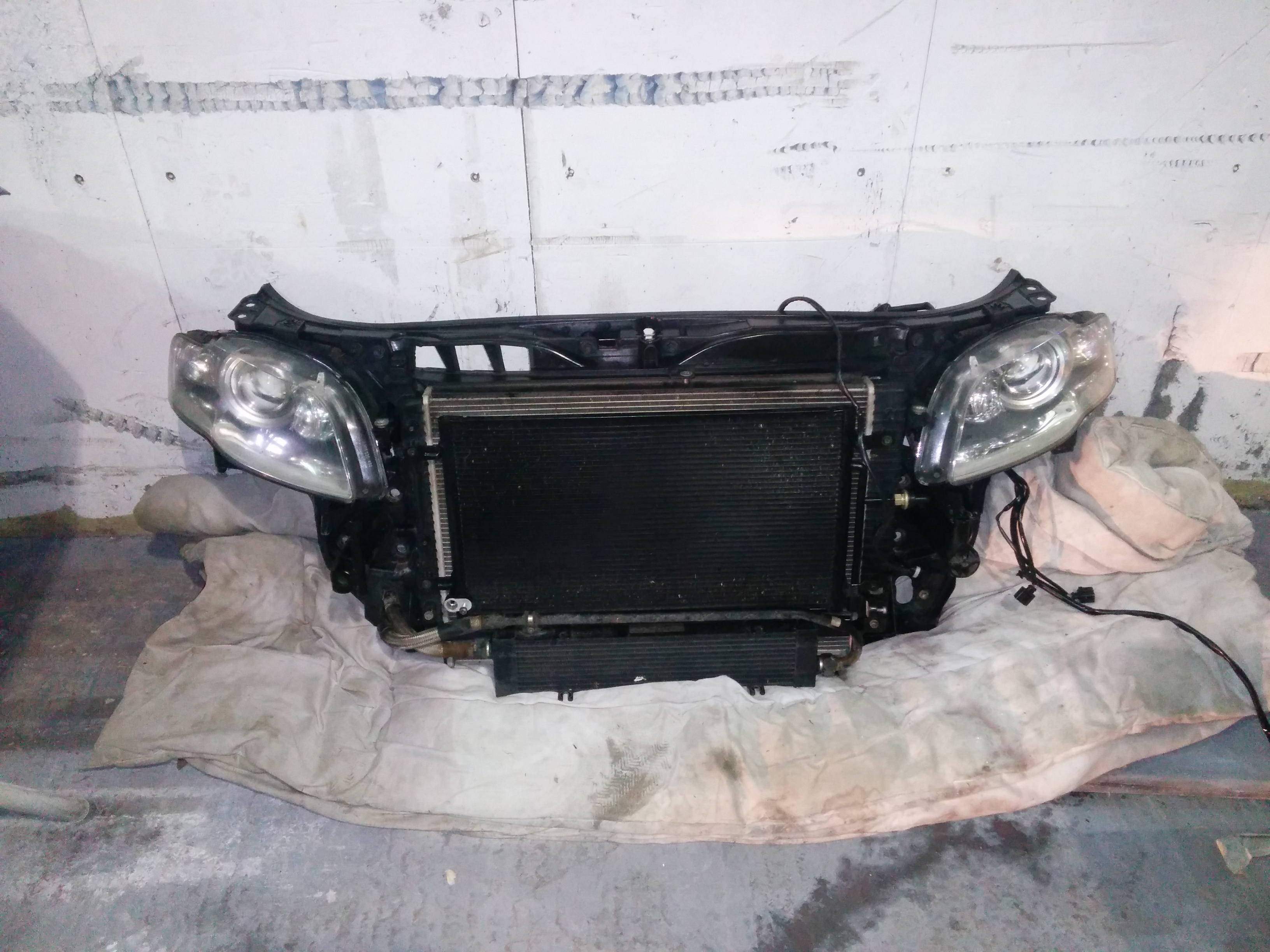

bumper off and crash bar removed, time to drain fluids.
unplug headlights and crash sensors, detach radiator hoses and a/c lines and remove oil cooler lines from the block and the front panel lifts off as one.
leaves this
