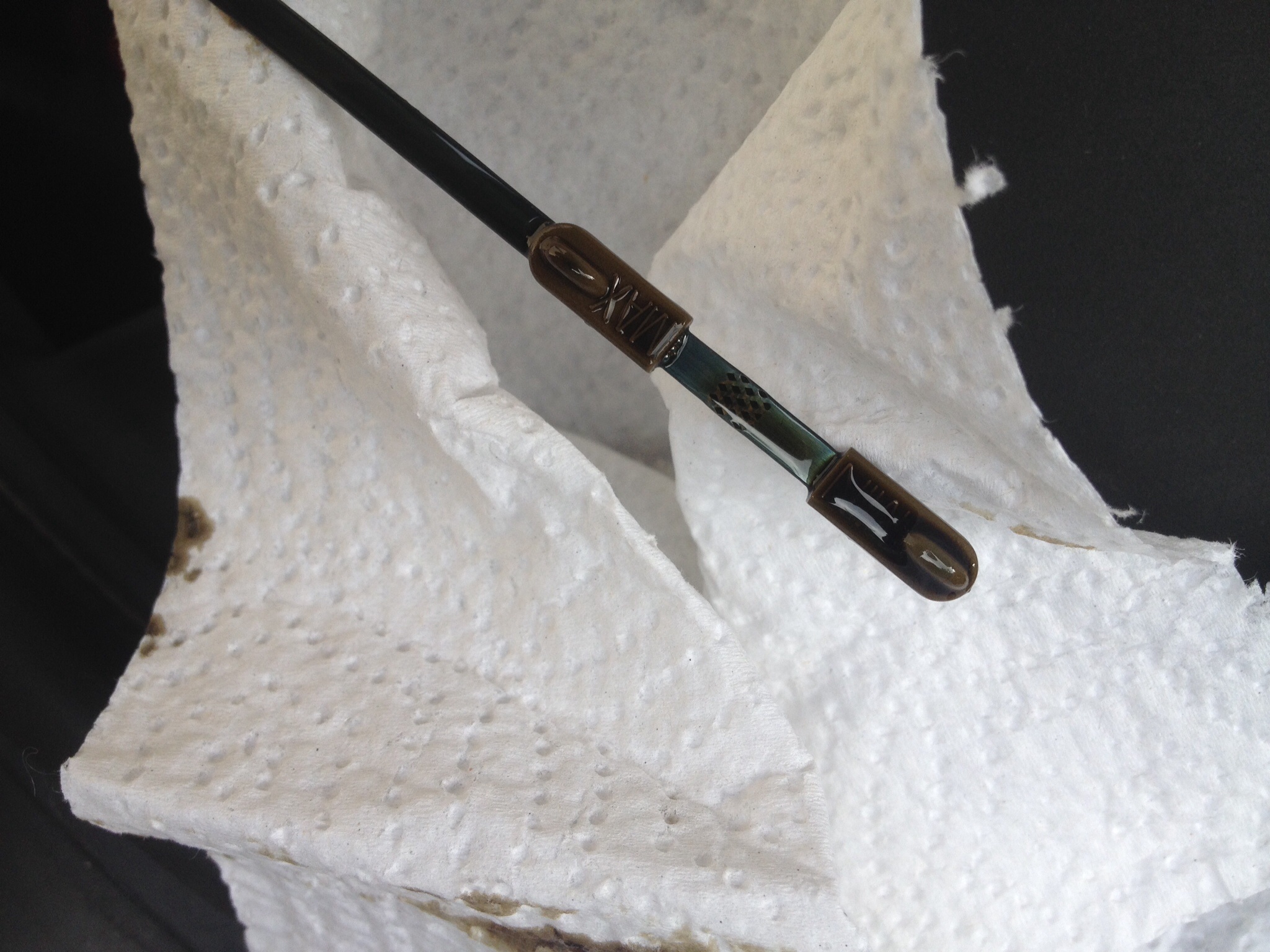

No experience of that dealer, but new oil shouldn't be black at all. In fact, 5k miles + on oil and it should still be golden basically. When was it apparently changed? Given the price of oil (castrol Edge presumably?) at £120 or so for the oil alone, you'd hope it's been done of course. More worryingly (in the worst case) if it's NOT been changed, what else hasn't been done...
Just humour me and post a photo here of the dipstick/cloth with some oil on it

RossDagley wrote:...new oil shouldn't be black at all. In fact, 5k miles + on oil and it should still be golden basically.
I've changed my oil twice now with roughly 3K between - each time it's still pretty golden...RossDagley wrote:Just humour me and post a photo here of the dipstick/cloth with some oil on it
Post some photos of the stick or if I really wanted to be sure, I'd whip the oil filter out (http://www.euroaddiction.net/forum/b7-r ... hange.html) to see the state of that... good luck.

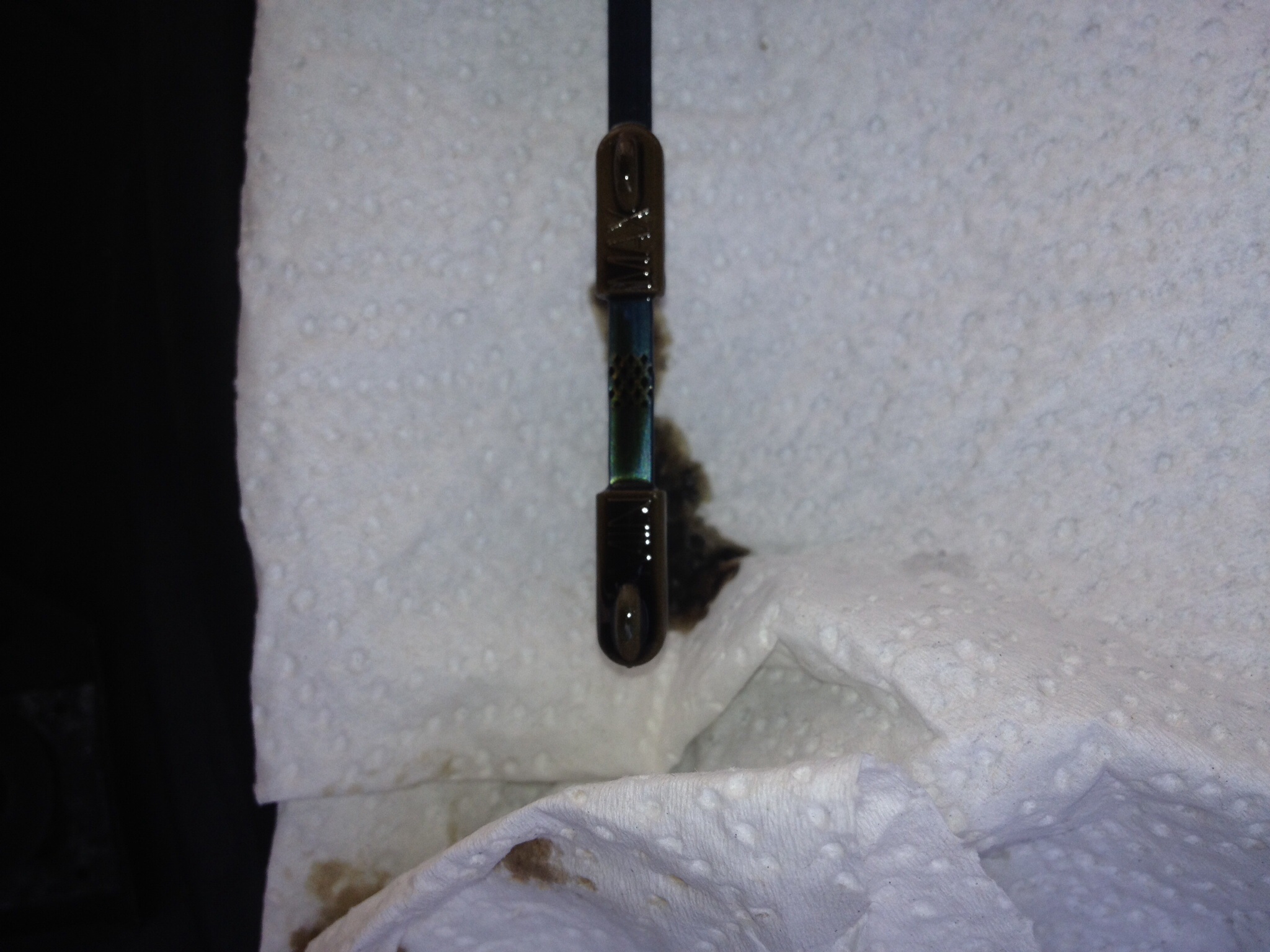

Here's a pic of the dip stick after a 5 min drive.

Re: Service and customer service Worthing Audi
Ian, nice sharp photos and that's a difficult one.
The oil has some transparency, and equally I imagined it to be deep black. Is the car on longlife or service interval? Nearly 10 ltrs of oil in the engine; there's plenty of oppurtunity for any residual to be mixed with the new and looking at pic 2, the top of the dipstick shows signs of newish oil.
If you've changed the oil regularly then it may be a bit more golden - hard to say. My oil took two changes to clear. Running oil through as previously mentioned then flushing and replacing will easily help clear out the old.
I'm wondering if there old residual oil is so dark, it's mixed with the new and this is the result. When was the last change?

i agree the oil was changed and has the old oil remnants entrained inside , maybe it wasnt left long enough draining or hot enough to drain off as much as possible as i stated previouslyneilparf wrote:Ian, nice sharp photos and that's a difficult one.

I agree. I think it has been changed, but temp and drain time hasn't been that optimum to get the last drop out. I think the next change would see a better colour possibly. I kind of change mine every 5/6k and only now does the stick dip clear...rwilsonrs4 wrote:i agree the oil was changed and has the old oil remnants entrained inside , maybe it wasnt left long enough draining or hot enough to drain off as much as possible as i stated previouslyneilparf wrote:Ian, nice sharp photos and that's a difficult one.
