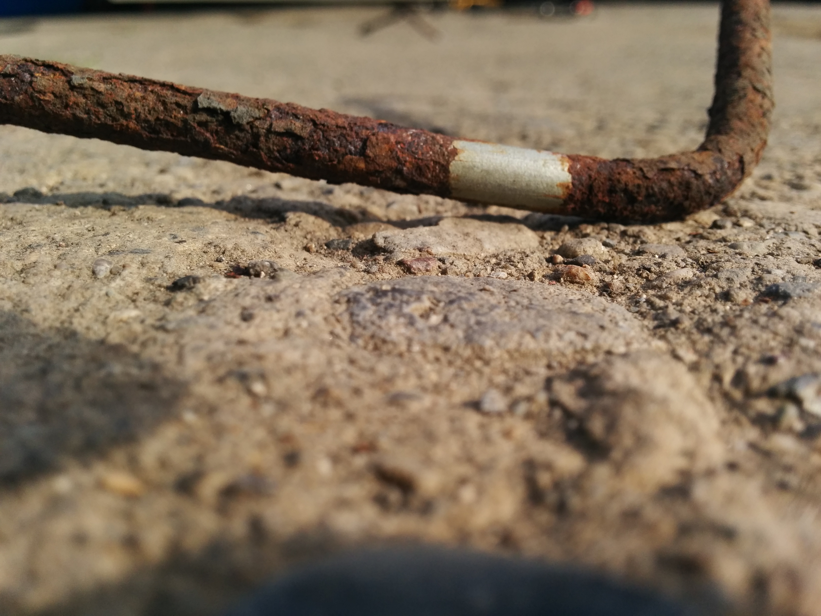

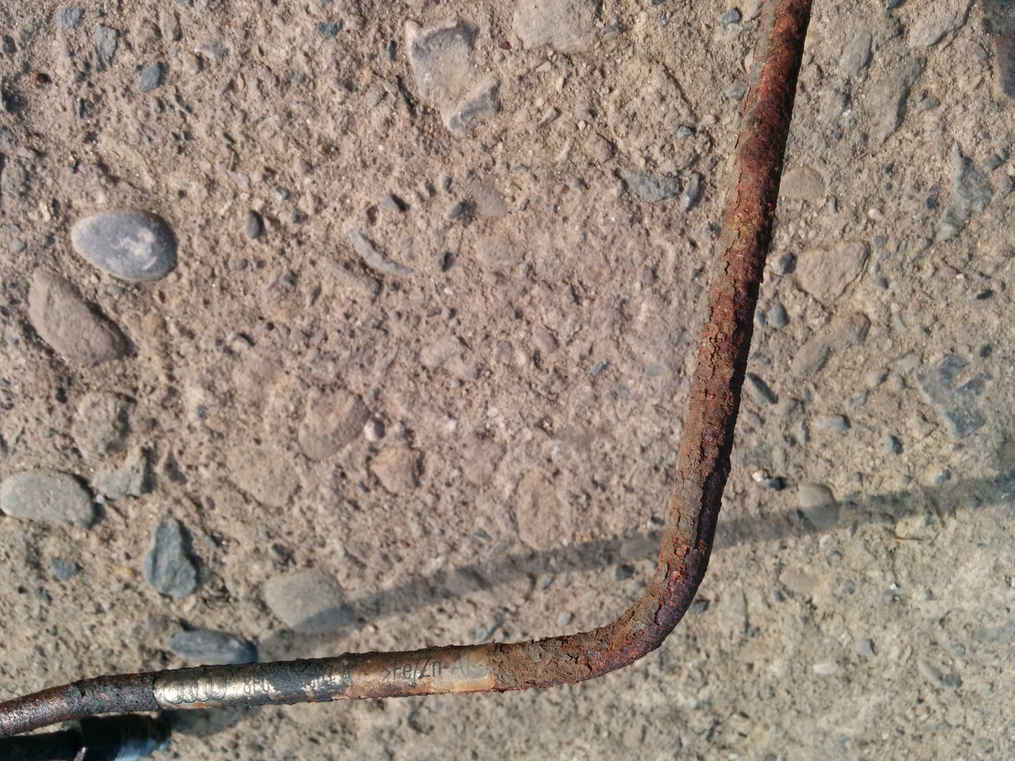

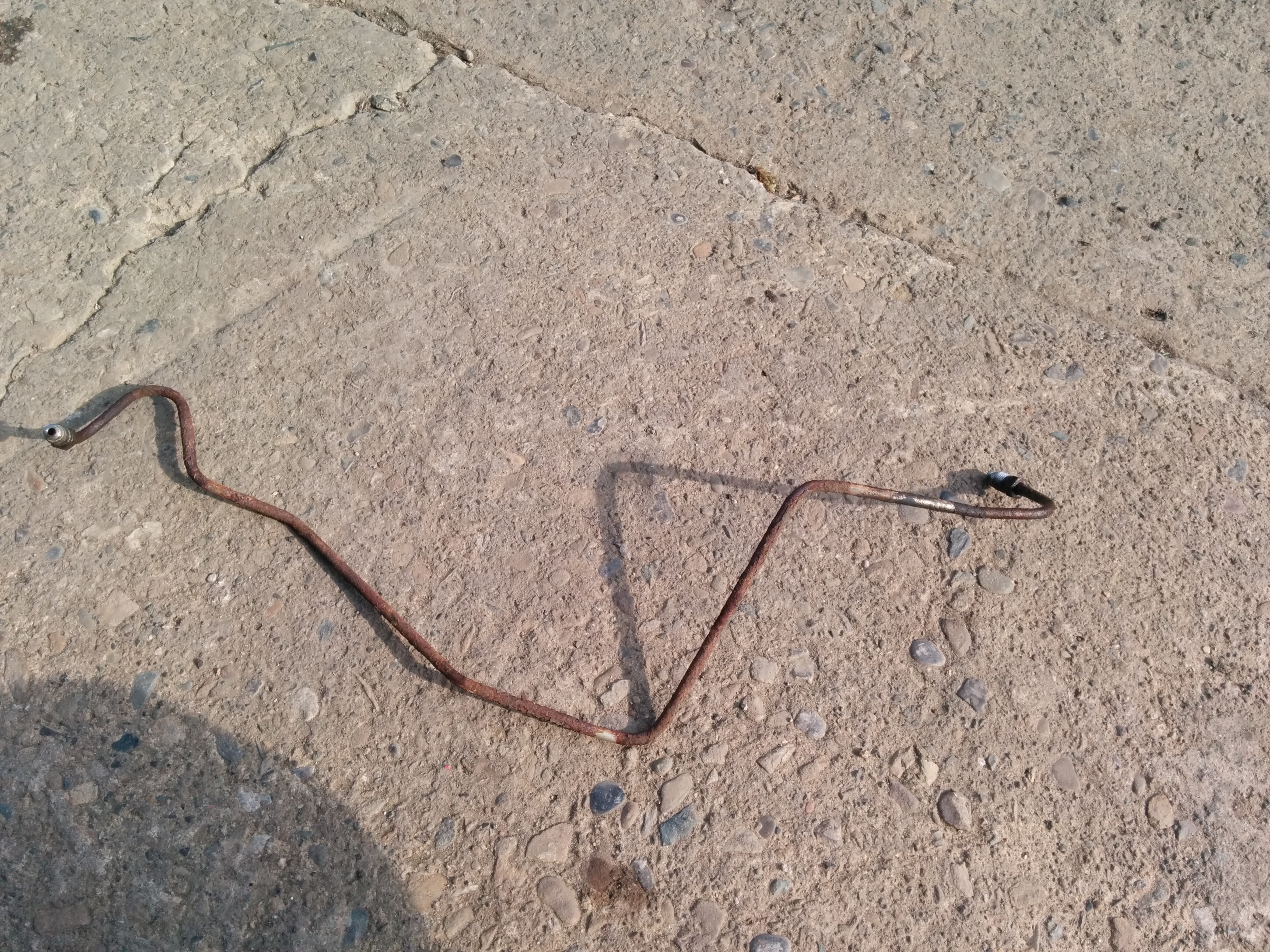

i mentioned earlier in the thread about suffering from rotten pipes, just thought i would share this pic.
this was one of the better condition pipes on my car, this one hadn't split...yet.

Wow that looks like the car sat in salt water to do that.
What pipe is it, need to look at mine?
