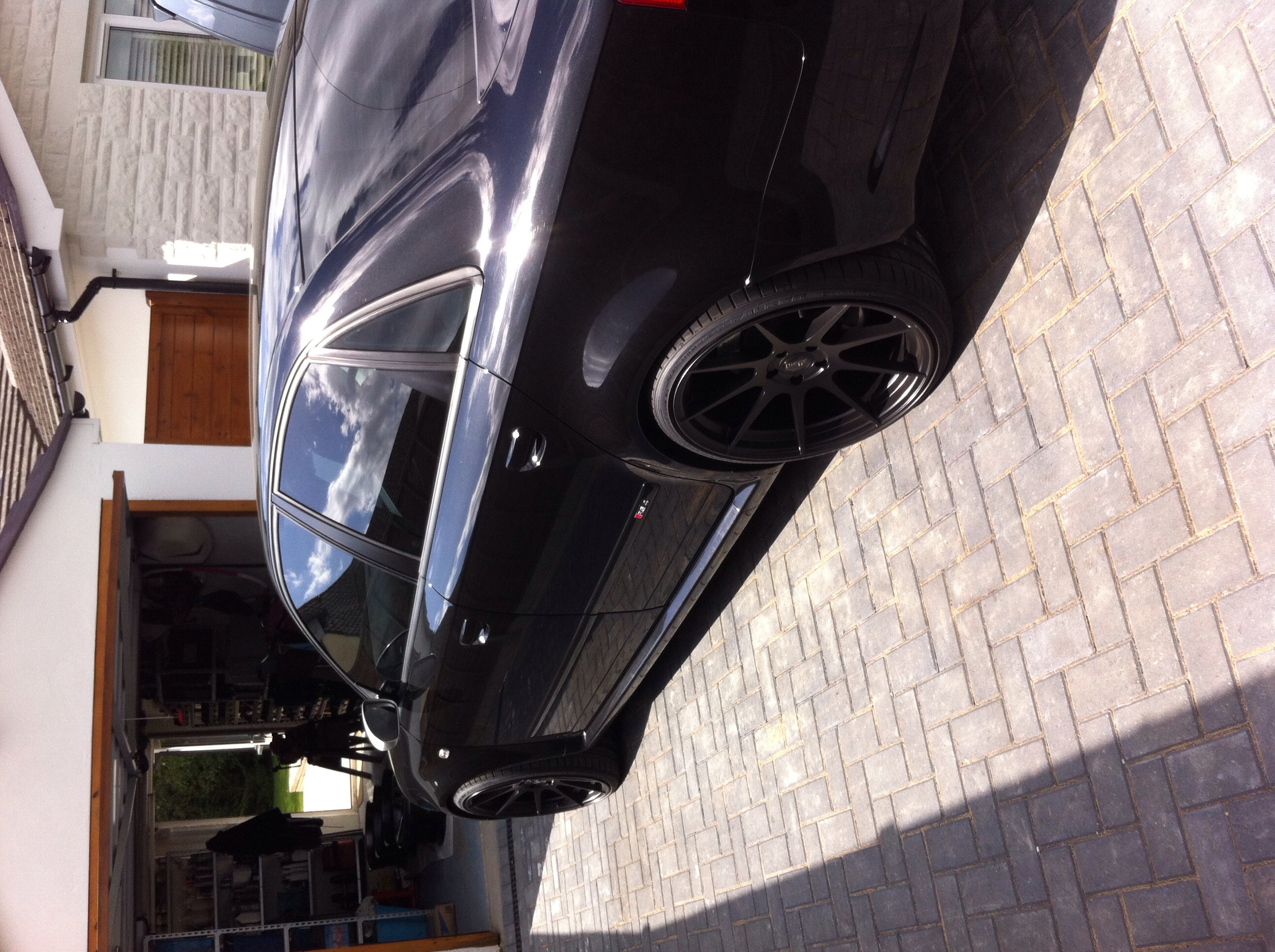

Mike fish sorry to hear your not keen on the wheels. May be this pic helps shows the concave off

T5svw wrote: Mike fish sorry to hear your not keen on the wheels. May be this pic helps shows the concave off
The concave on the front wheels looks nice and I love dark coloured wheels but still not a fan of the style. I've seen others in here rave about similar wheels so I guess it's just me.
Do you have spacers on those wheels or have they got a low offset (or maybe they are crazy wide)? That front wheel is sticking out quite a bit! Do you find the wheels rub at all?

Post by T5svw » Tue May 27, 2014 10:05 pm
Wheels are 20x10 so very wide 12mm spacers all round. The only time it rubs is with 4 adults in the car. I have spent a lot of time getting the camber set up correctly. Luckily I have a mate in the tyre trade his company has the hunter alignment system. Thinking of changing the colour of the wheels. Maybe they will look better After that. Got the car with all the mods I just have sorted them out. First time owning an Audi always had vw golfs, MK 1 mainly. Used to fit 16v tall blocks in. They when like go carts. Now have T5 van and the RS.
