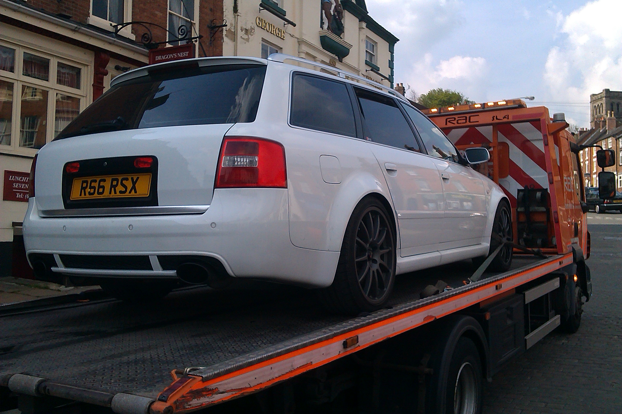

Anyway, the day ended with a lift home from a friendly RAC chap with a flat bed truck :drink:
