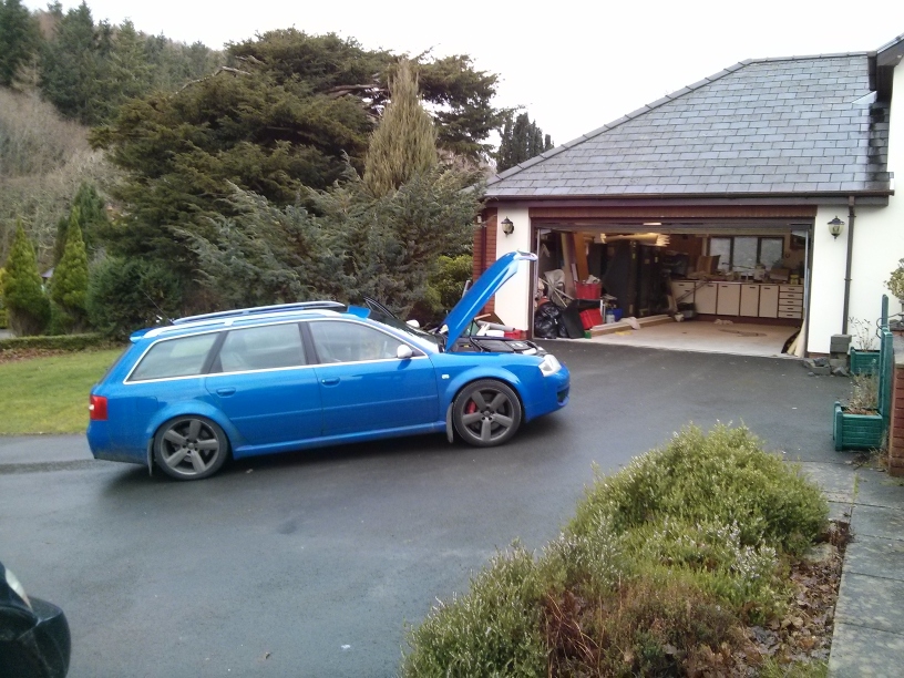

Hi all! So I have the dreaded water in the footwell problem. The rear footwell must have had a good 2 inches deep or water and the front one is only damp on the left hand side. We have just moved house and the car has been parked on the drive which has an incline. Not sure if this would cause it though, I've attached a piccy to show? Have had a good search and found it could be the pollen filter, blocked drain holes in the scuttle area, aircon funnel or rear washer. It's not the rear washer as it's clean water and today took the pollen filter out and checked housing and it's all bone dry. Ran the hose over the car and checked the scuttle drains and they seem fine too so I'm left with the aircon drain tube thingy.. What's the best way to get the carpet up without f'ing it up? Any other things to check for?
