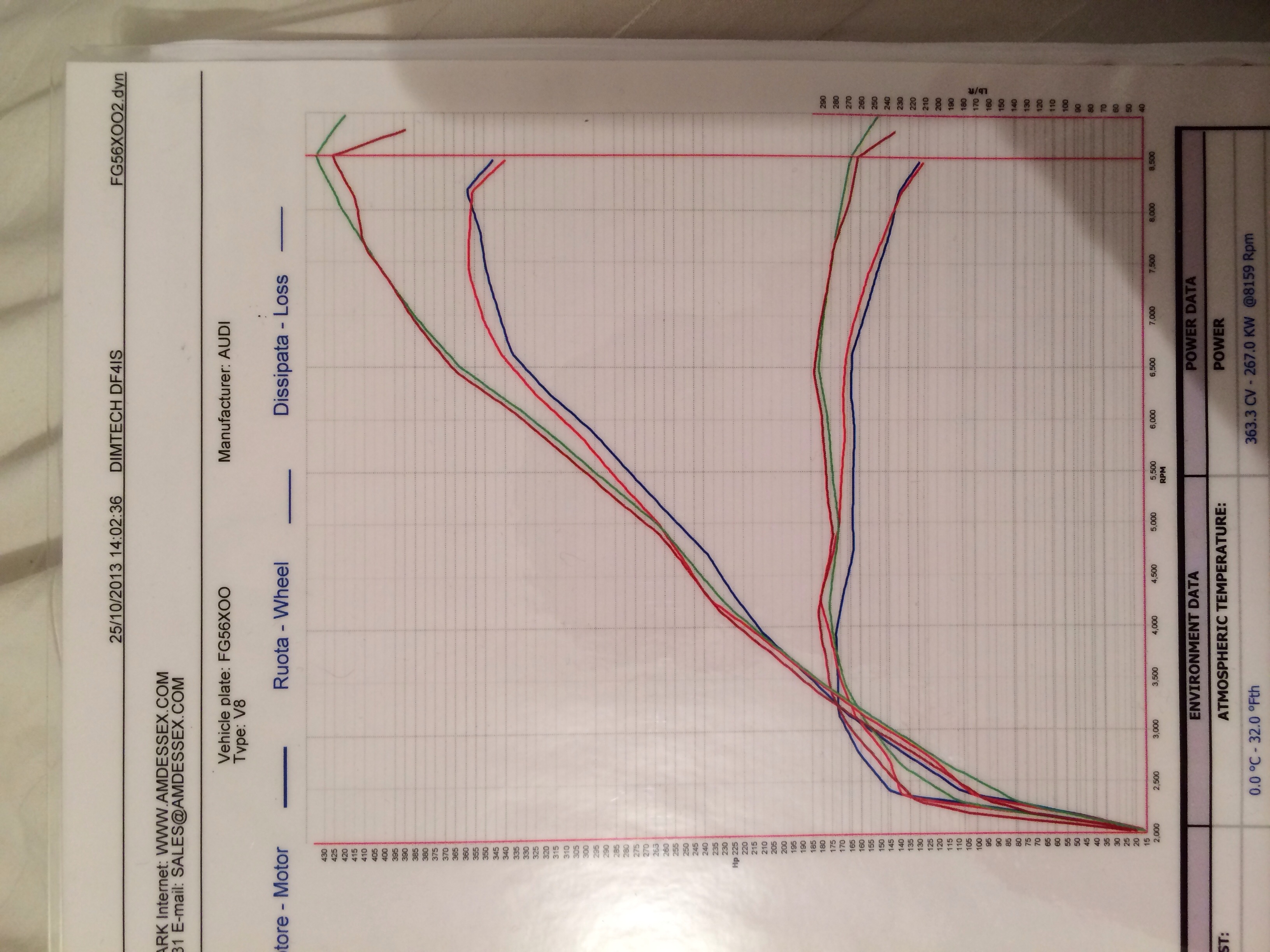

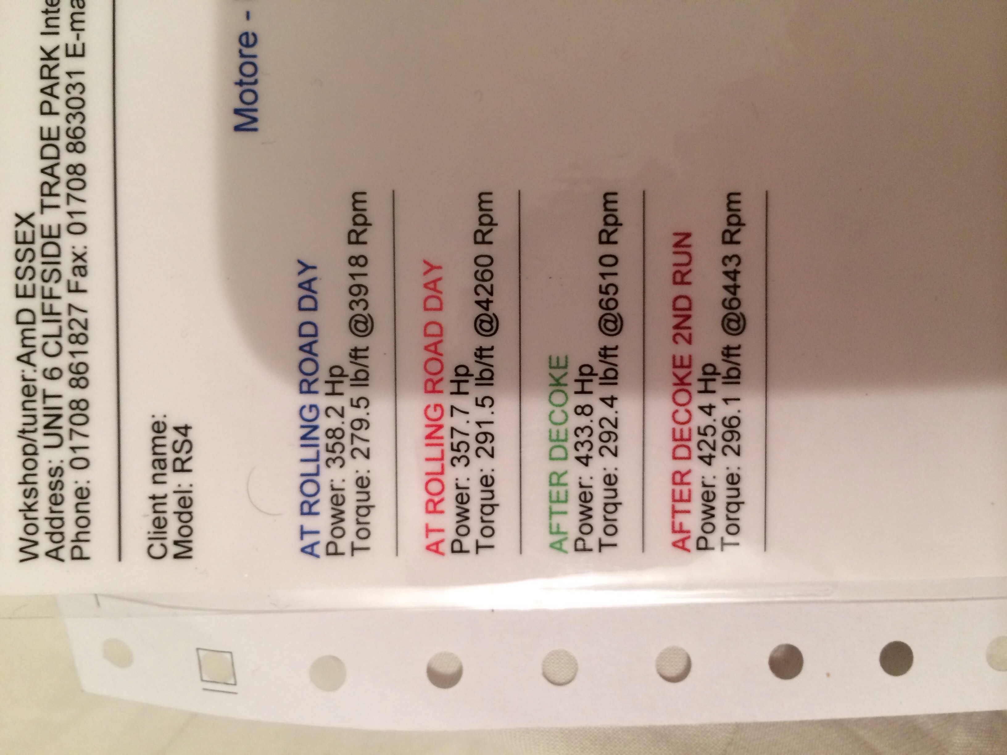

Just an update after leaving the car with AMD for the week after Sunday's rr day.
No vac leak or any other problem found whilst in their possession, so a 65 hp increase after a carbon clean. Not sure if this is actually possible with just the clean alone, maybe a vac leak was fixed whilst putting the car back together after cc.
It also raises the questions at how accurate the figures were on Sunday as it was mentioned that it was a bit toasty in there whilst they were running (especially for the later pm runners) Still... I'm please with 433.8BHP.
Would be nice to see any other graphs to compare as my peak torque figures were achieved at around 4000rpm on Sunday and in comparison at 6500rpm today.

Good figures fella..like you not sure you can get them gains from a de-coke alone....don't know about you but that is quite a difference between runs 1 and 2 after the de-coke...maybe the carbon returns quicker than we thought...
Will get my print out out and compare torque levels...

+1scaghead wrote:Good figures fella..like you not sure you can get them gains from a de-coke alone....don't know about you but that is quite a difference between runs 1 and 2 after the de-coke...maybe the carbon returns quicker than we thought...

Cheers Jay.scaghead wrote:Good figures fella..like you not sure you can get them gains from a de-coke alone....don't know about you but that is quite a difference between runs 1 and 2 after the de-coke...maybe the carbon returns quicker than we thought...
Good to meet you last week fella..the car looked stunning...
Nice to meet you and your immaculate sprint saloon which must have been teleported to AMD to be that clean.
Apparently run 1 is normally (not always) slightly better as heat kicks in for run 2. But at this rate of lose I will be at 250hp by fireworks night.
