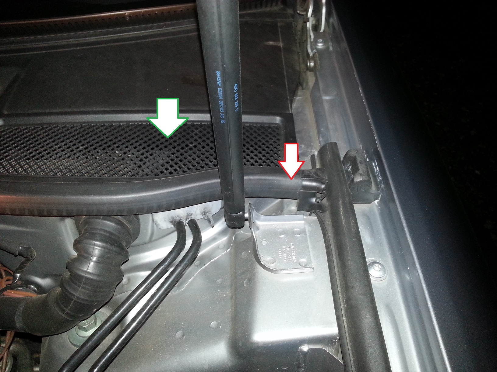

First, be sure its the pollen filter housing that's causing the problem !
Does your rear washer jet work OK ? , there's joins in the pipe that could also be the cause of your problem .
One of the joins is down by the passenger footwell/A pillar.
For the pollen filter you dont need to remove the coolant header bottle.
Just lift the bonnet , peel back the rubber strip ( Red arrow in picture below) , then lift and pull forward the plastic grill/cover ( Green arrow) and the filter is underneath on the right hand side as you look from the front of the car.
Its usually the crap and debri build up around the drain hole that lets the water rise and seep thru the sponge gasket that sits between the body and filter housing
The chances are its squashed and warped, so you may want to get a new one before you start, as no doubt it will get destroyed when you remove the filter housing.
You 'could' make your own up and use lots of non-drying sealer as well to replace the sponge with.
The full width plastic panel is located onto the slotted plastic cover ( along bottom edge of windscreen) at the back by 3 locating lugs ( IIRC).
I cant remember on a 6 , but you may need to remove the filter housing to get to the drain hole on the passenger side in the corner.
pour water onto the drain and see where any water comes out behind the wing . it may be possible to back flush it with a hose pipe. You don't want to force any debri further down the drain though.
clean the surrounding area where water can sit before replacing the filter housing, you could even polish it to aid water running off the area.
There's a sponge gasket that goes between the filter housing and bodywork , this is the part that lets the water into the cars inside.
The price isnt to bad considering its from a main dealer , as I had to pay £200 + vat for a recon one for my passat 3 years ago
