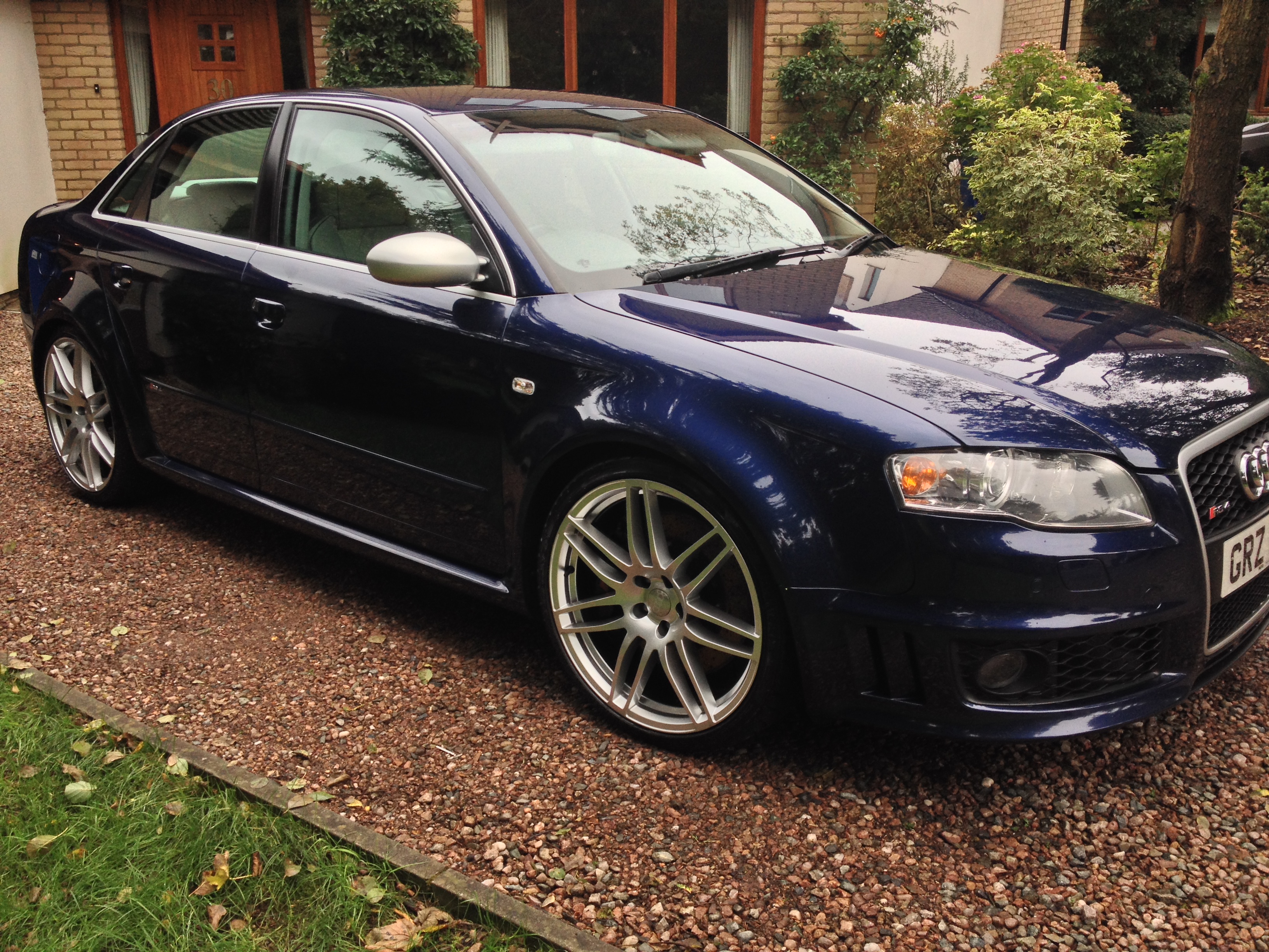

Photo included below for good order.
My RS 4

The TPMS warning is possibly down to the wheels. Looking at the picture you've posted, the rims are fitted with standard rubber valves whereas the TPMS valves stems are made from metal, so it's probable that the rims don't have any sensors fitted and the car will throw the TPMS light because of that. You can deactivate the TPMS warning system using VCDS software and a suitable cable, although if you plan on keeping those rims I'd suggest doing that, and adding some spacers which it's in dire need of as the wheel offset looks wrong.

Those wheels look like after market copies?
