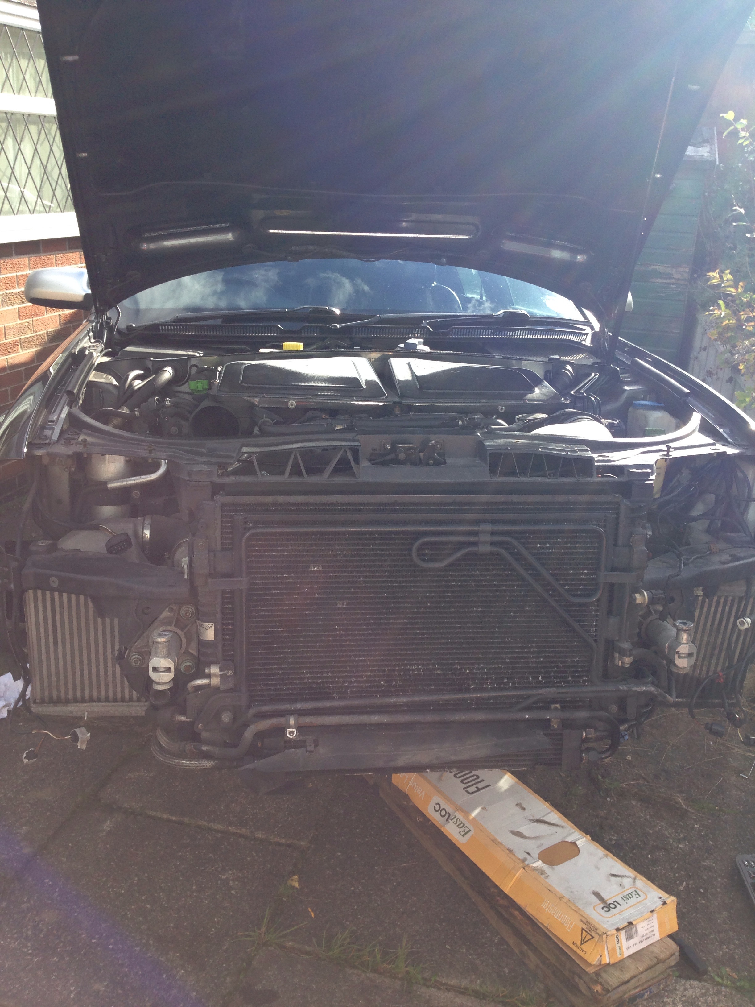

Hi there, yes issues. We'll, let's start at the beginning
Pas leak, oil leak, coolant leak, airbag light, Econ light stuck on, possible leaking intercooler, reverse sensors knackered, cam belt needs replacing, aux belt too and a much needed major service, oh and a wonky headlight. Other than that, she's a real dream.

What was your power steering leak? Was it the rack? That's meant to be a lovely job to do!
Re: New to the forum, not so new to ownership.
It was one of the banjo bolts on the rack. Audi seem to use aluminium washers that had corroded. I put some copper ones in, flushed the system and it seems to have done the trick.
