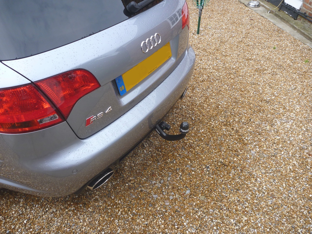

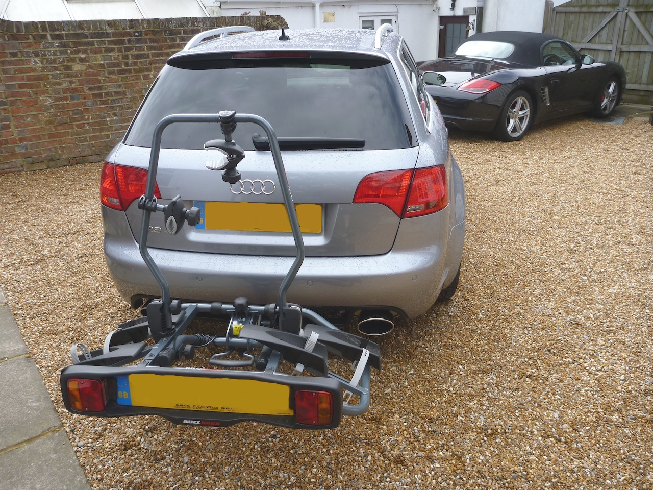

It's not "illegal", no. There are rumours about it not being possible due to cooling or some such, but even Audi technicians I've spoken to don't think that's true - bottom line it was simply never homologated by Audi, hence there's no Audi part available, hence you'll not find a towbar company that will fit one, because they have to follow what the manufacturers recommend - if it's not homologated, they won't do it.
A bar for a standard B7 quattro fits perfectly. The RS4 exhaust doesn't cause any problems at all - the bar goes nowhere near the 'zorst. The only practical issue is a slight mod to the lower trim panel in the RS bumper - see below.
This topic comes up occasionally and the question about insurance invariably comes up, and yes, it's a good point and one to be aware of. However, mine is declared as a modification on my insurance, and it was insured on that basis, so I simply don't see how an insurer could successfully argue against it in the event of a claim. The principle of non manufacturer approved modifications voiding insurance would be worrying for anyone that's fitted, say, 20" wheels, spacers, CAFs etc etc... so that would be the majority of people on here!
