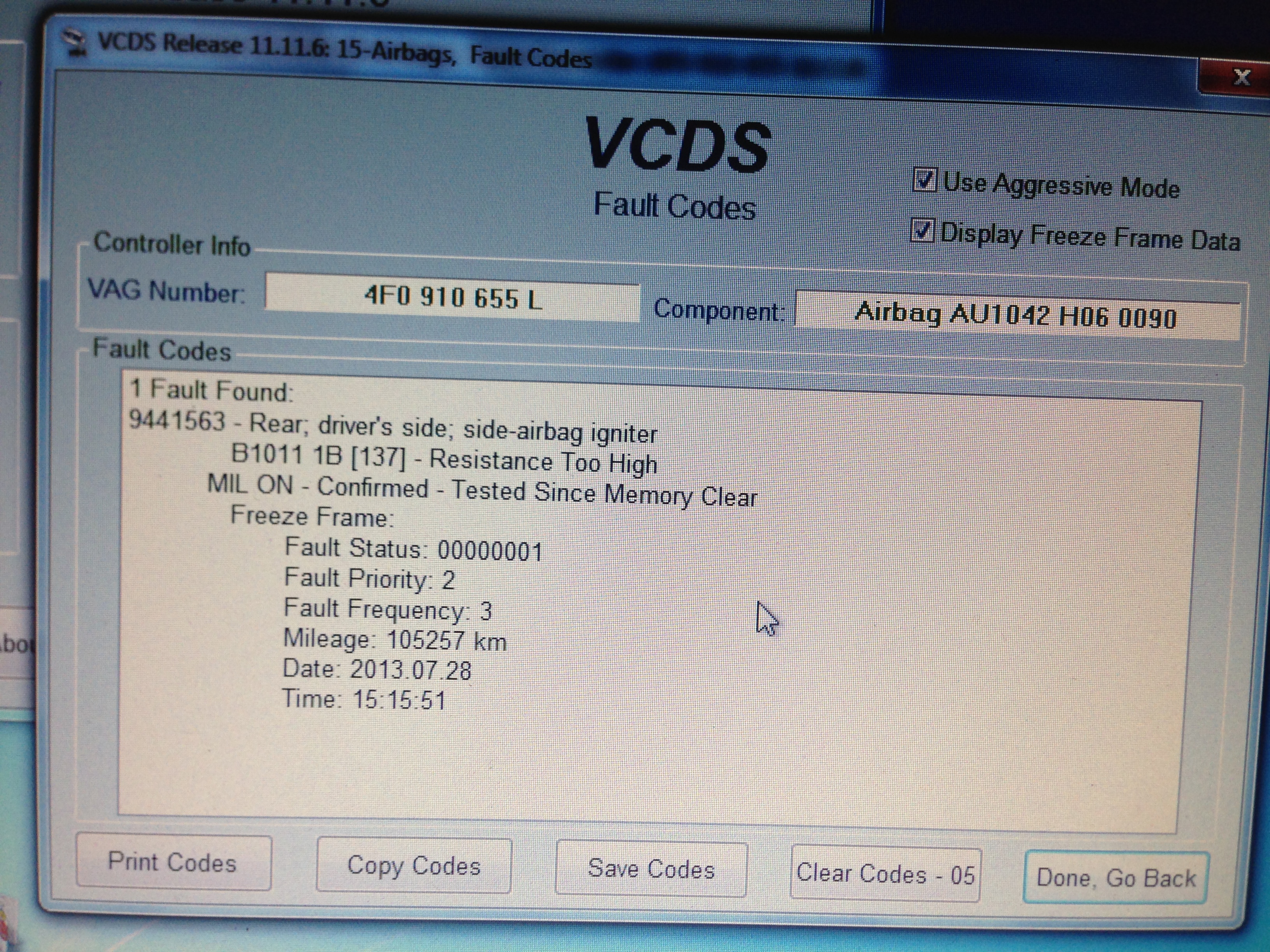

Quick up date... I have managed to get a genuine Ross-Tech VCDS cable..... I downloaded the software last night and instructions. Will check it out tonight on the car.... will also look at the VIM

Post by Haggizbasher » Wed Aug 07, 2013 8:01 am
Plugged in the VCDS cable last night and tried to clear the airbag fault but it kept coming back......did some research on the net and it could be a faulty connector/loose connection. Some of the guys that have experienced the fault have removed the connector and spliced the wires... with success and the fault cleared. I need to remove the back seat to get at the connector and check it out.....just to need to figure how to remove the seats.....

Post by Haggizbasher » Fri Sep 27, 2013 8:36 pm
Update, did some searching on the net and it appears that the connector in the rear for the airbag can cause the airbag light to stay on ( could not re-set with the VCDS) Removed the rear seat, located connector, not a lot to play with. Cut the connector and spliced the wires together.......put the seats back, plugged in VCDS and reset fault.....success...!

Golfather
Posts: 3033
Location: Berks
Re: Air Bag fault
Post by Golfather » Sat Sep 28, 2013 12:44 pm
Nice one!
Yes common prob on early C6's. Think they redesigned the connector on later ones.
Some have fixed it by just using electrical contact cleaner.
