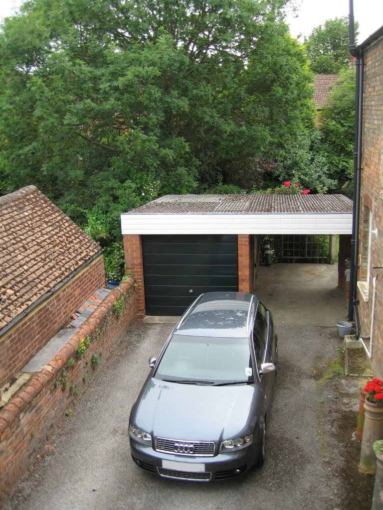

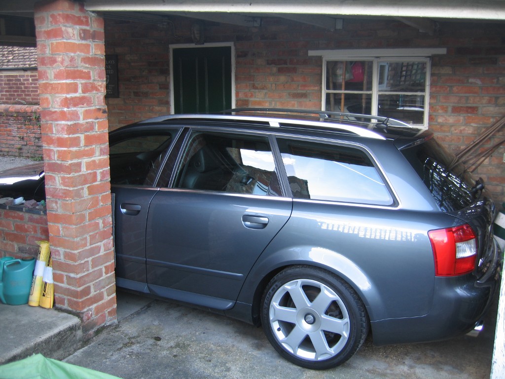

What you put in totally depends on the space you have. There are endless factors. I've been mulling over options hypothetically for a similar Victorian project house nearby to the one I'm currently living in pictured below
If you go for a garage........ You won't want a garage facing up a slope otherwise it will have water coming under the door during a summer downpour. Do you want to be able to see the garage door from the house for security? If you go for an electric door, you will want to watch the door close before you leave. An RS6 is a long car, a standard 5m garage won't be long enough. Side access, do you want to have to get the car out each time you want to mow the lawn / get your push bike out etc? A standard garage door is 6'9, again I'd go for a wider door and a wider internal garage width if you can etc etc
If you go for a car port........ Nice and sheltered up against the side of a house. You can park a second car in front so the RS6 is blocked in and invisible from the road. If not, can you built it up against the boundary and change 5m of wooden fence or lower height wall for a brick wall to make up one side of the car port for some shelter? You don't have to reverse straight backwards into it - you can reverse into it like a parallel car parking space. Even if the roof is over six foot high, nothing stops you putting lower sides on it to keep it more snug. It doesn't even need to be six foot where you drive under - only where you walk under. If its properly sheltered you can have covered electric points
http://i.ebayimg.com/00/$%28KGrHqYOKkQE ... 8800004005
http://ecx.images-amazon.com/images/I/4 ... SX300_.jpg
We are very fortunate with our 1894 Victorian house to have side driveway access and *just* enough width to fit a car port and a garage side-by-side of the house at the back - obviously built at a much later date. The car port is walk through and gives rear access to the garden. The back door opens into the car port, great for unloading shopping, taking shoes off in winter time, when I'm mucky after cycling etc
I'm no expect when it comes to planning permission, but I *cannot* imagine you'd be able to put up our ensemble without paperwork!
