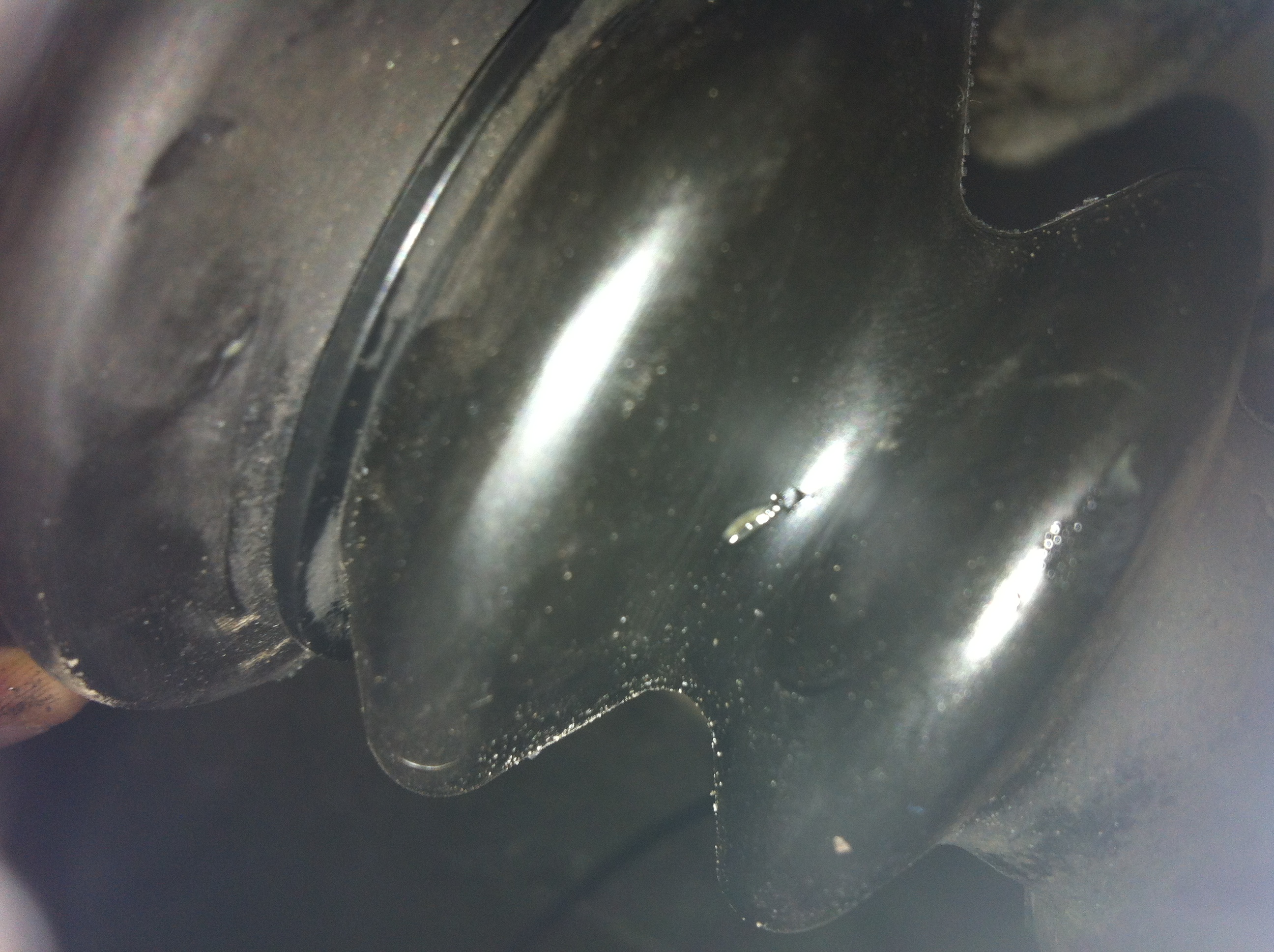

Re: Clunking noise ...
...i know mine are shot, but was wandering if clunking is coming from inside the shock...

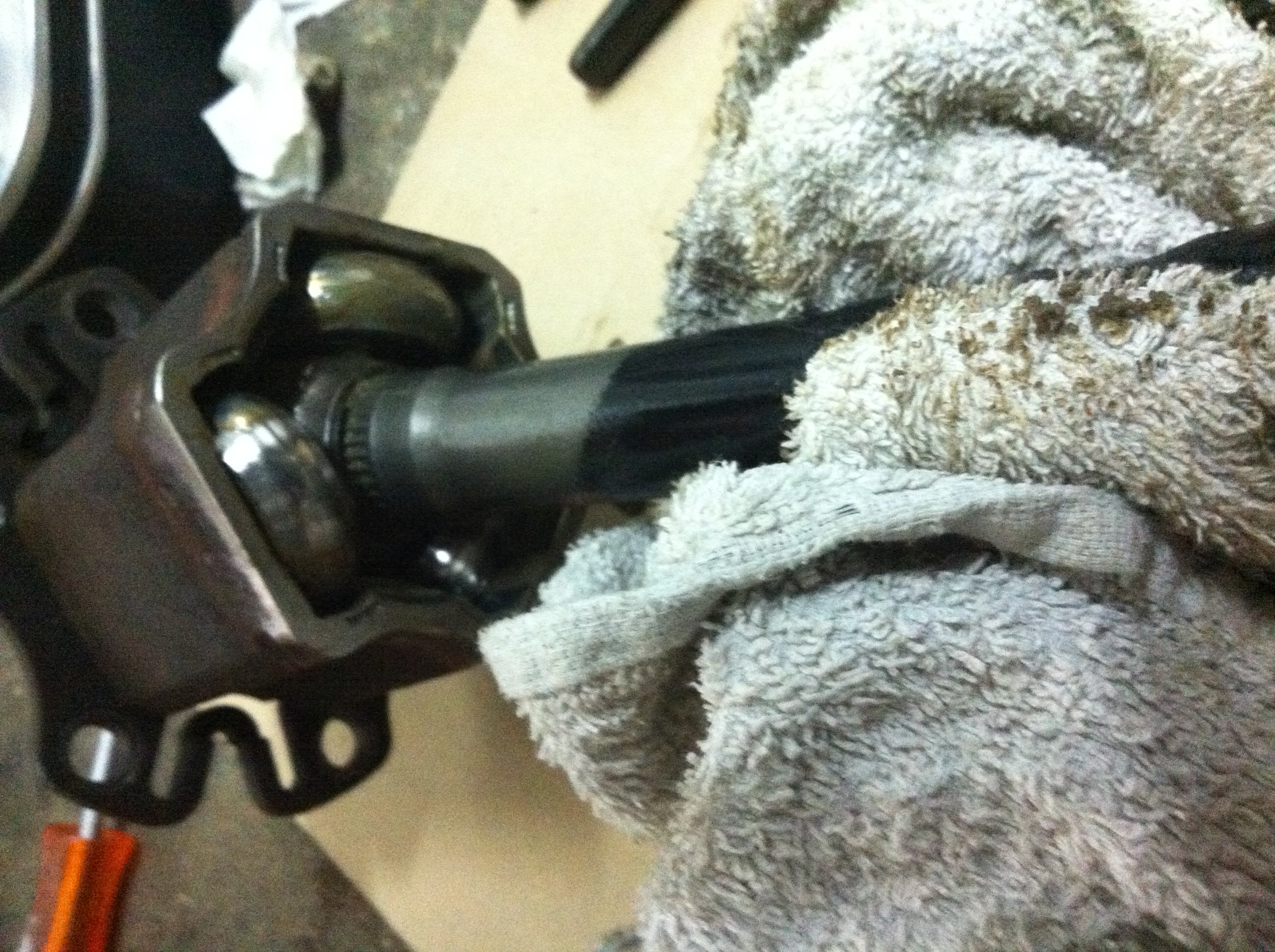

...found out my inner cv boot is shot too, got a new one, but it seems i have to remove the outer one first to get the new one on...

Would be funny, now theres fresh grease in the inner cv joint, the clunking is gone
(cos the old grease was like grey/green yoghurt...)

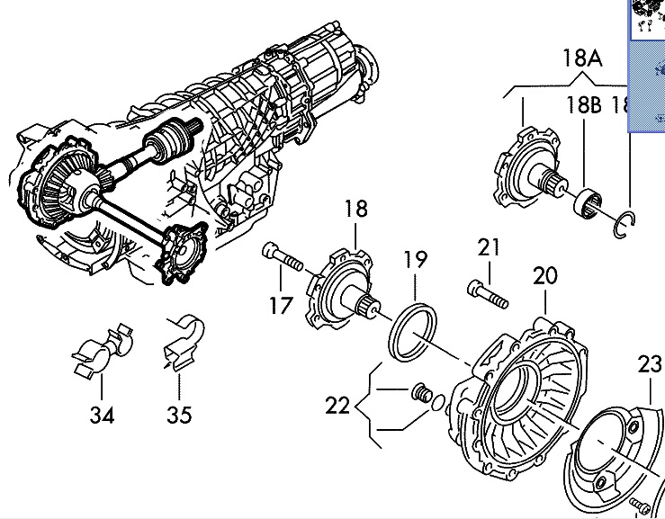

think nr 22 would be replaced to, but ETKA hasnt got a part nr...
found it:mavada wrote:think nr 22 would be replaced to, but ETKA hasnt got a part nr...
01V 409 057

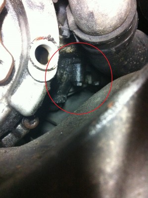

...found some greasy/oil covered part here, but dont know exactly what part it is and if its something to have a look at/worrie about...
