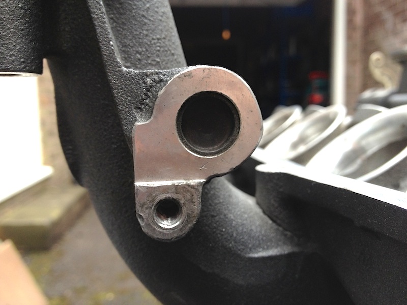

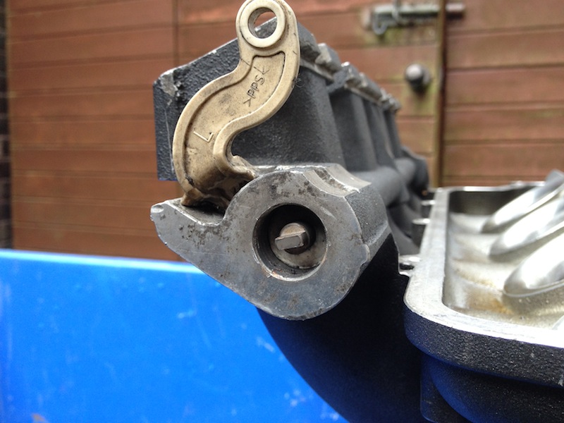

Just posting some photos of the ends of the shaft. One side has the slotted bit each end and the other side has one slotted end and some sort of cap (first picture).

Re: How to remove manifold link arms?
slotted ends look like position sensor mounts - I'd be surprised if it was around there.
Doubt it would unscrew as the arms must be mounted somehow. I would expect turning it would break the arms.
What about pair of pliers on the slot and pulling?
I think if you gently tap on the opposite end to the actuating arm, the shaft should drift out.
Cheers chaps, will give it a try tonight.
hrm, gently tapping didn't work. Don't want to give it too much welly in case I damage bearings/seals :/

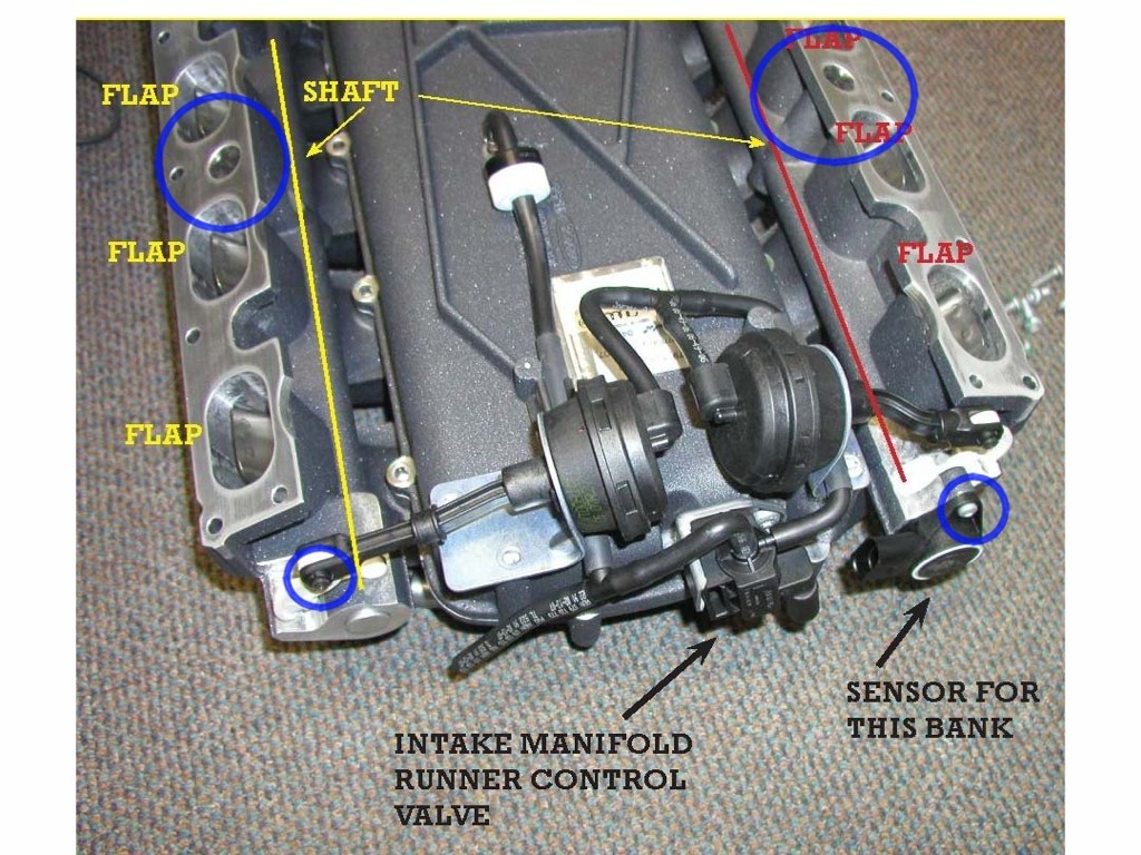

There are black tab things that line the shaft up.
They pull straight out.
Circled in blue..
Circled in blue..
billq - you utter hero!
For anyone else in future, pull the black plugs out and tap gently on the shaft towards the flap end.
