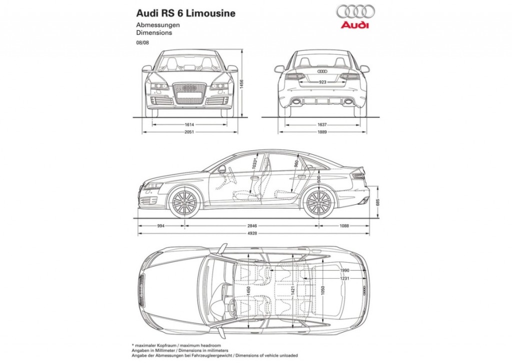

This might help.
Fifeaudi
Posts: 71
Joined: Sun May 12, 2013 10:06 pm
Location: Fife, Scotland
Re: The C6 RS6 Pic Thread for Everyone
Post by Fifeaudi » Mon Jun 03, 2013 7:46 pm
When she was in getting detailed the car was on jacks and all 4 wheels were off the ground for 4 days, had the car away all weekend loaded with camping gear and it does seem better now, will get it on some flat ground tomorrow, cheers for the diagram

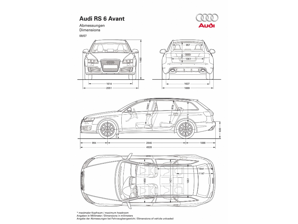

Does anyone have the loon version though, they must be different surely?

Which obviously is not a good thing, i took car to star performance up here in fife for a check over when i first bought it, and they found nothing wrong, just need to know or see the gap between wheel and arch on others rs6's can anyone help

Try this... might help a bit.

Thats the one classba
Many thanks, check that out tomorrow,

The wheel/arch gap do look a bit too much yet from so angles, it looks ok. It may need a bit more time for all fours to settle after being raised for so long.
Check all four shocks to see if the DRC are leaking and if they're not, 9/10 they should be fine and get on a level surface to measure up. Failing that, get Audi to check the DRC.
