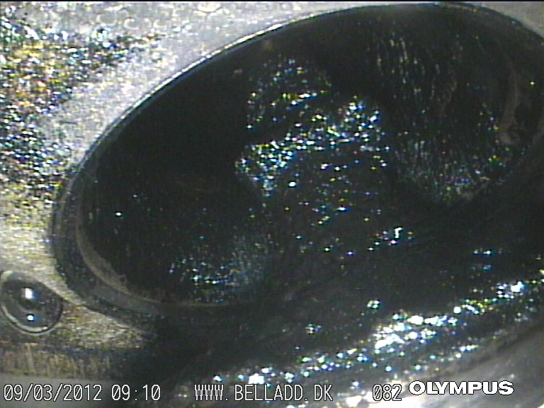

I had a boroscope inspection of my intake - this was when that car was 3 years old - i had done 80.000 km - but the engine swapped due to crack in the block at 64.000 (full AUDI warrenty - 9 pages invoice, complete engine swap
So this is after 16.000 km (car done 80.000 km)
This was done March 2012 - We did a complete carbon clean - off with the intake manifold and use bell add clening fuids and foam (+ manual work)
http://www.belladd.dk/en/SpecialRens/Cl ... skine.html
The I installed the water methanol system at the same time
This is what it looks like October 12th - 7 months and 108.000 km - = 28.000 km since the clean - remember the initial "mess" was from 16.000 km!!

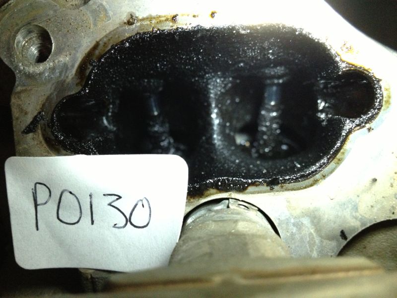

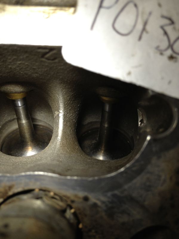

Here is a pic of what my ports looked like before and after my carbon clean.
Thanks for all that info MortenJuul and for bringing me up to speed with the Terraclean. Hmmmmm, from the sounds of it and from what I understand of the direct injection system, there is no way of it working properly, but hopefully they'll do someone elses RS4 and do some Boroscopes to show us :bowdown: .

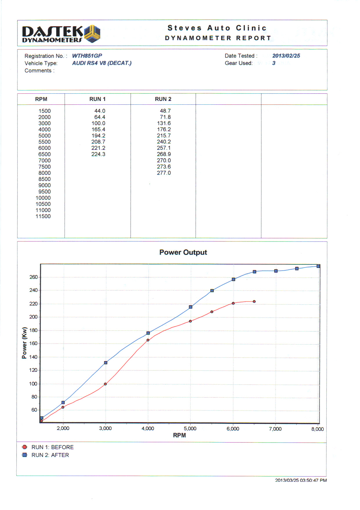

Here are my dyno graphs
This is my Dyno before and after the carbon clean. You will notice with the before graph, it only rev'd upto 6500rpm. That cause my EPC light was on and the car was in limp mode. (manifold flaps weren't working properly)

RS4_Fanatic wrote:Here are my dyno graphs
Problem is the its not a fair test - the manifold flaps can fail for lots of reasons and they completely strangle the car not just at high rpm.

Post by RS4_Fanatic » Mon Jun 03, 2013 5:56 pm
Yeah probably, but I'm still happy with the results overhaul.
