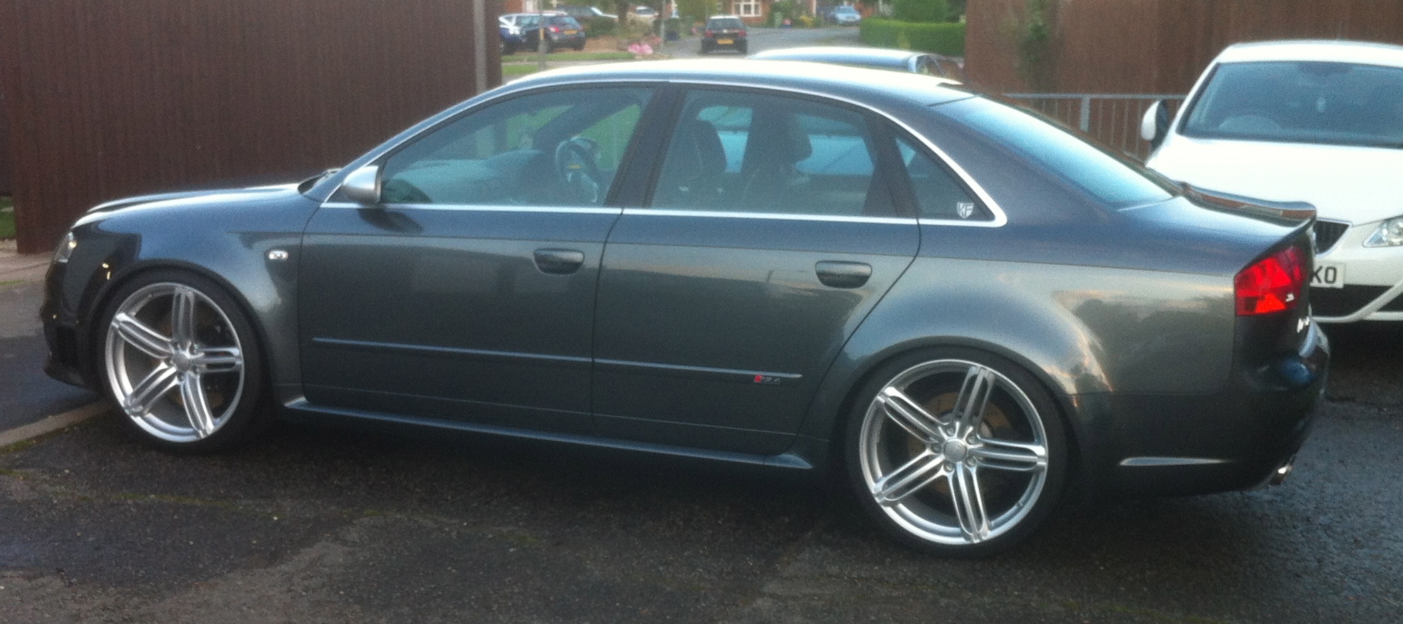

Here she is cleaned and a little lower after her trip to Unit20. Sorry for the picture quality.

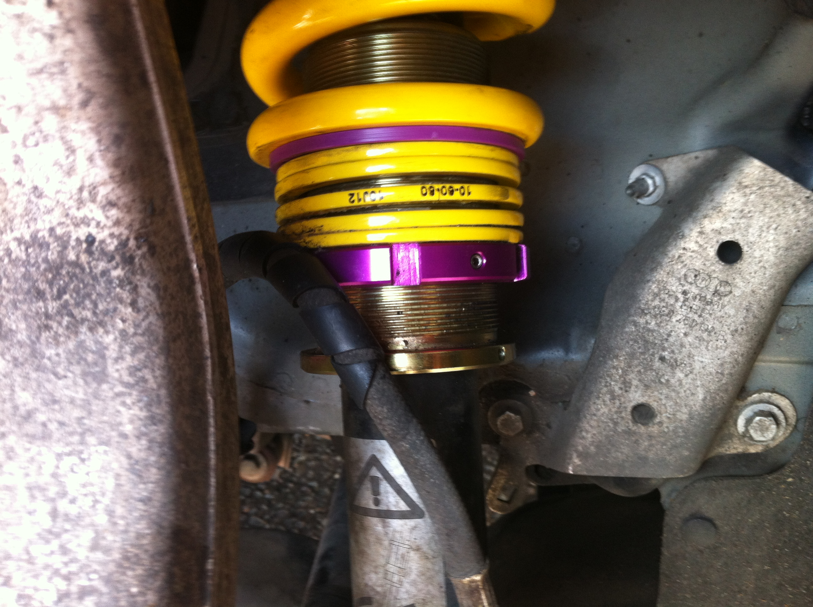

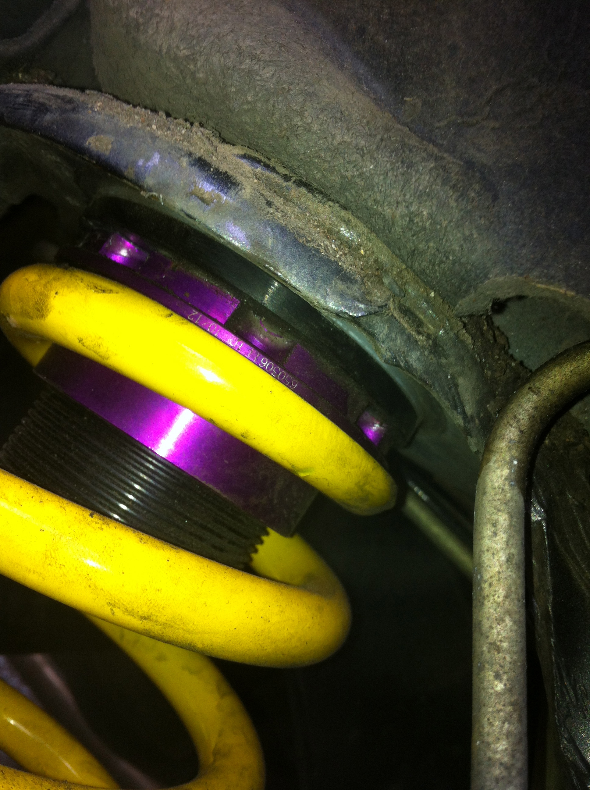

Nice one BigT. Do you know how they set that up in terms of percentage drop available ie is that half way down, 3 quarters down or as low as it will go?
Re: KW COILOVER LOWERING KITS. B7 , B8 , C6
Hi Mike, Lee at Unit 20 said that the rear is all the way down with half a turn back, regarding the front I don't have a clue but it is low, the liner screws at the top of the arch have gone for a little extra clearance.
I'll try and take some pictures for you of the front and rear adjusters to give you an idea.

Ok cool, thanks. The back looks no lower than mine is already so might just get the front done, or look at what Young Ben did to get his lower.
Hi Mike
A couple of pics of the adjusters as promised.

Looking low there BigT, the wheels really suit with the grey
great job
