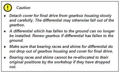

Sorry for hijacking your post, but how to determine play when the right flange is out.
Just by checking the bearings in front and behind the differential?
Came across this in Elsa...:

Lol, it's absolutely correct!
If you just unbolt the outer casing and remove it, the diff will fall out!
Re checking play in bearings or the diff: Once you have removed the output flange and diff (carefully!), bolt the flange back into the diff and inspect to see if there is any play between the flange and the diff. If not, the play must therefore be in the diff bearings and the whole diff is moving.
Obviously inspect the diff bearings also.
