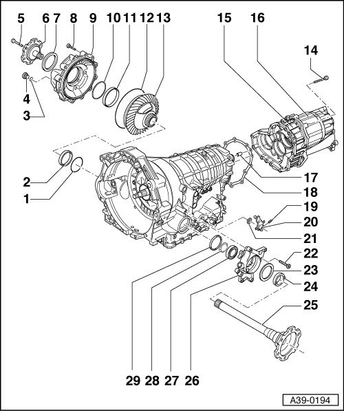

Re: Clunking noise ...
i cant believe the play is caused by the driveshaft/cv joints itself looking at the pic.
think its caused by the axle which goes into the box.
i know that axle has a bold visible when removing the inner cv joint, and see from there...?
i hope its just the bold, otherwise it could be nr 1 and 2 in the pic below (which is a common one on the passenger side ive heard)...which is more complicated and prob no diy...?
...from other forum...
I'm not sure what causes it, but I'll bet you've got a lot of play in your output flange coming from the front diff. Passenger side, correct?
Chances are that your bearing is worn (root cause or a symptom? I'm not sure) and you need to replace it along with the necessary shim that goes between the front diff case ans the outer race.
I'd recommend replacing the entire bearing, so you'd need to remove the front diff and have the inner race pulled of and then the new one pressed on. The shims start at 1mm thick and are available in increasing thicknesses by 0.1mm. I'm not sure how you measure for the correct shim thickness, so you might need to buy a few of them. Think they were like $16 each last I checked.
...was wondering how to see/feel play when nr9 has been removed to determine which bearing is shot...?
Number 2 and 11 looking at the picture, good luck with number 2 although saying that you might be lucky and get away with shimming them.
