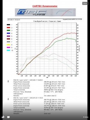

Here it is after the decoke I think its the map to do now

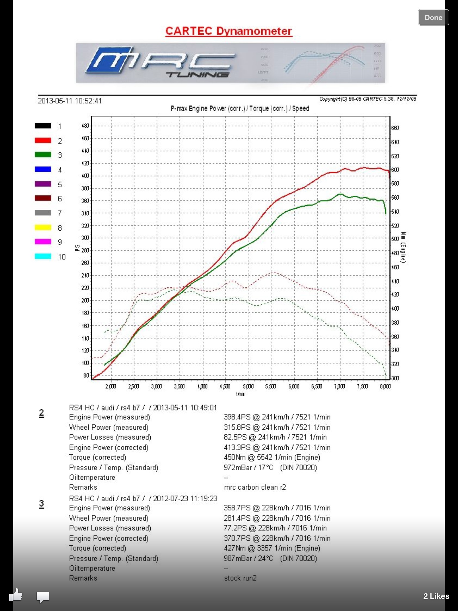

ArthurPE
Posts: 3755
Location: USA
Re: Health check at mrc 309bhp vac issues and decoke
Post by ArthurPE » Wed May 15, 2013 8:33 pm
it made 370 first run, not 309?
it now makes more torque than stock with no other mods
332 vs 317
how is that possible since the displacement and compression ratio did not change?
50 HP gain at 7500
had to be a vaccum leak based on the droop after 5000 rpm
it now makes more than rated torque from 4500 to 6200

Post by Jamiestanton » Wed May 15, 2013 8:43 pm
That other one can not be my car look at date
Myn run 309 before carbon clean and vac leacking
2006 black audi rs4 b7 mrc stage 2 stage 2 manifold de cats miltek coil overs light weight flywheel black optics 445bhp 470nm
ArthurPE
Posts: 3755
Location: USA
Post by ArthurPE » Wed May 15, 2013 8:46 pm
Jamiestanton wrote:That other one can not be my car look at date
good point
and the after is dated 4 days ago, not today
