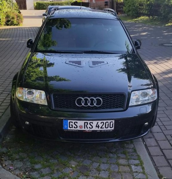

all in all, the Sportec vent mod is by far the most easy/cheap mod you can do really, the amount of heat going through it is huge (heard of one wanting to know if it really works: he couldnt hold his hand more then 30 seconds cos of the air coming out, and thats while at a standstill, let alone while driving and more air gets drawn out of the engine bay.
What keeps me from doing it is the risk of dirt/animals going in...
