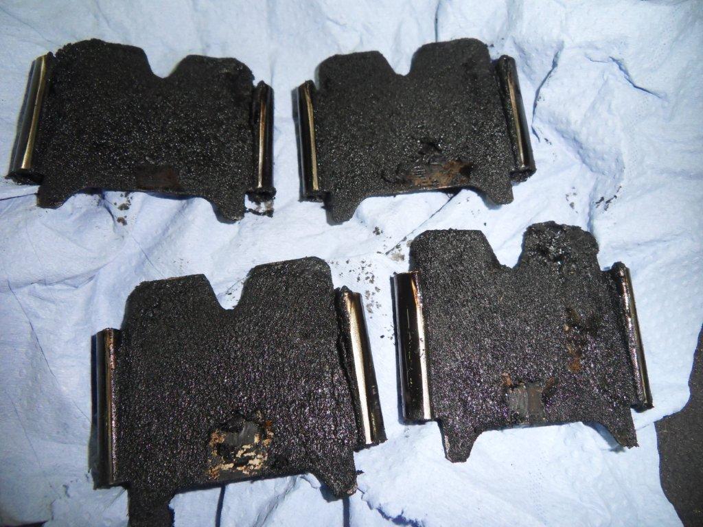

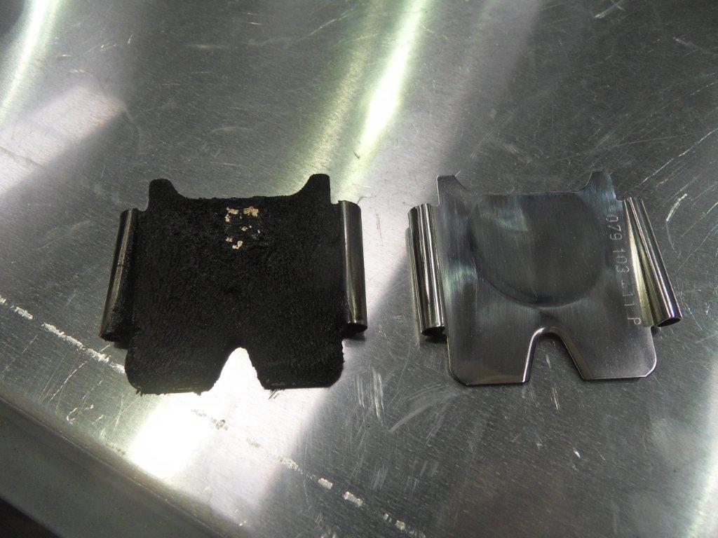

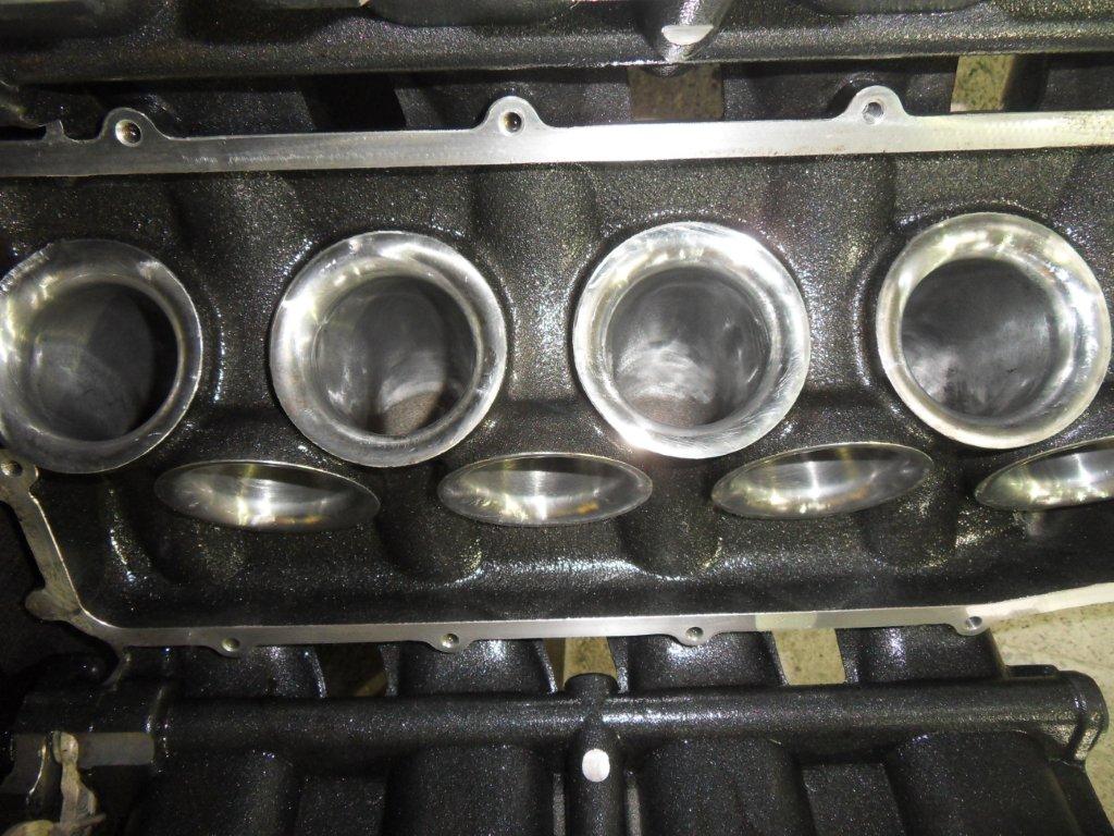

Got my car back from MRC this morning post a full carbon clean including an inlet manifold clean, port and polish.
I was very pleased to hear from Doug that it was producing 425.4ps vs 398.3ps pre clean a 27.3PS improvement.
It's booked in on Weds at Revo for a revised map to take advantage of the carbon clean and with MRC for another dyno run on Friday.
Here are the pre and post plots and some of the photos that MRC took, the carbon build up was shocking !

I see those are the revised tumble flaps, earlier ones never had the dimples in. FYI
