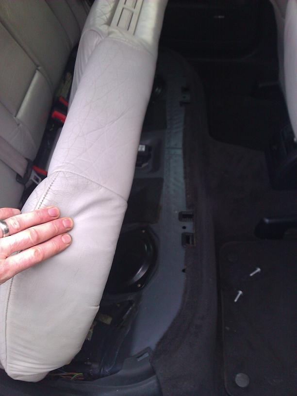

Remove the seat base.
Pull up at each corner and then pull forward from the middle and upwards... job done if you have heated seats you may want to disconnect them to make more room.

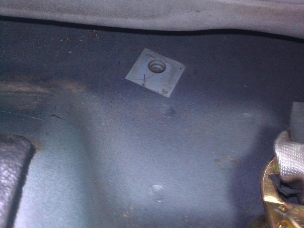

Locate your Isofix mounting holes, i used a torch to find the painted over stickers, peel them off.
You will see there are 2.

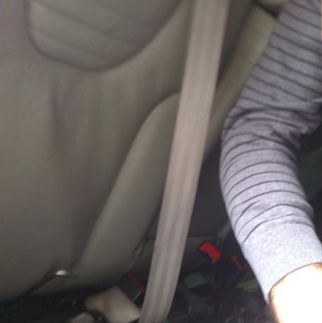

To make it easier to tighten the bolts its now time to get low, with my torch and torque allen key, i pulled the seat uprights down on top of me slightly, this gives you more access to make it easier to tighten the bolts..
If you are using a Allen key type and you turn the allen key BE CAREFUL not to scratch the seat backs with the bent end as you turn it.
Repeat with other bolt..
