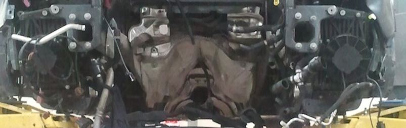

From my experience, the C5 RS6 does suffer from significant heat soak and loss of power when standing still or in slow traffic.
I found on a chassis dyno that on runs 10 minutes apart, the whp dropped by 20 whp on second run due to increased intake air temperature. This was due to the dyno fan being centrally mounted keeping the main front radiator relatively cooled, but not the intercoolers as not blowing enough air through the intercooler vents to the side mounted Wagner intercoolers (no fog lights).
Audi have found the solution to the C5 RS6 heat soak and incorporated this into the C6 RS6. If you look at the front of a C6 the intake vents are larger than for the C5. I believe the intercoolers may also be a little larger in area.
More importantly, I believe the solution to preventing heat soak at times of no or very little airflow (idling or in slow moving trafffic)- is the very large circular intake fan mounted on the front of each intercooler.
These run on start up and give the C6 its characteristic 747 whine. On the same chassis dyno as the C5, multiple runs of the C6 showed no loss of rwhp.
It would appear logical to prevent heat soak from starting as then gets harder to remove it.
Same on the drag strip with the C6. No heat soak and same quarter mile times, even with ambient temp of 39C on consecutive runs 10 minutes apart.
If there is room in the C5, then kenlowe or similar type fans mounted in similar way in front of the C5 intercoolers as per the C6 could be a better solution than modified air boxes for no or slow air speed movement.A bit more power drain for the electrics- needs to be checked.
Once you are moving, then assume sufficent air flow to reduce/remove heat soak. Water-meth injection is obvious alternative solution, but you need to keep filling up fluids. Extra fans would appear to be less intrusive to manifolds, etc.
water- meth injection is another soultion but need to mess with manifolds and fluid fill up. Extra fans should be less intrusive.
Just my two cents worth.
john

I wonder if there is anyway of adapting these to fit under the bonnet of an RS6. (never seen under a bonnet of an RS6 before I get shot down in flames.)
Many old muscle cars had open carbs above the V8 or filters
I know the above photo is not running any forced induction but surely still suffer from heat soak.

Fan's covering the intercoolers? Sulrely they will block as much air as they will produce when you are travelling at speed, no? I understand that at staionary or very slow speeds they will be great but looking at the C6 above the actual motor covers upto 30% of the coolers!
