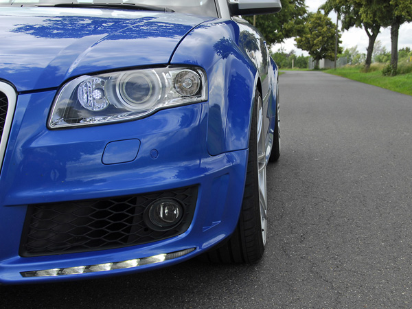

Here are some pics of S5 9J20 ET 29 with 10mm distance each wheel, H&R Springs -20mm, 265/30 R 20 ContiSportContact 3
This combination works very well!
Best regards Bernd
