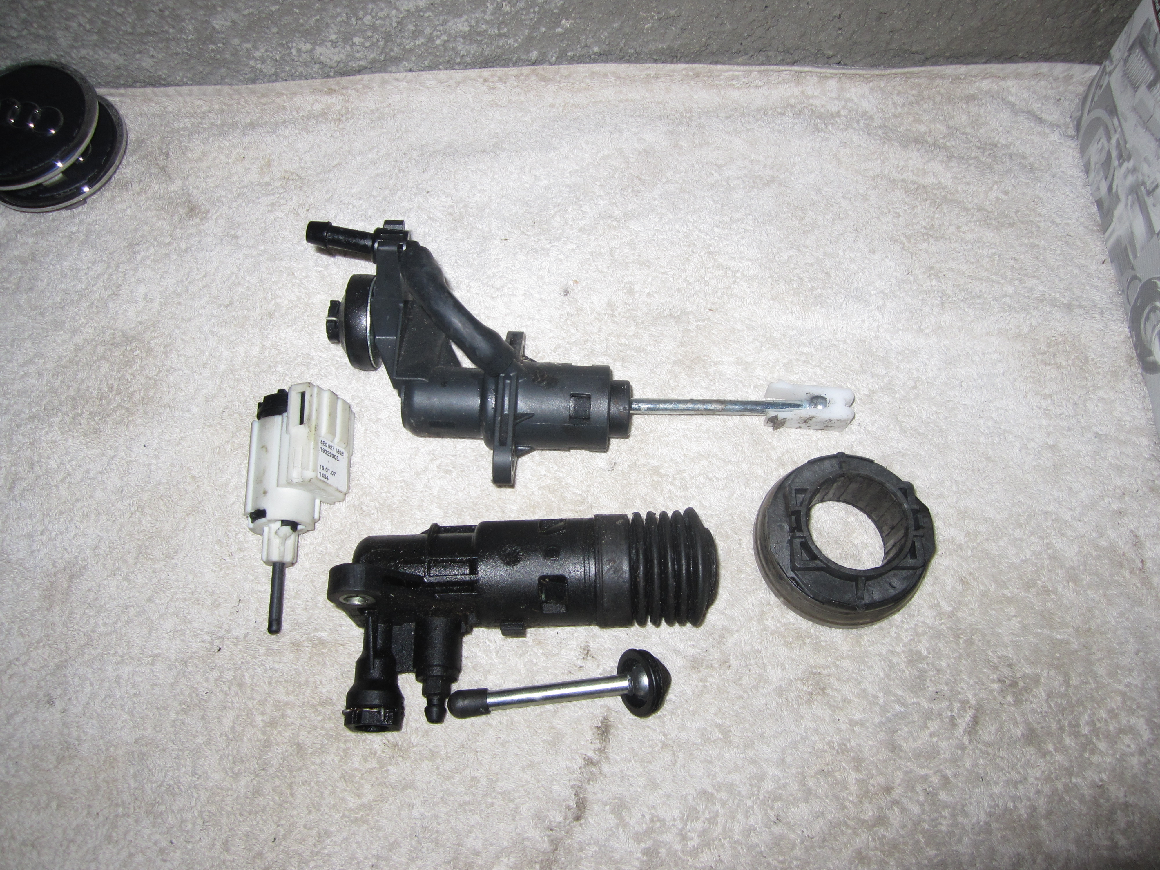

Thought I'd give an update on the above topic:
Finally got the car back from the French main dealer, 2 weeks they had it which didn't help my paranoia as i was working away and the wife was dealing with it in my absence.
So first of all, the car seems to be driving perfect, no sign of any gear selection or clutch issues, as expected.
I asked them to look at all the small issues first before taking the gearbox out, i.e. clutch return pipe, bleed the clutch, stuff like that, which they said they did with no problems found.
So it was out with the gearbox £££££ !!! I'm still not sure what the main issue was, with my broken French and the dealers broken English, but they replaced a few bits related to the clutch / gearbox, see photo attached. I also had them replace the clutch return pipe, pressure plate, friction plate, pressure plate bolts and the release bearing as a precautionary measure. I was also going to get them to replace the flywheel at the same time but after inspection they said it was in good condition and didn't need to be done, I hope it doesn't come back to haunt me!!
If anyone can identify the parts in the photo It would be much appreciated, i know the one is the release bearing, so just the other stuff.
So I'm happy the car is going well although my wallet is considerably lighter!! anyway, no one ever said RS ownership was inexpensive!!

A mechanic told me several years ago when I was having problems with another car that if I had trouble selecting the gears only with the engine running it was a clutch issue but if it did the same when he engine was off too it was a gearbox issue.
Re: Difficulty getting into gear??? Update!!!!
One looks like a solenoid (reverse gear lockout?) and the ring looks like the part Arthur points to as the source of the sticking clutch pedal issue.

Master and slave cylinders

+ the switch on the left is a clutch switchDal wrote:Master and slave cylinders

Its a long story, but yeah the engine has only done around 28k as it was replaced by Audi at around 17k due to a fault that they couldn't pinpoint, so I'm not sure whether the clutch would have been replaced then, I wouldn't have thought so, therefore the clutch has done 48k like the rest of the car has.
But your correct I haven't had much luck so far, although my previous front disc and pad replacement fiasco was my own doing, as I wanted to do it myself and it turned into a nightmare!!
The car is all back together now and its driving great, who only knows for how long though!
As for fuel consumption... it is what it is and I knew what the score was before I bought one so it doesn't come as a shock, I still drive it as it should be driven up and down the valley and wouldn't have it any other way!!

Cheers for the identification on the parts too folks!!!
