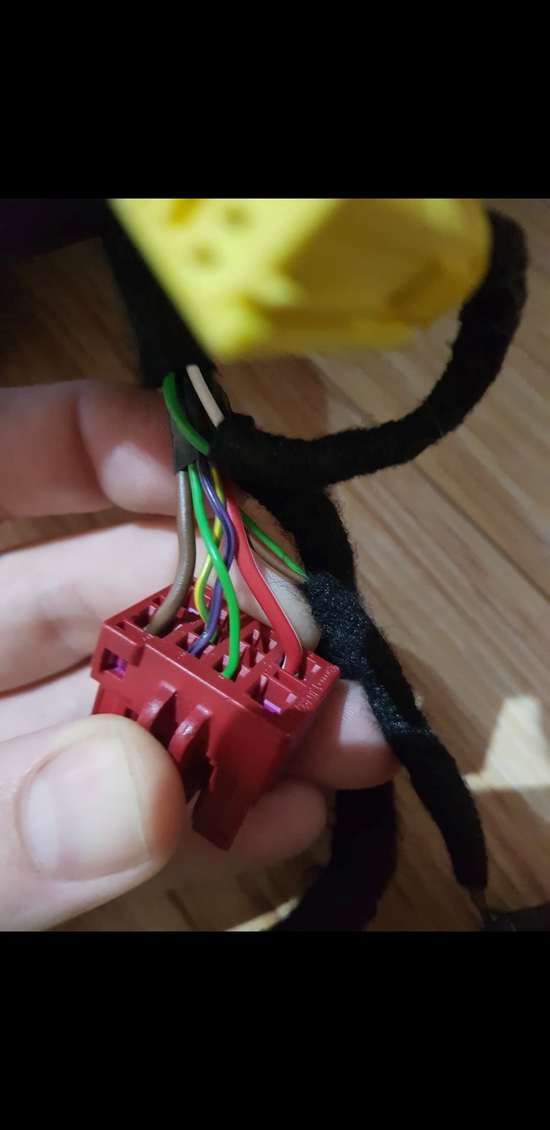

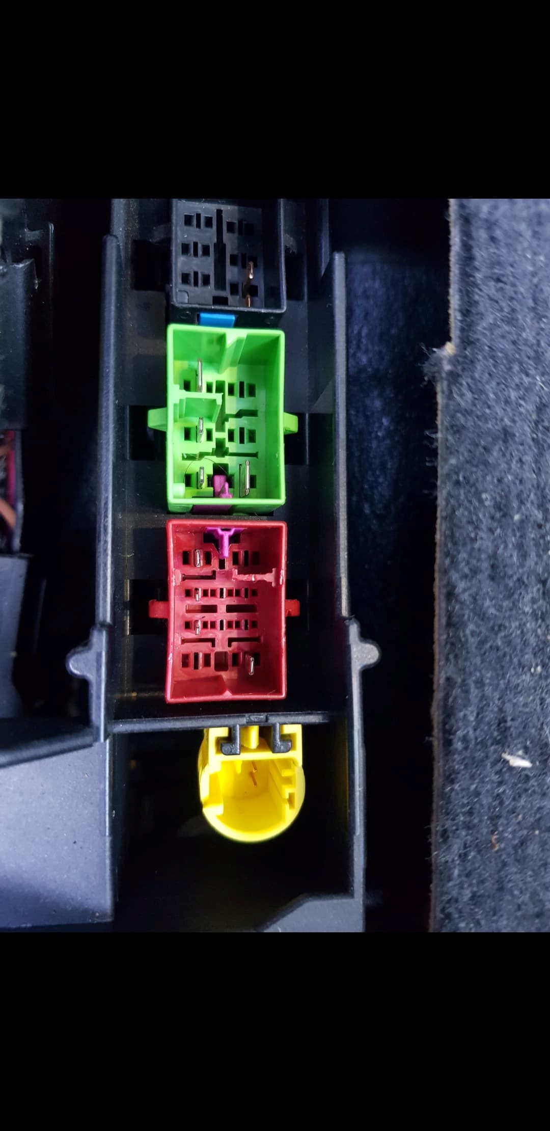

So, you'll see when you put your new seats in - the red connector in the floor of the drivers side is missing 4 pins (3 of these are needed for the sport button to inflate the bolsters). Here is a picture of a car with comfort seats, and one with buckets.
Here is the connector on your new bucket seat (drivers side). Red/white wire is 12V+, Brown is ground, and the other 3 are for the sport button function (and also diagnostics).
So to the important bit.
These 3 wires that need to be put in are basically connecting those 3 wires on your seat (green, green/yellow, purple/black), to different wiring harnesses under the dash. NOTE: All wires/locations you will tapping into already exist. This is not like most retrofits where you are inserting pins into un-used locations on plugs. So 2 of the wires are being spliced onto wires that are on the blue 32 pin connector going into the back of the dash, and the other wire is spliced into a wire on the diagnostic plug. See below for specific instructions and wiring diagrams:

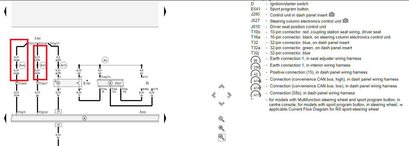

FYI - T10o is the red plug/connection, and the number after it is the pin number of that plug. Once you have a good look at the wiring diagrams you'll understand what is going on.
1. The Purple/black wire (T10o/6) needs to be connected to Pin 17 on the Blue connector going into the back of the dash/dials (T32/17). From memory this is a green/orange wire. Hence you use a splice terminal to connect your new wire to this, ie joining up the purple/black wire to the green/orange wire.
2. The Green wire (T10o/7) needs to be connected to Pin 18 on the same blue connector (T32/18). From memory, this is a green/brown wire.
I connected both of these right next to the blue connector, and taped them up to make it look nice.
By the way, you will have to unplug the blue connector to do this, as it is on the bottom of the connector where it tells you which pin is which.
3. The Green/Yellow Wire (T10o/9) needs to be connected to pin 15 on the OBD diagnostic plug (T16/15) - basically just splice into the wire that is already going into pin 15 on the obd plug.
Here are the two wiring diagrams that are relevant for this, I have circled the important bits!

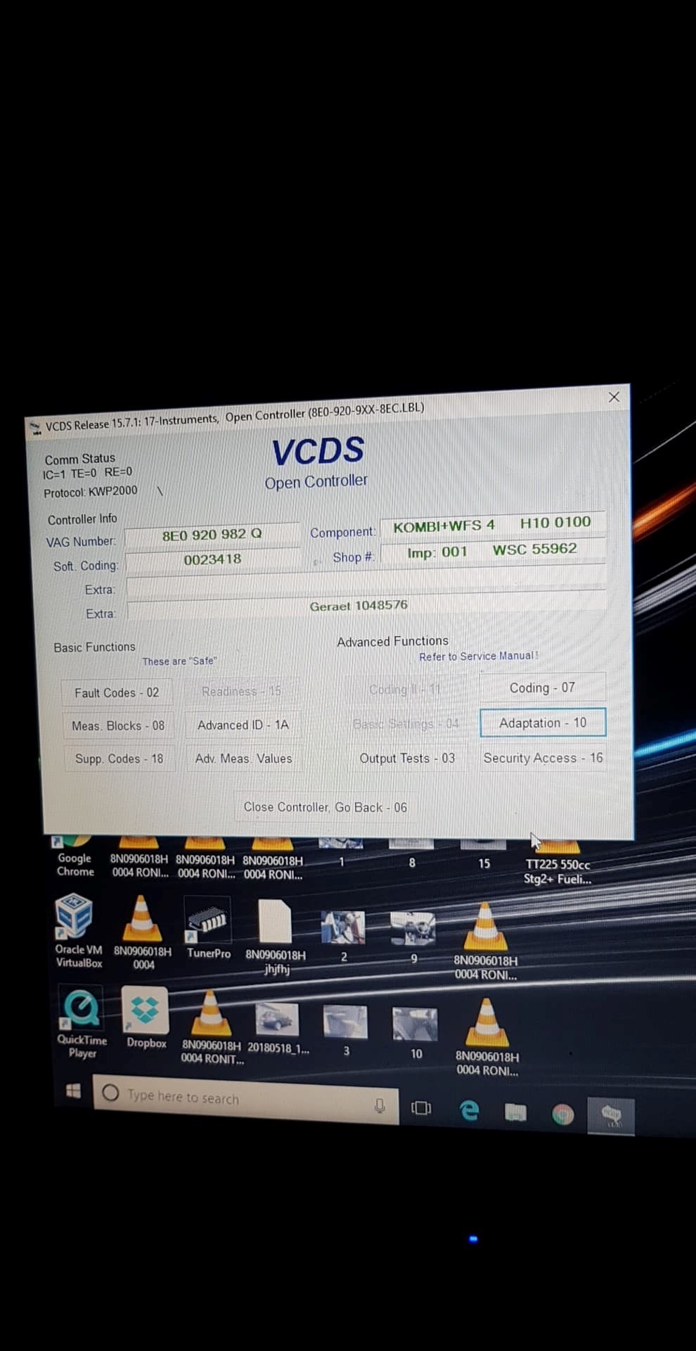

Turn the ignition and get VCDS out.
Go to module 17-instruments, then go to 10-Adaption. Another screen will pop up. In the dropdown menu, go to additional features.
Once in there, you will have a certain number in the box. Add 2 to this number, and enter it in.
Mine was 31300, and I made it 31302 and saved that. This change turns the sport seat option on in the DIS menu.

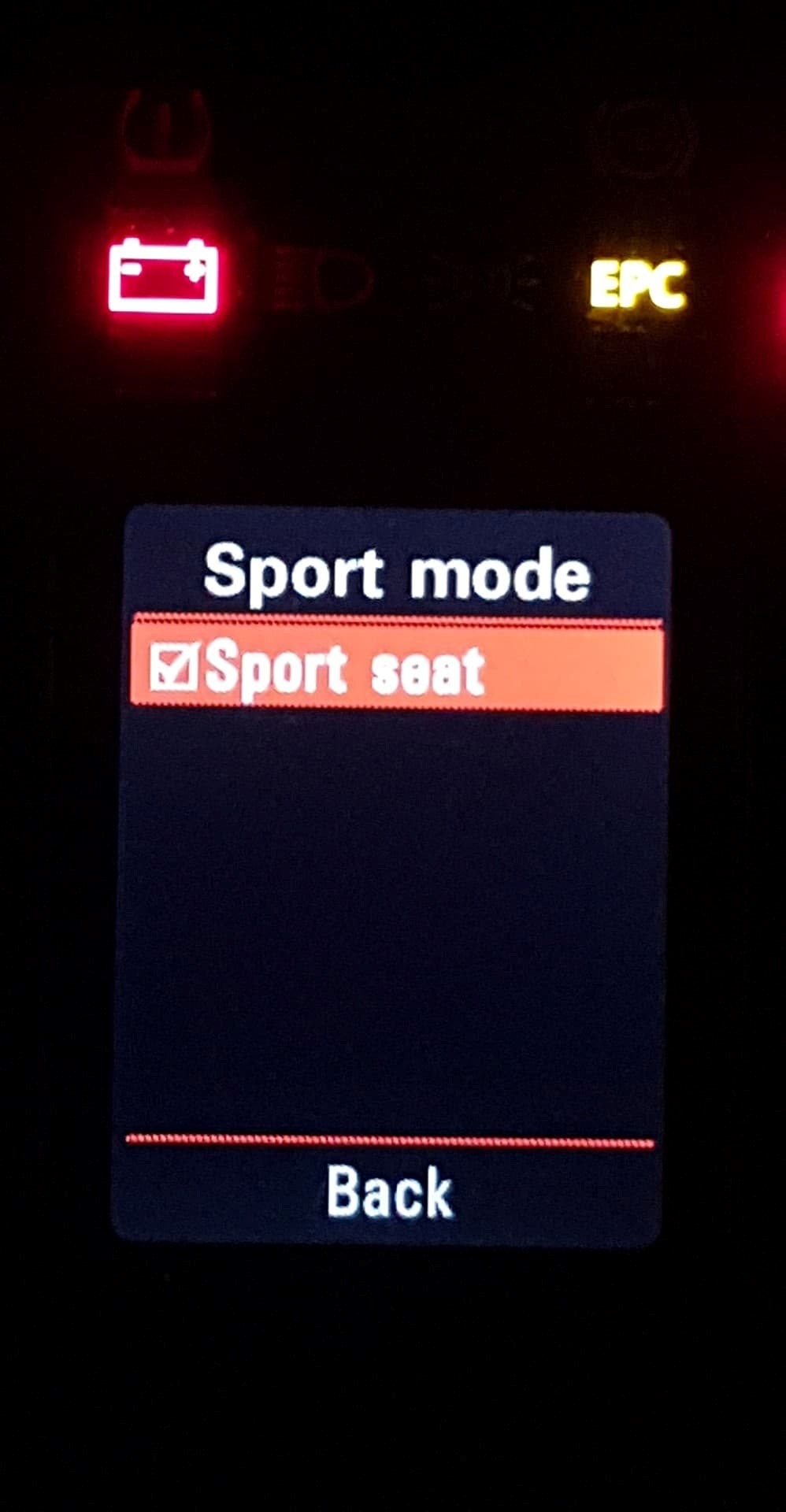

Once that is done, use your buttons on your steering wheel to go through the options on the DIS. There should now be one at the end saying sport seats - check that option on.
VOILA - you should now have working bolsters on the sport button!
