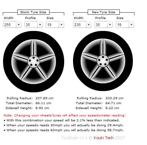

this is my 255 8.5J v 235 8J (as a potential winter tyre)
207.69 v 203.29
not to bad, i could live with that for a winter wheel

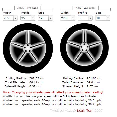

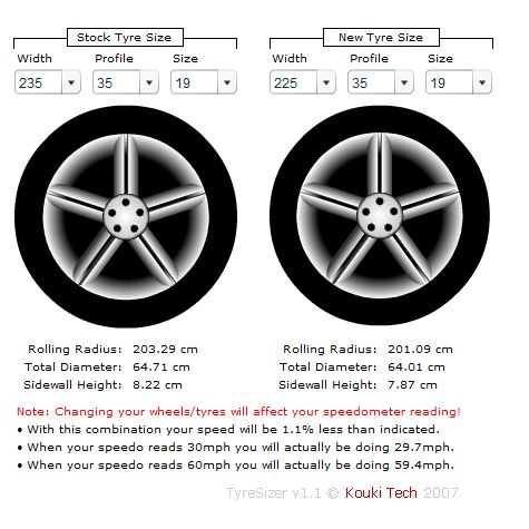

comparing 255 front to 225 rear and stock 235 front to 225 rear

255 tyres were put on the front because as it was seen that the grip offered over 235 was signnificant enough to warrant it. Much like us RS4 owners will put on 275/30 rather than 255/35 and have seen better turn in grip, part of the understeeer elminaton solution. RS3's are Haldex driven so predominantly front wheel drve so what grip the rears have should not have an adverse effect on the fronts i.e. put a wider tyre on the rear = more grip and the back = does not induce understeer. As for rollng radius, the speedo measures off the front axle IIRC and if the difference is <5% it shouldn't damage the Haldex.

Big, but for the RS3 it's for the better. There even is a wheel upgrade package with such configuration.
Thats too big a difference in rolling diameter IMHO
I note that the Audi upgrade package has 255/30/19 tyres on the front and not 35 profiles, presumably to keep the rolling circumferences similar front to rear.
