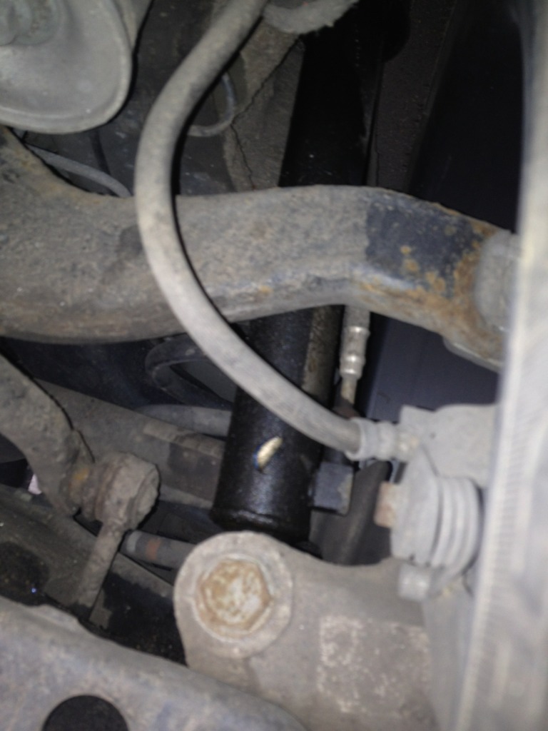

So today I had both my shocks replaced on the front at Audi Stafford...due to oil misting on both and knocking from the rear and front of the car.
Drove it back on the m6 and seemed 50% better than it was but still a little unstable under slow bumppy roads.
Jumped out the car to investgate and the car seems a little high at the wheel arches all round but more so at the front???
Does this mean they have put the wrong pressure in ? If so does anyone knw the correct pressure so I can question them first thing in the morning?
Also should they have replaced the DRC Valve and could this this cause instability ??? :bash:
Thanks in advance :bash:
