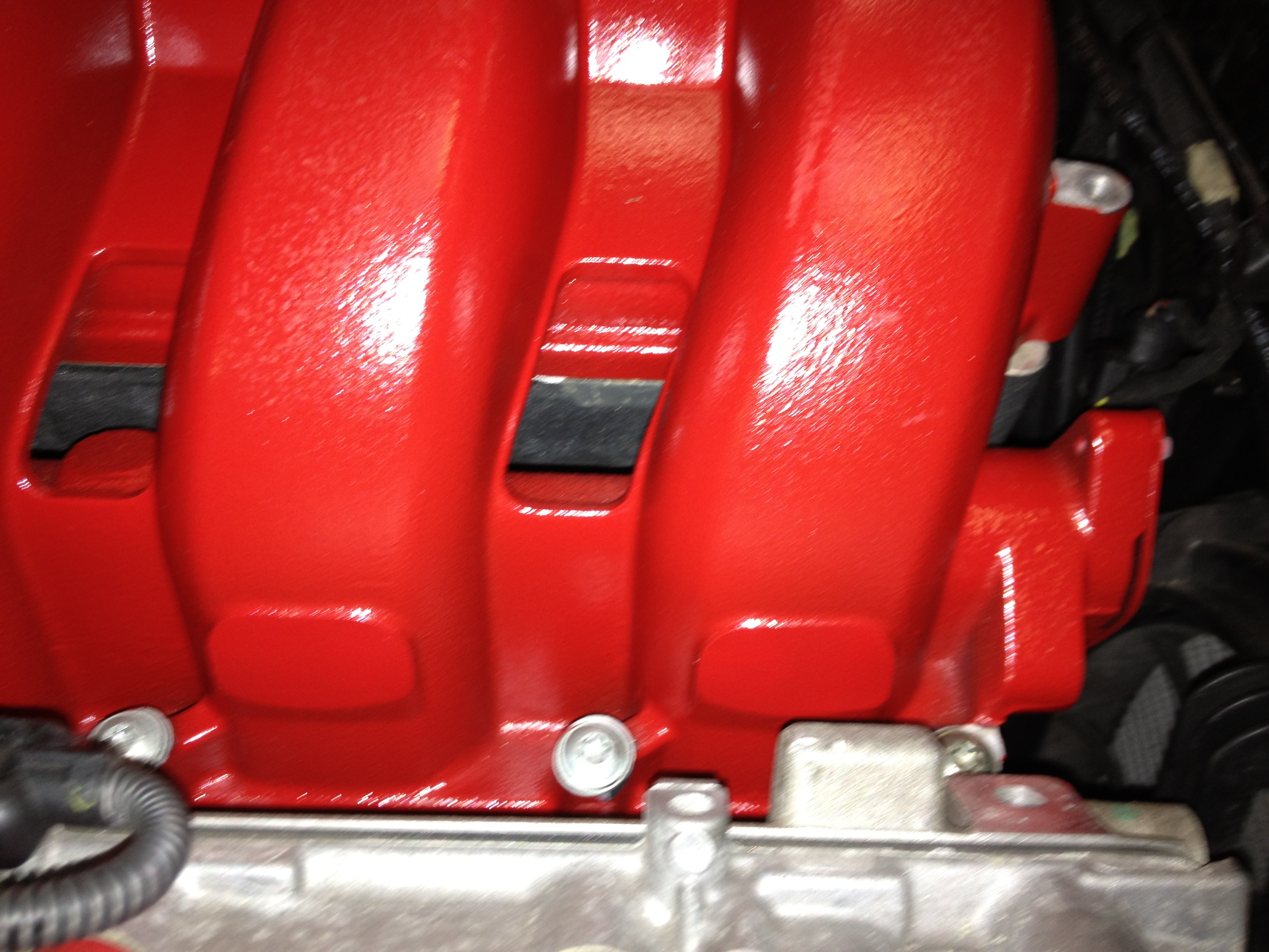

Yes they have welded the holes. Why is aluminium a problem to weld? I wil post pics later. It's all done now jus needs a map tweak. Who is going to map yours? I will post pics later.

Re: Inlet manifold flaps removal question
Heres some pics

Nice job Eashan

That does look neat and completely removes any risk of the engine ingesting a core plug. I'd be worried however that the heat from welding could distort the manifold's mounting face, making it impossible to get an airtight seal.
