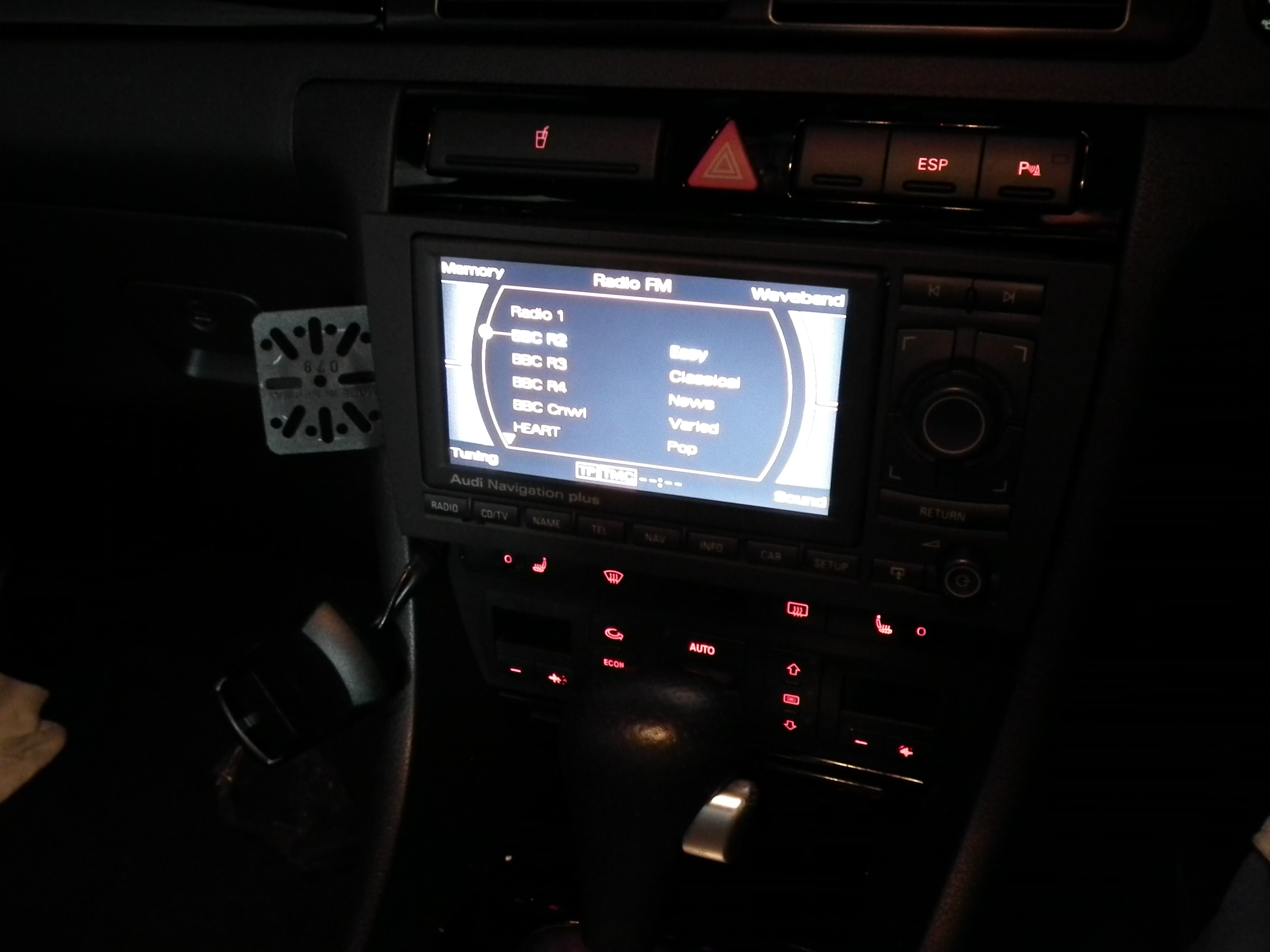

just fitted my new RNS-E sat nav using the plug and plag adapter cable however it is not lighting up when i turn on the lights has any one else fitted this newer sat nav and had the same probs ?
P.S. Also having probs pushing the satnav unit back in place as theres so many wires in the back now with the plug and play cable
as you can see rest of dash is lit but not on the sat nav

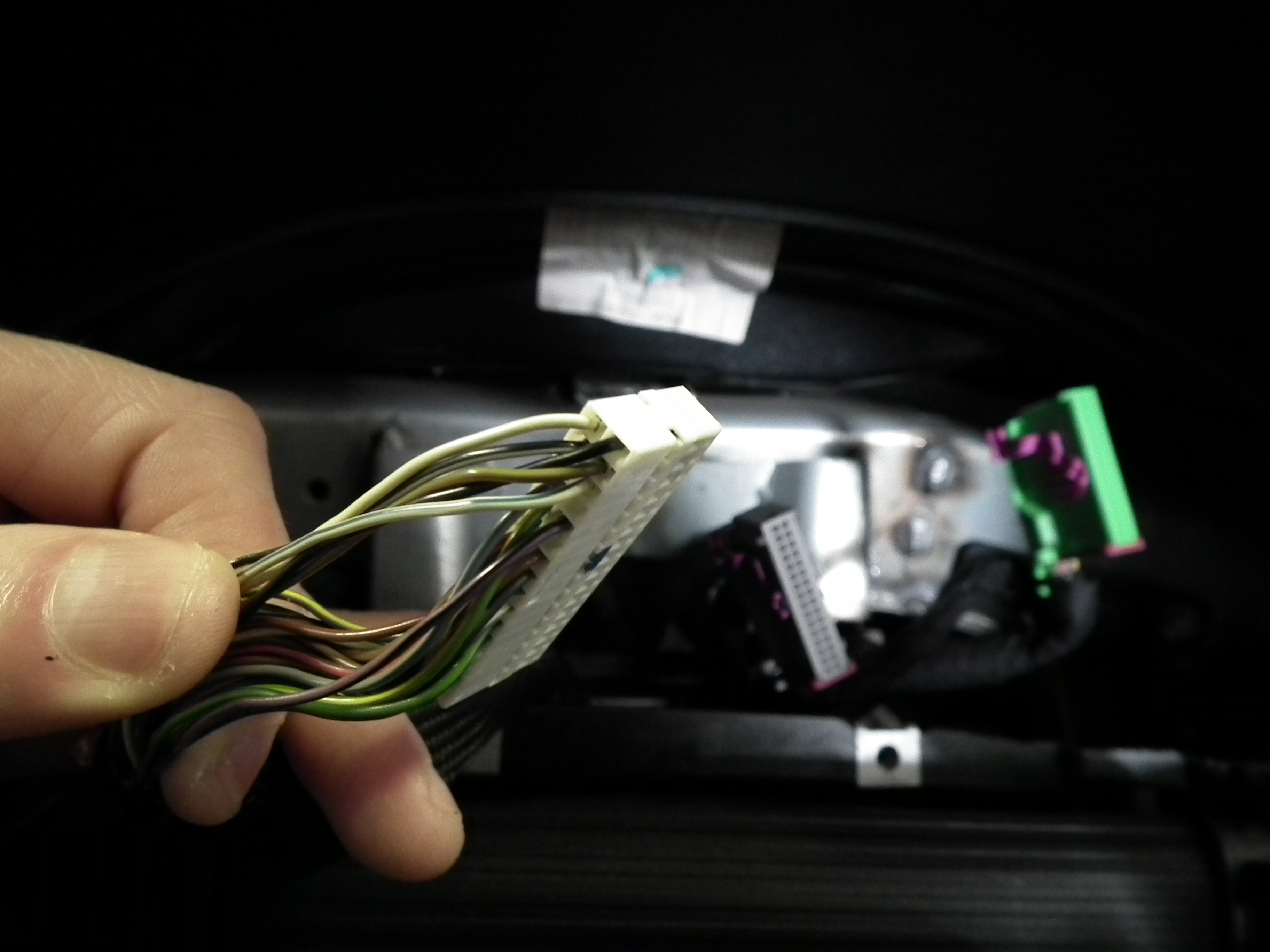

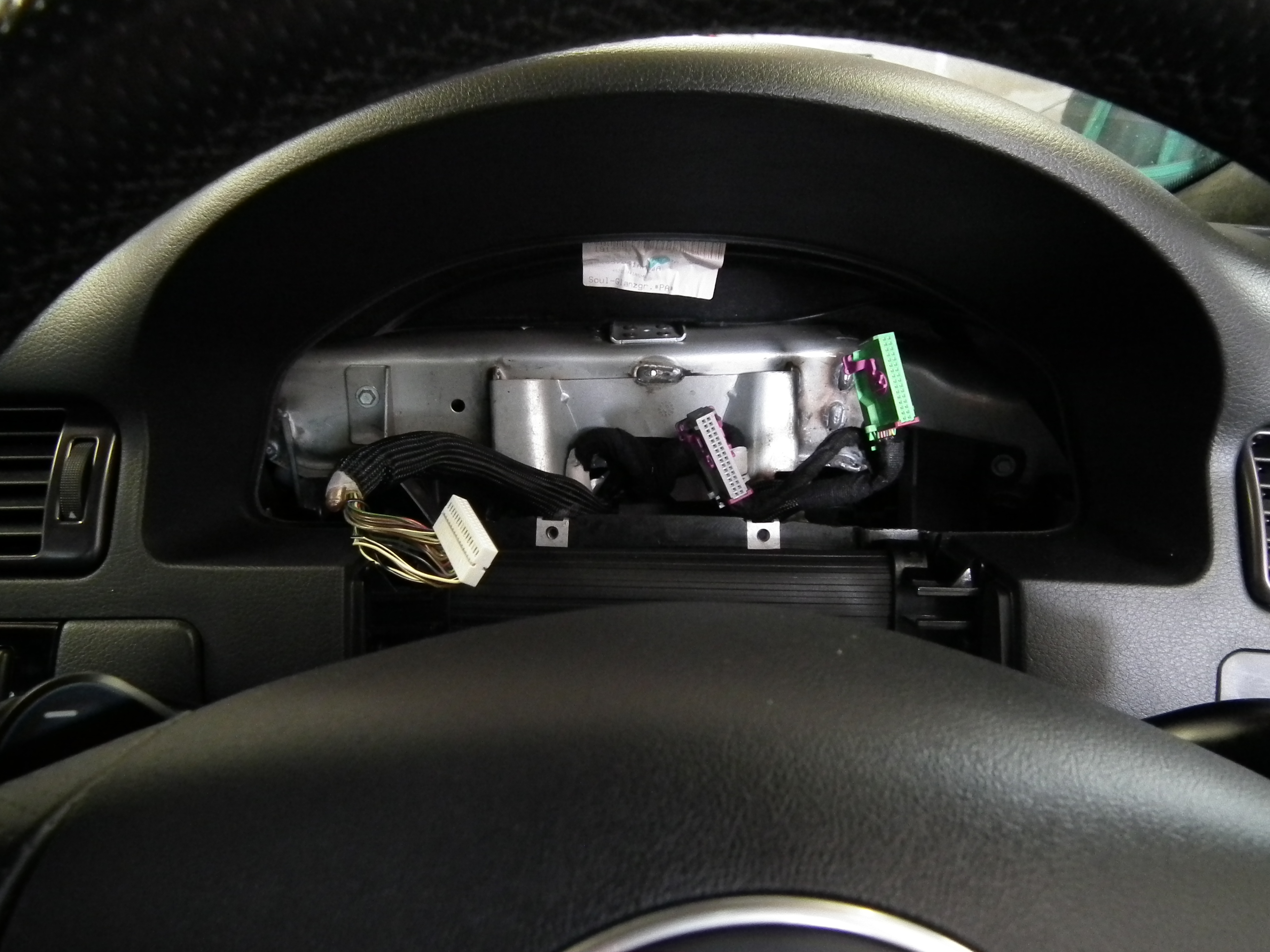

once I tap into the blue and white wire behind the Speedo and run a cable where does this wire go on the adapter plug, does it go to can h or can l as im not clear about this atm and don’t want to damage anything or blow it up
have added some pics of the blue and white wire im tapping into and a picture of the top of the new RNS-E sat nav unit with the wirering diagram
with the speedo cluster removed
cable im going to tap into is the blue and white pin 3
the top of RNS-E sat nav the wirering diagram

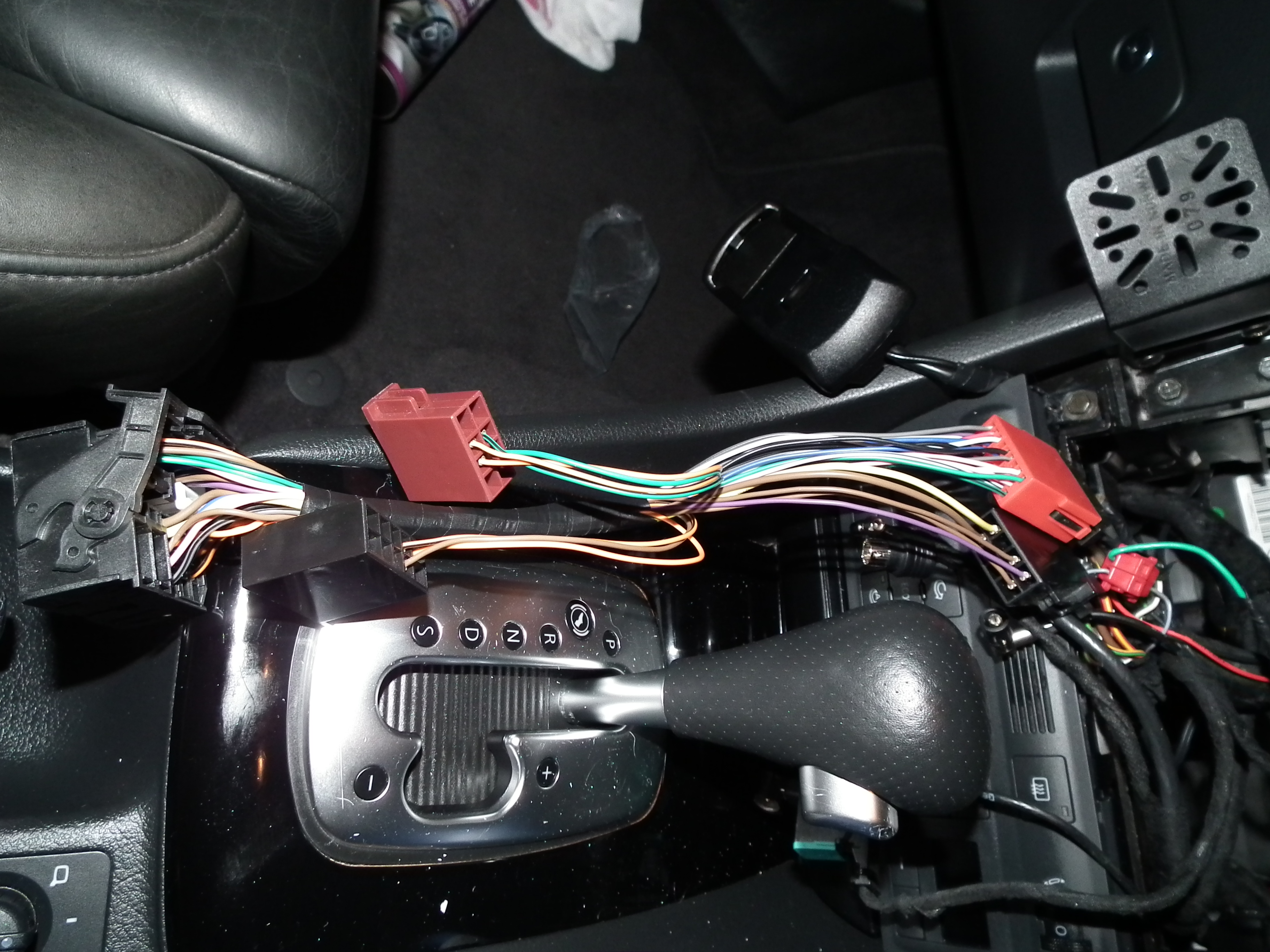

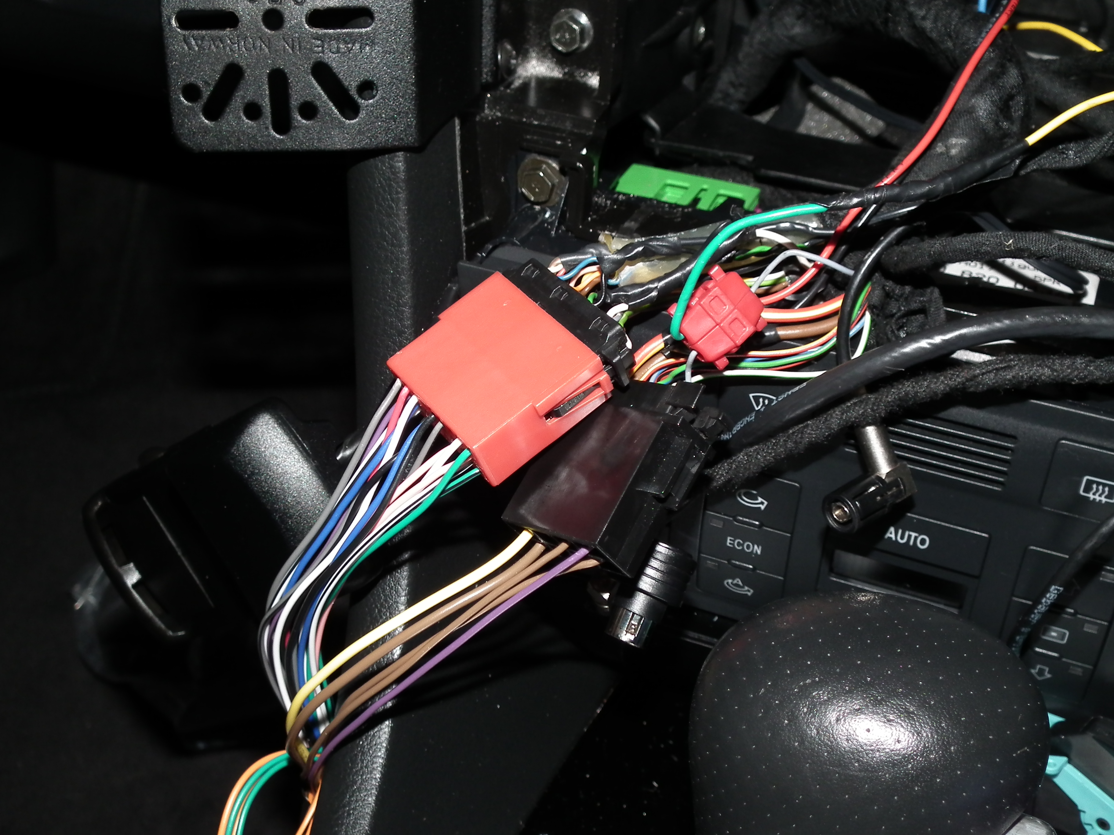

ok how can i do this and what do i need to do as ive just carried out this connection beeteen the white and blue wire and taken it to pin no. 1 on the 8 pin connector and theres no change the lights are still not working on the sat nav and its still not displaying the radiio station in the speedo ?

Ok looks like they are hard to find i need to find them both i think and connect them to the H/L can on my new RNS-E, have just tried this with the 26 pin plug, This is the one thats not needed with the new RNS-E so i think i need a true can connection pics to follow in a bit ?
